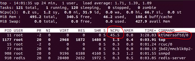

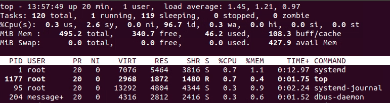

    to followup on this, testing with the BeagleBoneBlack, it shows this behavior:
    Before connecting the USB Gadget cable, the CPU is low
    After connecting the USB Gadget cable, after the g_multi driver starts.
    So the USB Gadget driver is doing something, that is consuming huge amounts of CPU. Do we have a fix for that?
