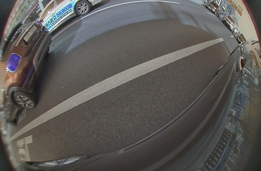

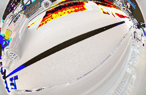

    Observation:
    By following the above method and providing the "inQuantfactor=128"
    a) Please find the Import log for your reference

    b) Output of layer 0( Data Layer)
    c) Output of Layer 1(Batch Norm)

  • Dear Sir,
    As per your suggestion, we have used the "inQuantfactor" equals to 1.
    The output generated by BatchNorm layer is given below:
    And also find the Normalized image obtained in Pytorch below:
    As we observed that two images are different and hence our output of the model is also incorrect.
    What could be the possible reason for this behaviour.
    Kindly help us in this.
    Thanks and Regards,
    Vyom Mishra

  • Dear Sir,
    We removed the commas from the parameter "inMean"
    but still facing a similar issue,
    please find the image below
    Please find the Import config used

  • Dear Sir,
    Thanks for the Suggestion.
    We have experimented the same on our side and got the below output from BatchNorm, which is still not matching with Pytorch output.
    we suspect there is swapping of channels (Blue and Red).
    Background: Pytorch model is trained with BGR input, So we provided BGR input to the import tool and "inDataFormat = 0"i.e., BGR_Planar in the config file.

  • Hi Vyom Mishra,
    How did you generate the image that you have shared here?
    Can you share the simail image for input layer as well
  • Dear Sir,
    a) we have read the float bin file for that layer using python, reshaped it to the respective dimension.
        Used "cv2normalize" method to normalize the image from 0-255 and then wrote an image using "cv2.imwrite"
    b) Please find the output of the data layer
    Thanks and Regards,
    Vyom Mishra
