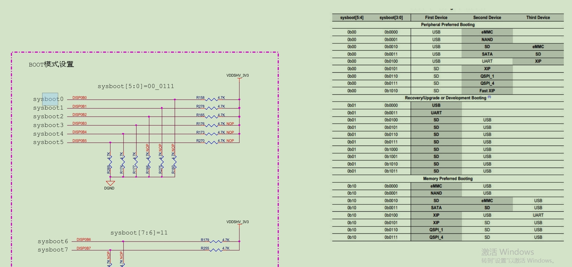

    The device power on when inserting SD card, our understanding is as follows:The hardware configuration mode is SD - > QSPI. First, the first level boot program of CPU will detect SD card. If the SD card does not have an active partition , it start from QSPI.
    Based on the above understanding, in the SD card without active partition, Device startup will skip SD card and Boot from QSPI, but the current phenomenon is as follows:The device power on when inserting SD card.Serial port has no output.  then Wait 3 to 5 minutes, and Successfully started from SPI. We expect to launch directly from QSPI,Please help to analyze the reason.
    boot-mode.jpg is the hardware configuration screenshot for boot mode

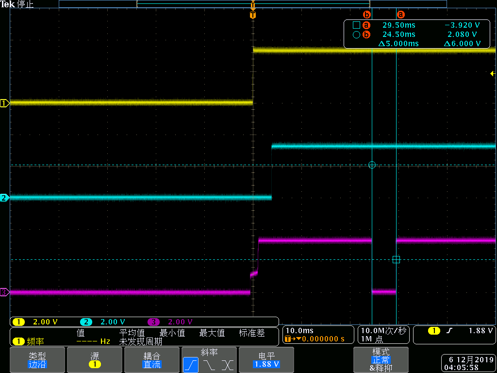

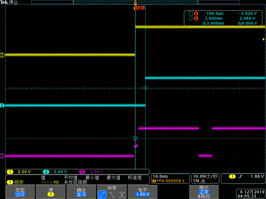

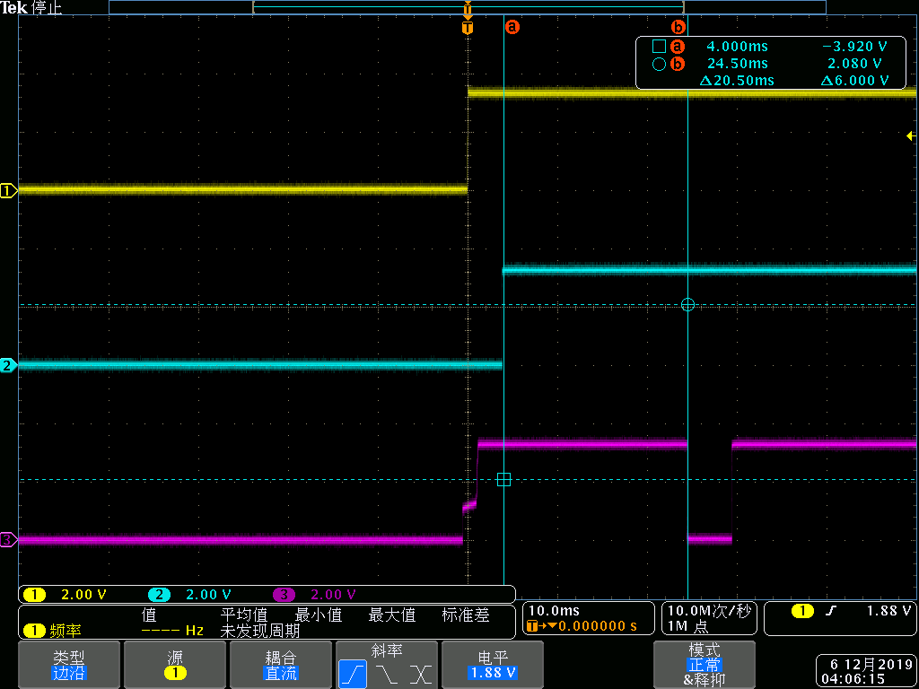

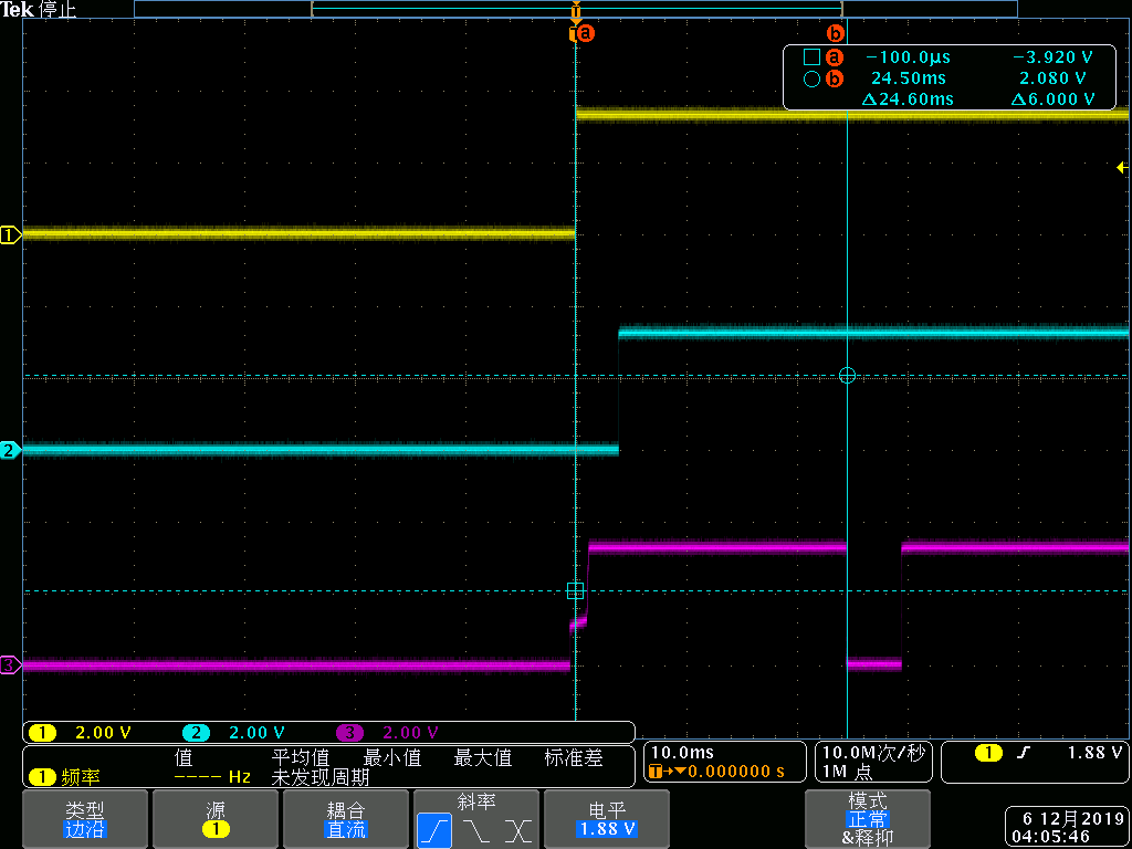

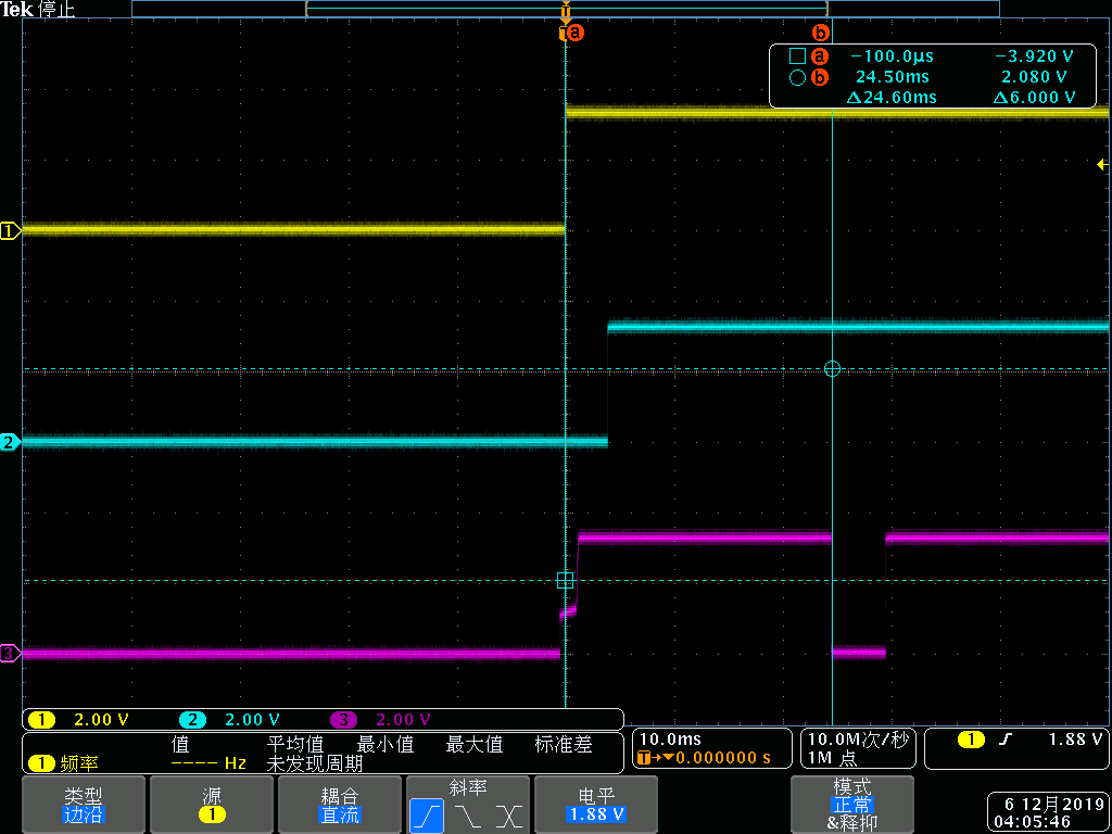

        See the attachment for the current power on sequence:
    Yellow: SOC last power supply
    Blue: hardware reset ~ porz
    Purple: soft reset ~ reset

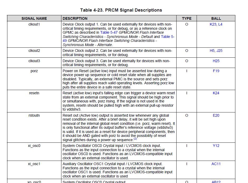

  •  Hi Liu Wang:
    Can you help us confirm purple line is TDA2E-17 pin K24: resetn or pin E20: rstoutn.
    I want to insure it is hardware warm reset been trigger at second time.
    Best Regards!
    Han Tao
  • Hi:
    The  purple line is pin K24: resetn.
    Best Regards!

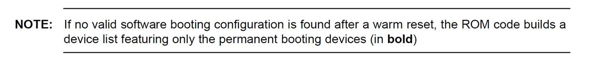

  • HI Guo Kuo:
    TRM descript the reason why resetn trigger jump SD card boot.
    you can find it at 32 chapter like below picture.
    Best Regards!
    Han Tao
