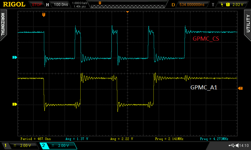

Below you can see the result of the code snippet shown above:
On the oscillogram we can see four separated read cycles through 16-bit data bus.

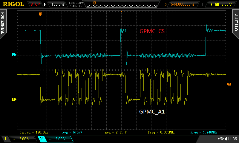

In mode READMULTIPLE the same code snippet give the following result on bus:
In this case we setup GPMC as follow:

On last picture we see that the address line a1 is not incrementing though the data read correctly but more slowly than single read.
How can I read entire 4-words page? Maybe setup of GPMC is wrong or incomplete?

  • Hi Andrei,
    I think you'll need to use DMA to read more than two 16-bit words during a page/burst read cycle.
    What we are seeing in the second capture is two 2-word page reads. When the CPU is used to read a page/burst, it can only get 32-bits of data in each cycle (even when you use the 64-bit data type). I've never gotten it to give more than that, - I tried many data types, assembly code, etc. but only had luck with DMA for > 32-bits in a single read cycle.

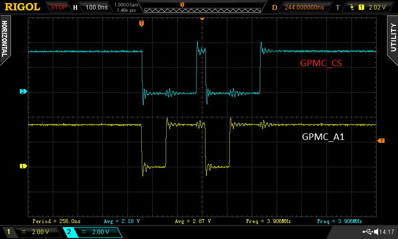

    Try to setup a 16-word DMA access from the base address of the page and you should see all 16 words sent in a single read cycle (16 words during 1 CS low pulse).
    The address bus and nBE[1-0] are updated for each beat of an asynchronous page-read access.

  • Hi, Mark,
    I did what you said and all is ok. Below you can find the setup for 16-word page mode. On picture we see the read operation of 64-bytes using EDMA3 module. There are two 16-word read cycles below.
