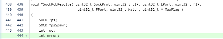

    A bug fix in NDK v3. 50.00+ may need as well to address the issue after SoTcpAccept() is updated:
    https://sir.ext.ti.com/jira/browse/EXT_EP-9040
    NDK_socket/accept needs to honor config parameter maxSockFileDesc.
    In order to do this NDK_accept needs to be notified if there was an error creating a new accepted socket. This would also fix an issue where NDK_accept does not return NDK_ENOMEM when a socket could not be created because the NDK ran out of memory.
    src/ti/ndk/stack/sock/sockpcb.c:
    Garrett
