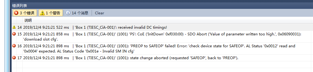

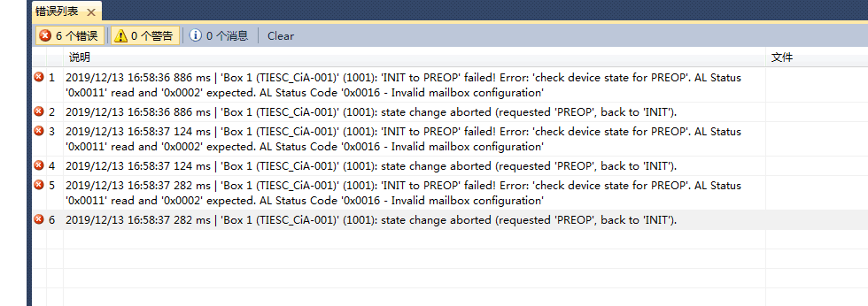

Hello everyone.I have to bother you again.
      Under the guidance of  PRU-ICSS Industrial Software for Sitara Processors, I can run two axes on CIA402 in DC mode.Now I want to run six axes.I have changed the xml file.I just add four slots and I did not change other thing.Then I changed "cia402appl.h" file.I changed the "MAX_AXES" and related structure variable.I can still run two axes well,but when I insert the third axis to slot3 ,TwinCAT3 show error messages as follow.So what should I do to finish this project.I just hope that there are references to help me change this project.
Thanks and forgive me for my terrible English!  cia402appl.h

           by comparing with the actual state (bits 1-3 (PREOP, SAFEOP, OP) of AL Status) */
/*ECATCHANGE_START(V5.12) COE3*/
        if (0 == (((UINT8) ((pEntry->ObjAccess & ACCESS_WRITE) >> 2)) & (nAlStatus & STATE_MASK) ))
/*ECATCHANGE_END(V5.12) COE3*/
            /* we don't have write access */
            if ( (pEntry->ObjAccess & ACCESS_WRITE) == 0 )
                /* it is a read only entry */
                return ABORTIDX_READ_ONLY_ENTRY;
            else
                /* we don't have write access in this state */
                return ABORTIDX_IN_THIS_STATE_DATA_CANNOT_BE_READ_OR_STORED;
        /* we use the standard write function */
#if COMPLETE_ACCESS_SUPPORTED
        for (i = subindex; i <= lastSubindex; i++)
#endif
            /* we have to copy the entry */
            if (i == 0)
                /*check if the value for subindex0 is valid */
                if(MAX_AXES < (UINT8) pData[0])
                    return ABORTIDX_VALUE_TOO_GREAT;
                sConfiguredModuleIdentList.u16SubIndex0 =  pData[0];
                /* we increment the destination pointer by 2 because the subindex 0 will be
                    transmitted as UINT16 for a complete access */
                pData++;
            else
                UINT32 CurValue = sConfiguredModuleIdentList.aEntries[(i-1)];
                UINT16 MBXMEM *pVarPtr = (UINT16 MBXMEM *) &sConfiguredModuleIdentList.aEntries[(i-1)];
#if BIG_ENDIAN_16BIT || BIG_ENDIAN_FORMAT
                pVarPtr[0] = SWAPWORD(pData[1]);
                pVarPtr[1] = SWAPWORD(pData[0]);
#else
                pVarPtr[0] = pData[0];
                pVarPtr[1] = pData[1];
#endif
                pData += 2;
                /*Check if valid value was written*/
                if((sConfiguredModuleIdentList.aEntries[(i-1)] != (UINT32)CSV_CSP_MODULE_ID)
                && (sConfiguredModuleIdentList.aEntries[(i-1)] != (UINT32)CSP_MODULE_ID)
                && (sConfiguredModuleIdentList.aEntries[(i-1)] != (UINT32)CSV_MODULE_ID)
                && (sConfiguredModuleIdentList.aEntries[(i-1)] != 0))
                    /*write previous value*/
                    sConfiguredModuleIdentList.aEntries[(i-1)] = CurValue;
                    /*reset subindex 0 (if required)*/
                    if(sConfiguredModuleIdentList.aEntries[(i-1)] != 0)
                        sConfiguredModuleIdentList.u16SubIndex0 = i;
                    else
                        /*current entry is 0 => set subindex0 value i-1*/
                        sConfiguredModuleIdentList.u16SubIndex0 = (i-1);
                    return ABORTIDX_VALUE_EXCEEDED;
        /*Update PDO assign objects and 0xF010 (Module Profile List)*/
        UINT8 cnt = 0;
        /*Update 0xF010.0 */
        sModuleProfileInfo.u16SubIndex0 = sConfiguredModuleIdentList.u16SubIndex0;
        /*Update PDO assign SI0*/
        sRxPDOassign.u16SubIndex0 = sConfiguredModuleIdentList.u16SubIndex0;
        sTxPDOassign.u16SubIndex0 = sConfiguredModuleIdentList.u16SubIndex0;
        for (cnt = 0 ; cnt < sConfiguredModuleIdentList.u16SubIndex0; cnt++)
            /*all Modules have the same profile number*/
            sModuleProfileInfo.aEntries[cnt] = DEVICE_PROFILE_TYPE;
            switch(sConfiguredModuleIdentList.aEntries[cnt])
                case CSV_CSP_MODULE_ID:
                    sRxPDOassign.aEntries[cnt] = (0x1600 +(0x10*cnt));
                    sTxPDOassign.aEntries[cnt] = (0x1A00 +(0x10*cnt));
                break;
                case CSP_MODULE_ID:
                    sRxPDOassign.aEntries[cnt] = (0x1601 +(0x10*cnt));
                    sTxPDOassign.aEntries[cnt] = (0x1A01 +(0x10*cnt));
                break;
                case CSV_MODULE_ID:
                    sRxPDOassign.aEntries[cnt] = (0x1602 +(0x10*cnt));
                    sTxPDOassign.aEntries[cnt] = (0x1A02 +(0x10*cnt));
                break;
                default:
                    sRxPDOassign.aEntries[cnt] = 0;
                    sTxPDOassign.aEntries[cnt] = 0;
                    sModuleProfileInfo.aEntries[cnt] = 0;
                break;
    return 0;

    Garrett
  • Part Number: AM3359
    Hi!
    Then I think the SM configuration is too small.I change the dafaultsize of SM0 and SM1 to 256 in xml file.And I changed the MAX_MBX_SIZE to 0x0200 in ecat_def.h.Then TwinCAT3 show error messages as follow.
    I checked the definition of the relevant error code in the code,and there too many errors will prompt this error code.I tried debugging to determine what went wrong ,but I  can not read the data from esc register,it always  shows 0.
    I want to know where I need to change to implement multi-axis,or is there any better way to debug(I am not familiar with CCS,maybe my debugging method is wrong).I use the emulator that comes with AM3359ICEV2 board.
    Thank you and forgive me for my terrible English!!
  • What is the DC cycle you configure? Do you see the error changes with a smaller DC cycle versus a larger value e.g. 4000us?
    Garrett
    Hello!
    As the title.I have change the project with the help of ETG,but TwinCAT3 still prompt the same error.I just want to complete this project before I die.
  • Have you tried to step into the function checkSmSettings() in ecatslv.c file to find out the root cause of '0x001e - invalid SM In cfg'?
    Garrett
