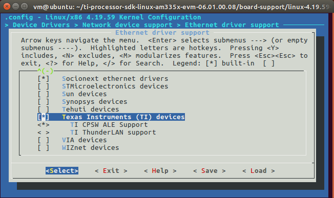

    Q1. The driver configuration at the URL you provided is different from the driver configuration at what I have verified.
           what should I do?
           make menuconfig
           Device Drivers > Network device support > Ethernet driver support

    The modifications you have made to the DTS file are correct. Though you should not have to touch the kernel configuration or rebuild the kernel to get switch support.
    Schuyler
