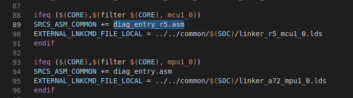

I found there is a board test demo in pdk/packages/ti/board/diag/mcan, but the demo only can be built for mpu1 and mcu1_0.
The test demo cannot run on mcu2_1?
How can I use this demo to test MCAN0~13?
I found something as shown below in the makefile of mcan_board_diag. I think the sdk lack of .asm and .lds files of mcu2_1, is it right?
Where can we get the files?

    1. The sample application for MCAN is available in PDK and it is available here: 'pdk\packages\ti\csl\example\mcan\mcanEvmLoopback'. This sample application runs on MCU1_0 as well as MCU2_1 and uses MCAN modules from MCU and MAIN domains.
    2. MCAN driver is available in PDK but it is not available in Linux. May I know the reason behind controlling MCAN through Linux? Can you please use PDK MCAN driver?
    3. You can use the MCAN sample application instead, as mentioned in the first point.
