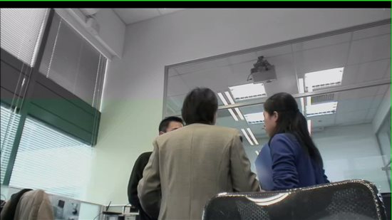

1.
I use TVP7002 to interface with PC graphics input (1280x720@60Hz). Everything is ok except there are some black lines in vertical direction.
The horizontal direction is ok, TVP7002 use embeded sync to interface with DM365 vpfe.
I try to change the VBLK start line and VBLK duration registers, but  it seems that VBLK start line can not be a negative value like TVP5150, because my analogue input source my not be very accurate, so there  are always black lines in the top of video.
I also try to ajust the VBLK duration register, but it does not any affect. that is value 0 is has the same result with value 250, why?

  • As a test can you try adjusting the AVID start and stop values in the TVP7002? Adjust both settings by the same amount. This will effectively shift the image in the output stream of the TVP7002. (Use embedded sync mode for this to work correctly)
    If you adjust the image position and the black lines do not move then the issue is with the processor settings. If the black lines move then the issue is with the source video signal not being aligned correctly with the video standard.

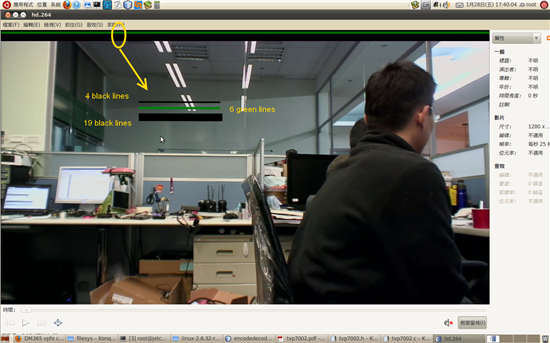

    we have the same problem with Spectrum Digital 365 EVM.
    use DVSDK4.0, encode sample to recode the video.
    a green line and 23 black lines in vertical.
    anyone got solution?

    Do you mean VBLK filed 0 Start Line Offset (address 44h)?
    We use TVP7002 to decode component input of 720p60 .
    Using DVSDK4.0 sample code: ./encode -y 3 -v 720p.264 -b 2000000
    This register did some help but there still some unwanted lines remained.
    It's original value 05h, the screen shot as below
    Change it's value form 05h to 00h.
    Are there some other registers should be modified?
    thanks!
    Nick
  • Hi Nick,
    Which sync method do you use? Embedded sync or sperator VSYNC, HSYNC?
    I solve this problem change the sync way from embedded to sperator VSYNC, HSYNC.
    When you use the embedded sync, the VBLK start line offset can not be a negtive value, so even you set this value to zero , there are still black line on the top.
    But another chip TVP5054 can set VBLK start line offset to a negtive value, please refer the related datasheet.
    If you use the embedded sync way, I suggest you change to sperator synchronous method.
    Xiaoguang
