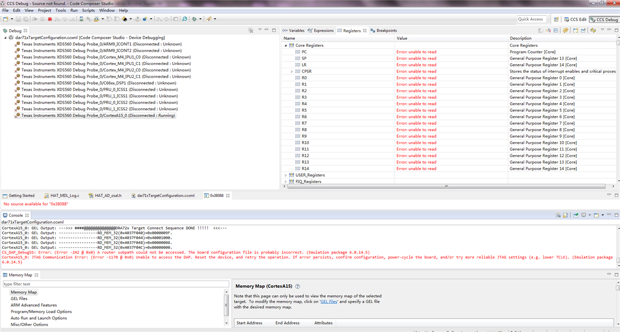

cold reset, but Soc cannot boot, console do not have any print!!!
So. I use CCS tools to debug it.
On data sheet 33.3.9 , Trace registers have been print, Is there any useful information?
