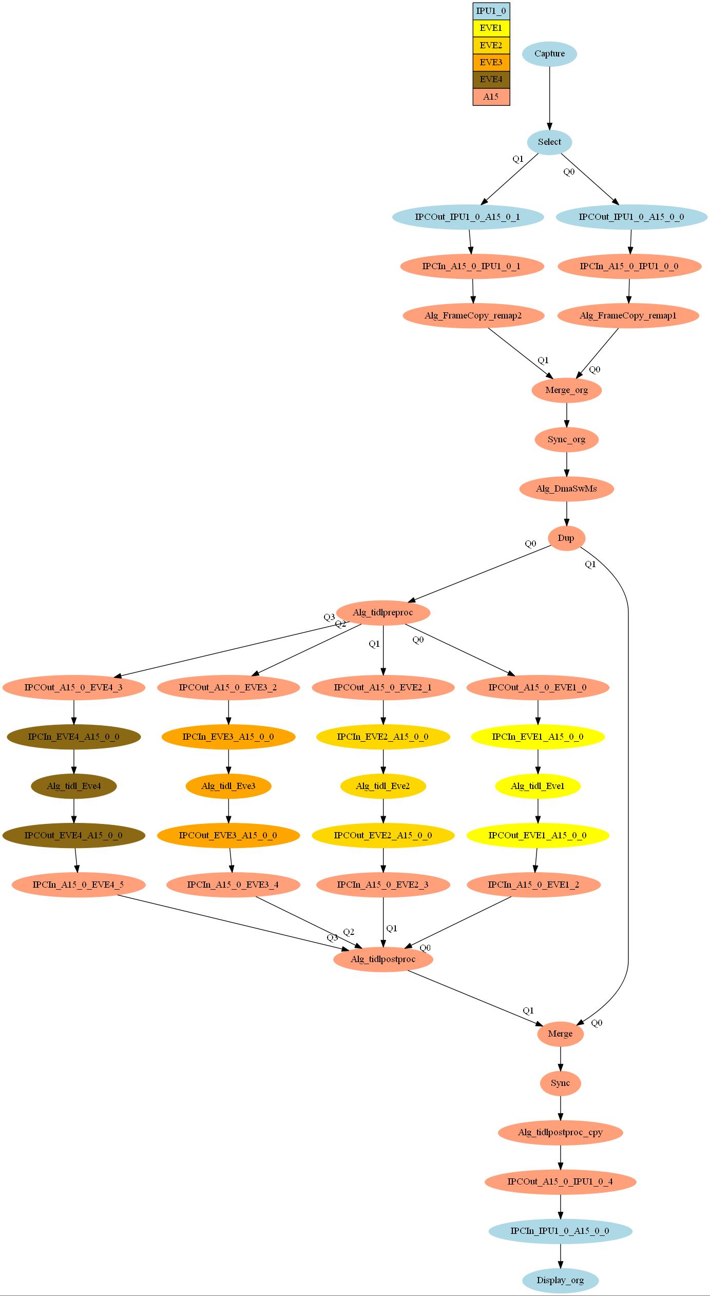

Due to the needs of product development, I use tda2x chip to realize the research and development of ADAS related products.
I need to embed the deep learning network (tidl) and send the results of network detection to other devices through DCan.
However, after I initialize DCan, tidl does not work without connecting any can devices.
When I access can devices (for example, can test), as long as the can connection line is interrupted, tidl will frequently encounter data update jamming.

  •  Hi Vivek Dhande,
    1)Open files in directory cfg.mk D:\PROCESSOR_SDK_VISION_03_04_00_00\vision_sdk\apps\configs\tda2xx_evm_bios_all
    2)# Enable below macro to enable DCAN integration into Vision SDK.
              DCAN_INCLUDE=yes
    3)Once the DCan is initialized, the chain main program is interrupted (shown as the freeze frame of the displayed screen)。
    connected to the can device (for example, can test), and the program runs normally (shown as the continuous update of the displayed screen).
    If the connection with the can device is disconnected, the chain main program is interrupted again.
    But the can communication is normal, and it can send and receive data
