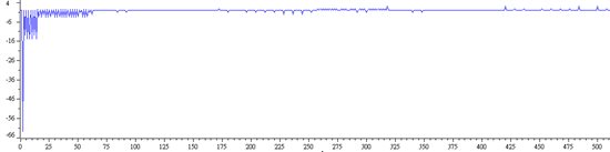

I am using c6416 dsp and CCS 4.2.1.0004  compiler. I want to use the DSPLIB (C64 DSPLIB for
SPRA884 version 1.0) to do FFT. Bottom is the example code. My problem is that the FFT output is
not correct especially around the DC. As you can see at the figure bellow. The output of the real
part should be zero but it is up to -63. I change the different input but the result that the noise
arround DC is still large (up to -120). Is this normal ? Thanks!

    for(i=0; i<NN; i++)
        xx[2*i] = x[2*i] = 32767./(2*NN) * (sin(2*PI*F2*i/NN)
                         + sin(2*PI*F1*i/NN) );
        xx[2*i+1] = x[2*i+1] = 0;

    DSP_fft16x16t(w, NN, x, y);
    diff = TIMER_getCount(hTimer) - start - overhead;

    printf("Check the result with the Graph menu.\n"
           "* Input\n"
           "Start address: xx\n"
  "Acquisition buffer size: 512\n"
           "Index increment: 2\n"
           "Display data size: 512\n"
           "DSP data type: 16-bit signed integer\n"
           "* Output\n"
           "Start address: y\n"
           "Acquisition buffer size: 1024\n"
           "Index increment: 1\n"
           "Display data size: 1024\n"
           "DSP data type: 16-bit signed integer\n" );
