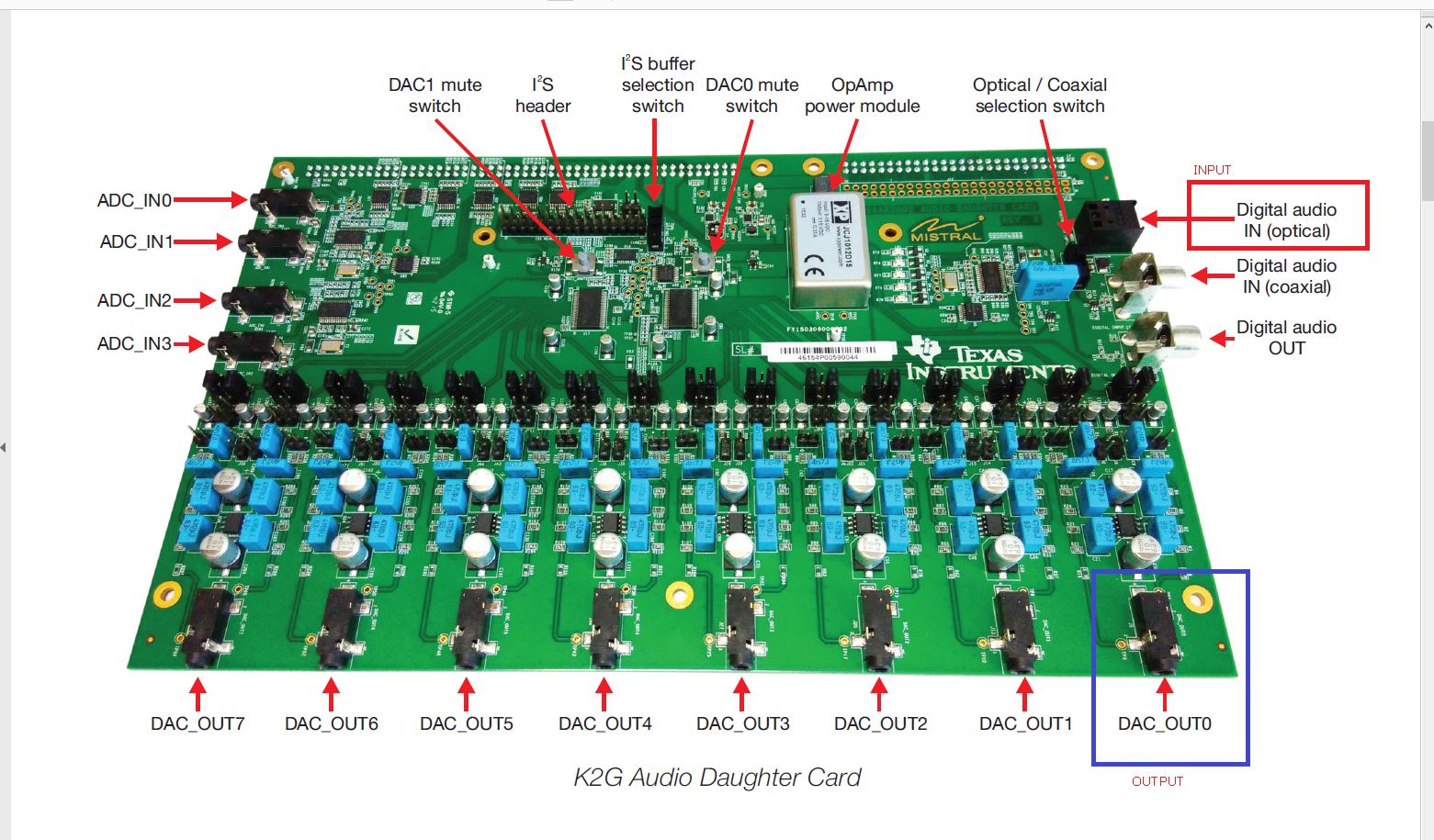

Sometimes Audio noise was confirmed on the evaluation board (K2G Audio Daughter Card + EVMK2G).
As shown in the attached file, the software is modified so that a signal is input to Digital audio IN of  EVMK2G Audio Daughter Card and output from DAC_OUT0.
The I2S signal is input to McASP2 and the signal is output from McASP0.
Separate clocks are used for McASP0 and McASP2.
・McASP2(from DIR9001) use ACLKR input clock.
ACLKRCTL = 0x0080  AHCLKRCTL = 0x0000
・McASP0(to DAC) use internal clock
ACLKXCTL = 0x00A7
Why is audio noise occurring? Is there problem about the McASP use way ?
  • Could you clarify, what software are you using with this setup and what is the sampling rate used with this playback.
    I would recommend that you look at the AUDK2G example in our Processor SDK RTOS that does a 8 channel audio loop back.
    Source Code: pdk_k2g_1_0_15\packages\ti\addon\aud\test
    Here is the MCASP configuration file from that example:

    We currently don`t support optical audio input, loopback. The interface is only meant for our performance/home audio application developers using the demo provided here:
    http://software-dl.ti.com/processor-sdk-rtos/esd/docs/latest/rtos/index_examples_demos.html#performance-audio-demo
    Rahul
