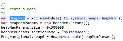

Hi
I want to decrease Sys/Bios heap mem.
Q1:
How much memory Sys/Bios need? Is it possible to calculate it?
Best Regards
Hi
Q1:
Best Regards
Hi Dariush,
This would depend on the application you're writing and how much of the program you're storing into the heap. There is no unified formulae for calculating the heap for a given program.
Yordan
