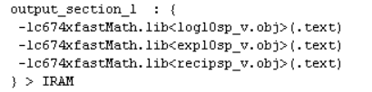

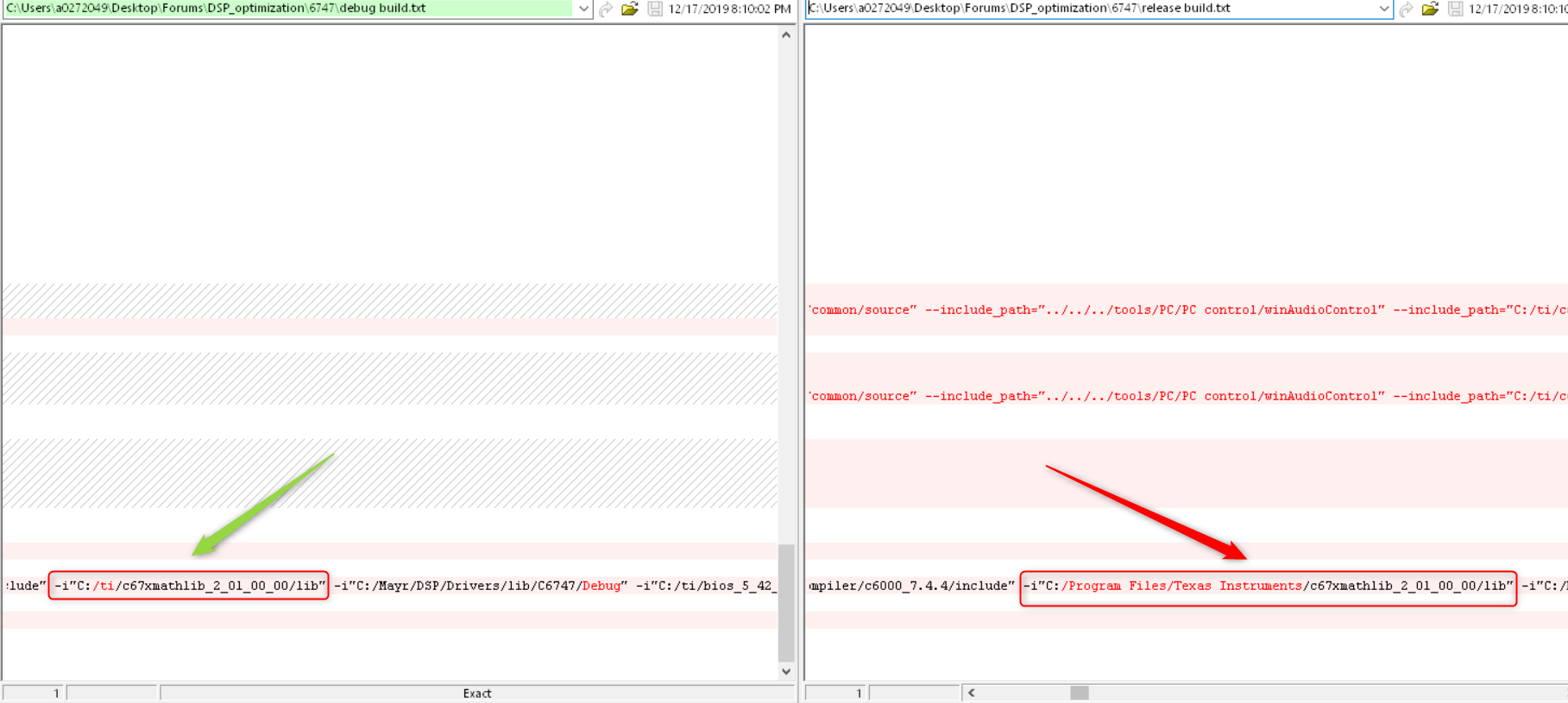

  • I noticed that you are linking into the fastMATH lib and in your link step the include or library search path is different. If the library doesn`t exist the fast math functions will not be found and the linker will use RTS library log, exponential and reciprocal functions and also not place them in IRAM which could be the reason for the performance drop.
    Linking differences in the include path pointing to c674xfastMath library.
    To confirm, you can look at the map file for the debug and release binaries and make sure that the log, exponential and reciprocal functions are being linked from the fastmathlib rather than rts6740.lib. Please fix the path to the fastmathlib and let us know if the issue is resolved.
