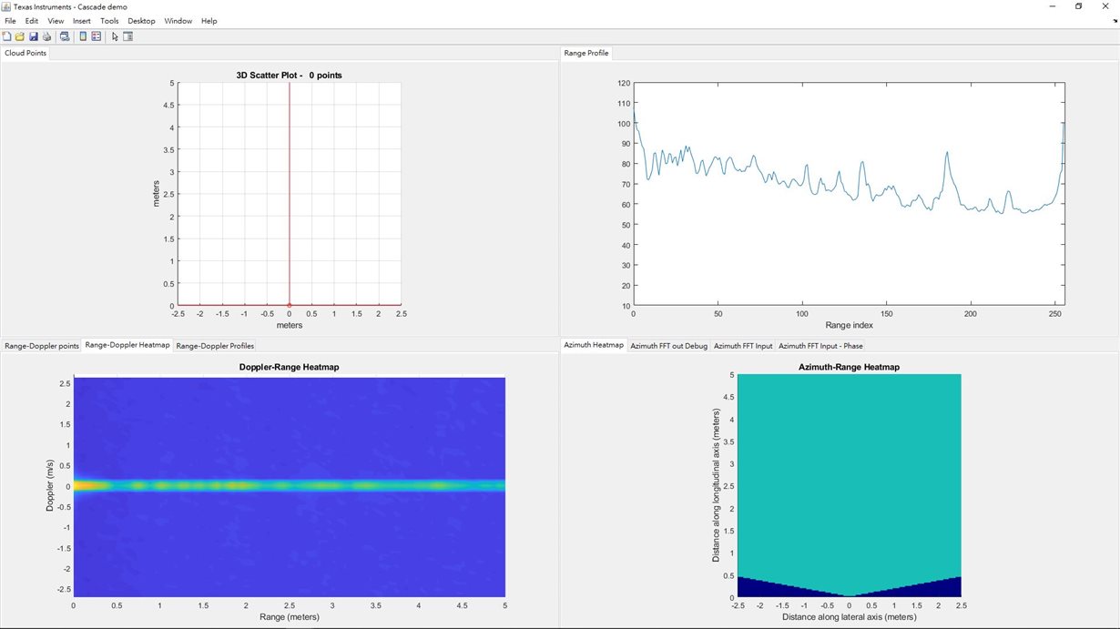

When i run the radar_cascade_demo.m to watch the result, i found some issue.
1. The GUI don't show any point cloud , even if i change the GUI output or Peak detection option. (see fig.1)
But  i can watch objects from Doppler Range heat map.(fig.2)

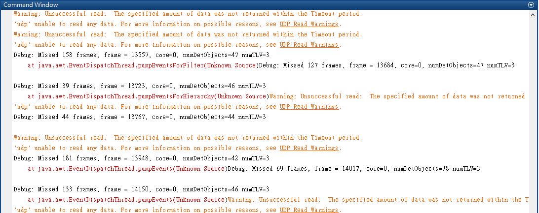

3. Sometimes, the GUI print the frame lost issue.

  • Hi
    Please create the calibration file corresponding to the instructions in Section 3.9.1.6 Cascade Radar (4 AWR1243) Capture + Radar Object Detect (DSP) + Null in the document: vision_sdk\docs\Radar\ProcessorSDKRadar_UserGuide.pdf
    You can place the calibration file generated in a SD card and then try this usecase.
    You should start seeing the point cloud.

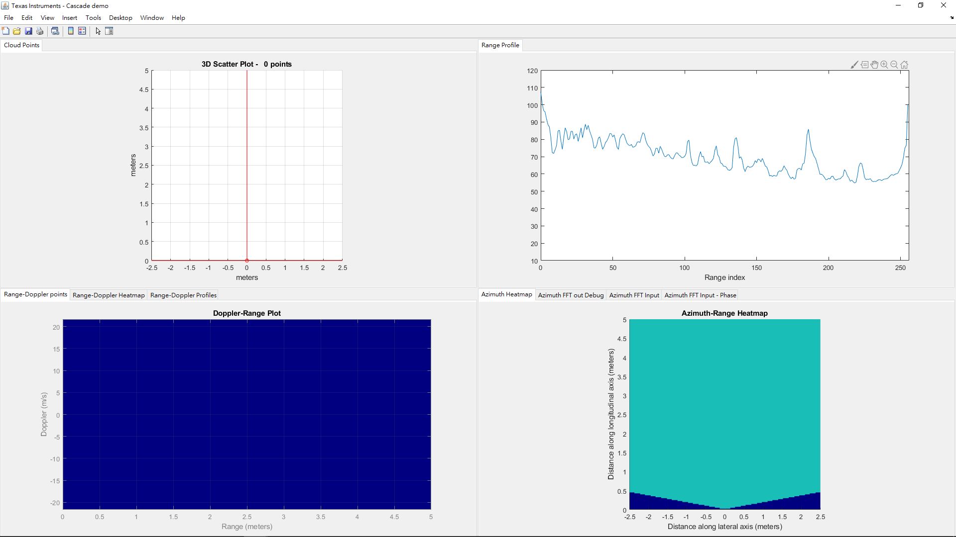

  • Hi, Piyali
    I try to create the calibration file, and i put it into SD card.
    Then I can watch point cloud from GUI, but two issues were happened.
    1. The radar will crash, if i change GUI output option to "1 1 0 0 1".
    2. When the GUI output setting is "1 1 0 0 0", the radar can work.(fig.1)
    But the frame lost issue was happened.(fig.2)

  • In our experiments we have typically seen the data throughput achieved on Windows machines versus Linux machines are lower. One test to check if network throughput is an issue is to stop the MATLAB script and set the same GUI parameters. Enabling the Azimuth plot increases the data throughput requirement, if the usecase continues to run (You can check this with the statistics in the UART console by typing 'p') without the MATLAB connected, this would point to a data throughput issue in your setup.
    If you happen to have a Linux machine with MATLAB installed, you can try the same experiment there and see if you see the same issue.

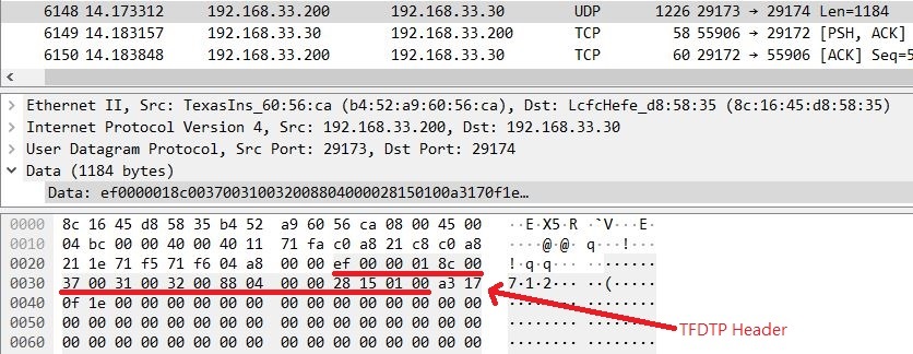

  • Hi, Piyali
    I use the Ethernet monitor software to get the TCP and UDP packages of this demo.
    I use the static IP, and Radar's IP is '192.168.33.200'.
    The PC's IP is '192.168.33.30'.
    When the demo is running, i find a problem.
    At the beginning, i can receive the correct UDP package. (fig.1).
    I receive the wrong UDP package when the demo is running for some time(fig.2).
    The TFDTP header is wrong, because the total seq and offset over the buffer's boundary.
    Could you give me advice?

  • Hi
    I am not sure I follow:
    When you mention "The TFDTP header is wrong, because the total seq and offset over the buffer's boundary.", which buffer are you referring to here?
    The offset is actually calculated based on the total size of the frame being transmitted in chunks.

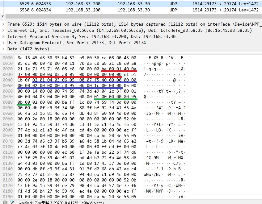

  • Hi, Piyali and Anand
    I try to use the Processor SDK 3.08, and i still get the issue.
    So I change the GUI output options to test each output option.
    Then, I  found some issue.
    1. Although the frame size of udp package is over 65536, it is correct except the Point Cloud and Noise Profile options.
    2. The Point Cloud is not correct because the size of package  always increases.
    According the message header in figure 1 (Blue line), number of the detection objects is 28 (0x1C).
    But the data length of pointer cloud (Green line) is 759168 (0xB9580), it is about 17253 points (size of one point is 44 bytes).
    I think the Radar does not clear the data buffer of point cloud.

  • Hi Morris,
    We have found the issue in the radar processing for point cloud output.
    Could you try adding the highlighted line as the following?
    C:\PROCESSOR_SDK_RADAR_03_07_00_00\vision_sdk\apps\src\rtos\radar\src\alg_plugins\alg_fxns\radardspcascademimo\radarDspCascadeMimo.c, around line 390:
        /* Prepare Output Buffer */
        AlgorithmFxn_RadarDspSetOpPointers(pObj, pOutputMetaDataBuffer);
        opPtr = (AlgorithmFxn_RadarDspCascadeMimoOutput *)
               pOutputMetaDataBuffer->bufAddr[0];
        opPtr->opHdr.frameId = in_buf->frameId;
        outputSectionPointers = &pObj->opBufPointers;
        outputSectionPointers->pPointCloudSectionHeader->sectionLength = 0;
