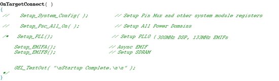

According to http://processors.wiki.ti.com/index.php/Flashing_the_C6747_EVM, I modify my .gel file. I comment some codes as follows and add these configuration codes to my application codes.

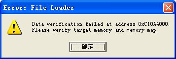

After that, I compile program and download .out file through JTAG( I want to know  this time whether the application code is ok or not), but there is an error:
I think that's because I comment some codes, so I uncomment Setup_System_Config() and Setup_Psc_All_on(). Then I complile program again, and download .out file. This time it's ok.
    You are receiving the error message because the SDRAM is not initialized or powered on prior to loading the program.  Since you removed the GEL functions, this is a common error to receive prior to flashing the program.  After you run your program through the AIS gen utility, the ROM will handle the EMIF initialization if the correct checkboxes are marked.
    When it runs from flash, there is no .gel file. Does the error happen?

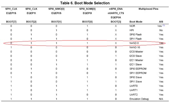

    I see Boot Mode in the output messages is I2C1 Slave. I think it's strange because according to Using the TMS320C6747/45/43 Bootloader,  which I select is nand flash 8.
     My configuration used to creat .bin file is:
  • The first thing we should tackle is the bootmode.  Since it's not in the right bootmode, it will not boot the program inside the NAND8 flash.
    Doing a comparison between I2C1 Slave and NAND8, the BOOT[2] is not correct.  Can you try probing BOOT[2] to make sure that it is pulled high?  After you confirm that, can you try running the GEL file again.
    --Christina
  • I have checked BOOT[2]. You are right. I make a mistake. After it is pulled high, my program can run from nand flash 8. Thank you very much.
    The error does not happen when you run the program from flash if the program was passed through the AISgen GUI with the options to enable the SDRAM.  The AISgen GUI will insert an AIS header at the beginning of your program.  During boot, the AIS header will be parsed by the ROM.  The header will provide information for the ROM to configure the device, such as SDRAM initialization.
    A way to check if the SDRAM got initialized
    • After the device boots, connect to the device via CCS
    • Open a memory window to the SDRAM and try to write/read from the SDRAM region
    • If it is able to write/read properly, that means the SDRAM is initialized correctly
