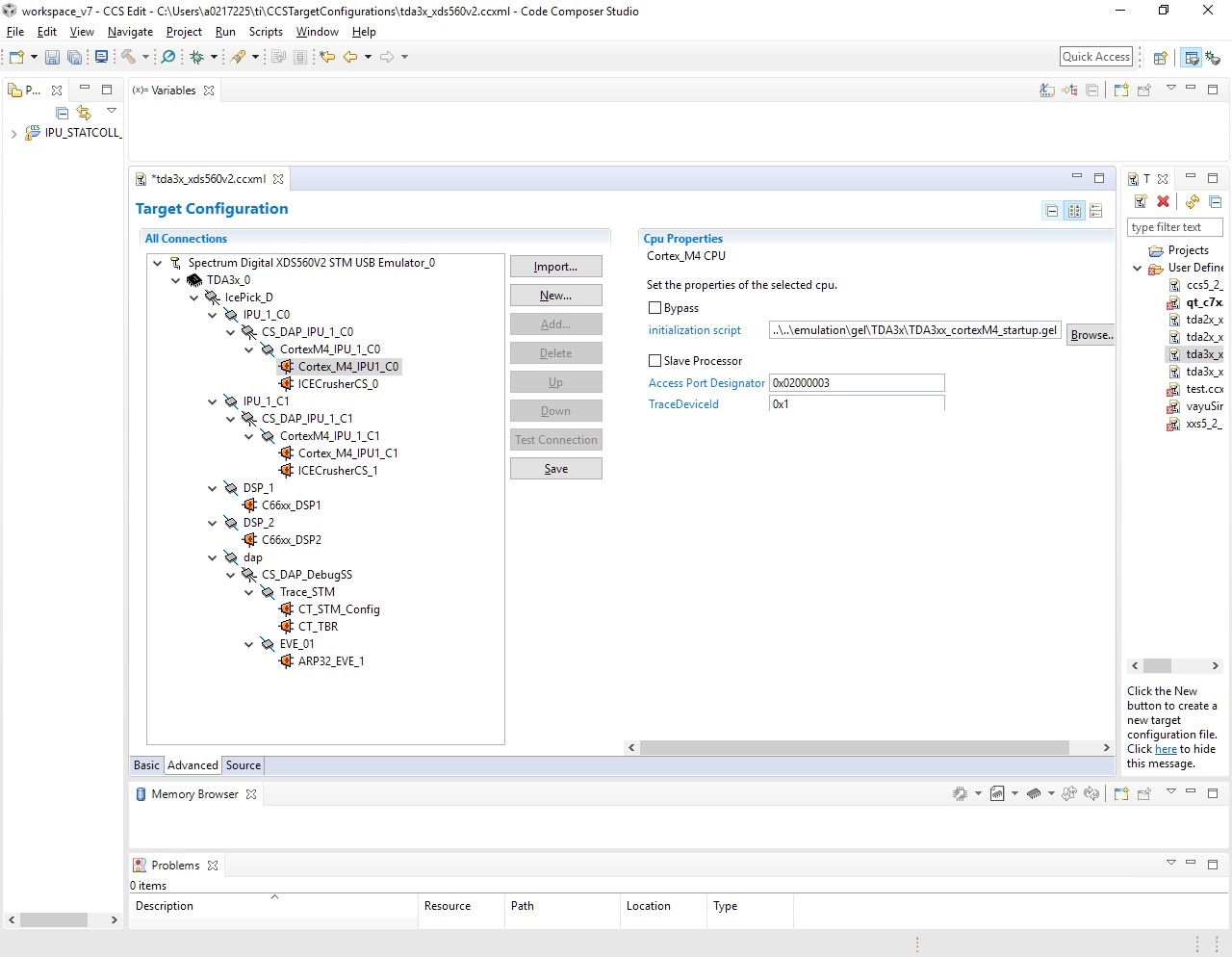

  • Hi Gary,
    Some gel are automatically loaded when starting the debug configuration.The best method to avoid that is to create new TDA3x target configuration, select advanced tab and remove the default initialization script from the input 'initialization script'. box. For Cortex_M4_IPU1_C0, remove TDA3xx_cortexM4_startup.gel, for CS_DAP_DebugSS remove TDA3xx_dap_startup.gel.
    I have attached a snapshot of the CCS window when you create the default tda3x target configuration, it shows the presence of the initialization script. For your debugging purpose, you just need to remove the scripts before saving the configuration.
    regards,
    Victor
  • Hi Victor,
    Thank you for your clear reply.
    Gary
