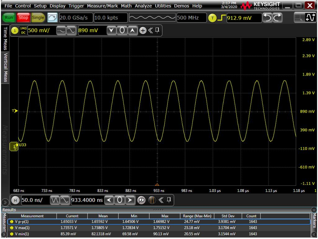

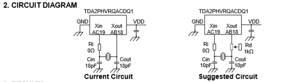

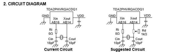

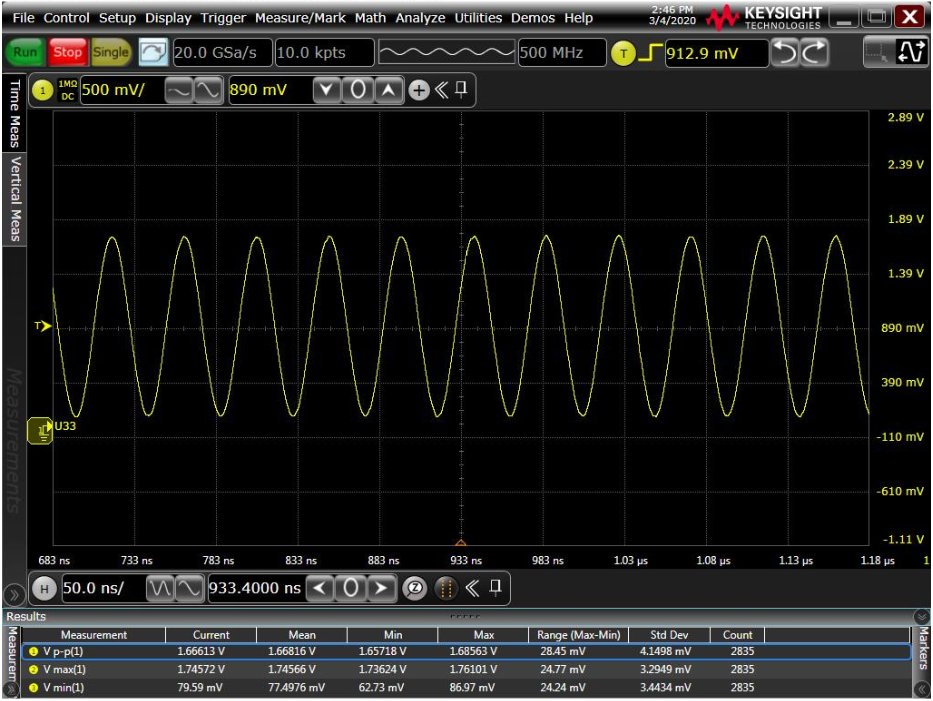

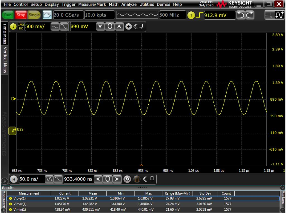

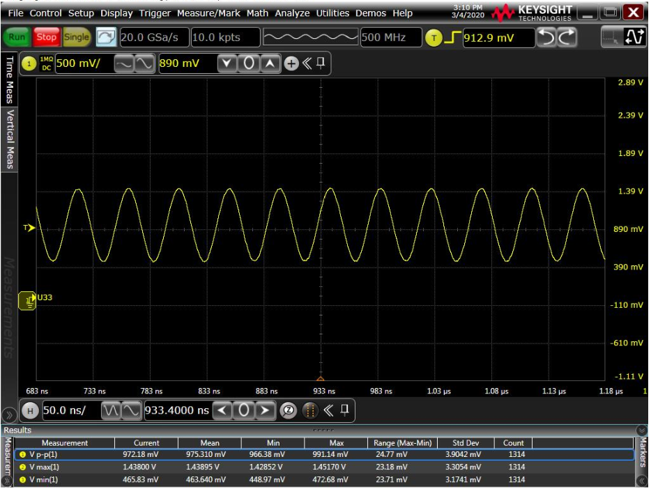

    Our supplier has already performed the tuning of their crystal on our design and they suggest to place a series resistor (Rd) of value 1K in order to adjust the drive strength of the IC output.
    As expected, when we implement this new Rd, we get a considerable reduction of the signal amplitude in the TDA input pin (New Vpp = ~1V).
    Is this signal amplitude still enough for the system to work in a comfortable condition? We really miss this specification in the datasheet.
    You can find osc pics below comparing the signal amplitude in TDA xtal input pin before and after placing the new Rd
    U33 Original condition
    U33 new condition:
    U34 Original condition:
    U34 new condition:
  • I've confirmed that the VIL/VIH specs for the oscillator input are:
    VIL: 0.35*VDD (max)
    VIH: 0.65*VDD (min)
    In addition to meeting the VIL/VIH requirements, please also make sure that the crystal supplier has done the analysis to confirm that the new damping resistor is not large enough to negatively impact the crystal start-up.
  • Hi B.C.
    Thx for the information. we will consider this values as the crystal input limits for the TDA.
    According to our crystal manufacturer they have performed the tuning of the crystal circuitry on a wide range of temperatures.
    Thank you very much for your support.
