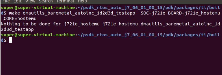

  • Hi   :Anshu
            it is  the  same .     is  the  site  for  command  right?  (super@super-virtual-machine:~/psdk_rtos_auto_j7_06_01_00_15/pdk/packages/ti/build$)
    Shuai
  • You used CORE=hostemu, instead use CORE=c7x-hostemu
    Anshu
  • HI:Anshu
       yes   follow  is  the log!
    make    dmautils_baremetal_autoinc_1d2d3d_testapp    SOC=j721e   BOARD=j721e_hostemu   CORE=hostemu
    Nothing to be done for j721e_hostemu j721e hostemu dmautils_baremetal_autoinc_1d2d3d_testapp
    Regards!
    Shuai
  • Hi Shuai,
       You are not running the correct command. Use the below command :
    make    dmautils_baremetal_autoinc_1d2d3d_testapp    SOC=j721e   BOARD=j721e_hostemu   CORE=c7x-hostemu
    Anshu

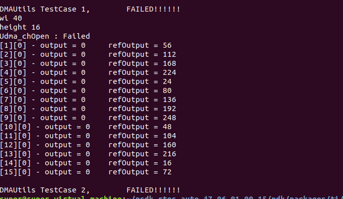

  • Hi:   Anshu
    super@super-virtual-machine:~/psdk_rtos_auto_j7_06_01_00_15/pdk/packages/ti/build$ make   dmautils_baremetal_autoinc_1d2d3d_testapp    SOC=j721e   BOARD=j721e_hostemu   CORE=c7x-hostemu
    make -C /home/super/psdk_rtos_auto_j7_06_01_00_15/pdk/packages/ti/drv/udma/dmautils/test/dmautils_autoinc_1d2d3d_test
    make[1]: Entering directory '/home/super/psdk_rtos_auto_j7_06_01_00_15/pdk/packages/ti/drv/udma/dmautils/test/dmautils_autoinc_1d2d3d_test'
    /bin/mkdir -p /home/super/psdk_rtos_auto_j7_06_01_00_15/pdk/packages/ti/binary/dmautils_baremetal_autoinc_1d2d3d_testapp/obj/j721e_hostemu/c7x-hostemu/release
    /bin/mkdir -p /home/super/psdk_rtos_auto_j7_06_01_00_15/pdk/packages/ti/binary/dmautils_baremetal_autoinc_1d2d3d_testapp/bin/j721e_hostemu
    /bin/mkdir -p /home/super/psdk_rtos_auto_j7_06_01_00_15/pdk/packages/ti/binary/dmautils_baremetal_autoinc_1d2d3d_testapp/obj/j721e_hostemu/c7x-hostemu/release/little/.deps
    /bin/mkdir -p /home/super/psdk_rtos_auto_j7_06_01_00_15/pdk/packages/ti/binary/dmautils_baremetal_autoinc_1d2d3d_testapp/obj/j721e_hostemu/c7x-hostemu/release/configuro

    # Compiling j721e:c7x-hostemu:release:osal_nonos: src/nonos/SemaphoreP_nonos.c
    g++-5 -c -DMAKEFILE_BUILD -std=c++14 -O3 -DHOST_EMULATION  -w -D_HOST_BUILD -DGCC_BUILD  -D__C7100__ -DCORE_DSP  -DBUILD_C7X_1    -DSOC_J721E -I/home/super/psdk_rtos_auto_j7_06_01_00_15/ti-cgt-c7000_1.2.0.STS/host_emulation/include -I. -Isrc/nonos -Isrc/nonos/timer/v1 -Isrc/nonos/delay/v4 -I/home/super/psdk_rtos_auto_j7_06_01_00_15/pdk/packages src/nonos/SemaphoreP_nonos.c -o /home/super/psdk_rtos_auto_j7_06_01_00_15/pdk/packages/ti/binary/ti/osal/osal_nonos/obj/j721e/c7x-hostemu/release/SemaphoreP_nonos.obj
    # Compiling j721e:c7x-hostemu:release:osal_nonos: src/nonos/RegisterIntr_nonos.c
    g++-5 -c -DMAKEFILE_BUILD -std=c++14 -O3 -DHOST_EMULATION  -w -D_HOST_BUILD -DGCC_BUILD  -D__C7100__ -DCORE_DSP  -DBUILD_C7X_1    -DSOC_J721E -I/home/super/psdk_rtos_auto_j7_06_01_00_15/ti-cgt-c7000_1.2.0.STS/host_emulation/include -I. -Isrc/nonos -Isrc/nonos/timer/v1 -Isrc/nonos/delay/v4 -I/home/super/psdk_rtos_auto_j7_06_01_00_15/pdk/packages src/nonos/RegisterIntr_nonos.c -o /home/super/psdk_rtos_auto_j7_06_01_00_15/pdk/packages/ti/binary/ti/osal/osal_nonos/obj/j721e/c7x-hostemu/release/RegisterIntr_nonos.obj
    # Compiling j721e:c7x-hostemu:release:osal_nonos: soc/j721e/TimerP_default.c
    g++-5 -c -DMAKEFILE_BUILD -std=c++14 -O3 -DHOST_EMULATION  -w -D_HOST_BUILD -DGCC_BUILD  -D__C7100__ -DCORE_DSP  -DBUILD_C7X_1    -DSOC_J721E -I/home/super/psdk_rtos_auto_j7_06_01_00_15/ti-cgt-c7000_1.2.0.STS/host_emulation/include -I. -Isrc/nonos -Isrc/nonos/timer/v1 -Isrc/nonos/delay/v4 -I/home/super/psdk_rtos_auto_j7_06_01_00_15/pdk/packages soc/j721e/TimerP_default.c -o /home/super/psdk_rtos_auto_j7_06_01_00_15/pdk/packages/ti/binary/ti/osal/osal_nonos/obj/j721e/c7x-hostemu/release/TimerP_default.obj
    # Compiling j721e:c7x-hostemu:release:osal_nonos: arch/core/c7x/CacheP_nonos.c
    g++-5 -c -DMAKEFILE_BUILD -std=c++14 -O3 -DHOST_EMULATION  -w -D_HOST_BUILD -DGCC_BUILD  -D__C7100__ -DCORE_DSP  -DBUILD_C7X_1    -DSOC_J721E -I/home/super/psdk_rtos_auto_j7_06_01_00_15/ti-cgt-c7000_1.2.0.STS/host_emulation/include -I. -Isrc/nonos -Isrc/nonos/timer/v1 -Isrc/nonos/delay/v4 -I/home/super/psdk_rtos_auto_j7_06_01_00_15/pdk/packages arch/core/c7x/CacheP_nonos.c -o /home/super/psdk_rtos_auto_j7_06_01_00_15/pdk/packages/ti/binary/ti/osal/osal_nonos/obj/j721e/c7x-hostemu/release/CacheP_nonos.obj
    # Compiling j721e:c7x-hostemu:release:osal_nonos: arch/core/c7x/Arch_util.c
    g++-5 -c -DMAKEFILE_BUILD -std=c++14 -O3 -DHOST_EMULATION  -w -D_HOST_BUILD -DGCC_BUILD  -D__C7100__ -DCORE_DSP  -DBUILD_C7X_1    -DSOC_J721E -I/home/super/psdk_rtos_auto_j7_06_01_00_15/ti-cgt-c7000_1.2.0.STS/host_emulation/include -I. -Isrc/nonos -Isrc/nonos/timer/v1 -Isrc/nonos/delay/v4 -I/home/super/psdk_rtos_auto_j7_06_01_00_15/pdk/packages arch/core/c7x/Arch_util.c -o /home/super/psdk_rtos_auto_j7_06_01_00_15/pdk/packages/ti/binary/ti/osal/osal_nonos/obj/j721e/c7x-hostemu/release/Arch_util.obj
    # Compiling j721e:c7x-hostemu:release:osal_nonos: src/nonos/timer/v1/TimerP_nonos.c
    g++-5 -c -DMAKEFILE_BUILD -std=c++14 -O3 -DHOST_EMULATION  -w -D_HOST_BUILD -DGCC_BUILD  -D__C7100__ -DCORE_DSP  -DBUILD_C7X_1    -DSOC_J721E -I/home/super/psdk_rtos_auto_j7_06_01_00_15/ti-cgt-c7000_1.2.0.STS/host_emulation/include -I. -Isrc/nonos -Isrc/nonos/timer/v1 -Isrc/nonos/delay/v4 -I/home/super/psdk_rtos_auto_j7_06_01_00_15/pdk/packages src/nonos/timer/v1/TimerP_nonos.c -o /home/super/psdk_rtos_auto_j7_06_01_00_15/pdk/packages/ti/binary/ti/osal/osal_nonos/obj/j721e/c7x-hostemu/release/TimerP_nonos.obj
    # Compiling j721e:c7x-hostemu:release:osal_nonos: src/nonos/delay/v4/delay.c
    g++-5 -c -DMAKEFILE_BUILD -std=c++14 -O3 -DHOST_EMULATION  -w -D_HOST_BUILD -DGCC_BUILD  -D__C7100__ -DCORE_DSP  -DBUILD_C7X_1    -DSOC_J721E -I/home/super/psdk_rtos_auto_j7_06_01_00_15/ti-cgt-c7000_1.2.0.STS/host_emulation/include -I. -Isrc/nonos -Isrc/nonos/timer/v1 -Isrc/nonos/delay/v4 -I/home/super/psdk_rtos_auto_j7_06_01_00_15/pdk/packages src/nonos/delay/v4/delay.c -o /home/super/psdk_rtos_auto_j7_06_01_00_15/pdk/packages/ti/binary/ti/osal/osal_nonos/obj/j721e/c7x-hostemu/release/delay.obj
    /bin/mkdir -p /home/super/psdk_rtos_auto_j7_06_01_00_15/pdk/packages/ti/osal/lib/nonos/j721e/c7x-hostemu/release
    # Archiving j721e:c7x-hostemu:release:osal_nonos into /home/super/psdk_rtos_auto_j7_06_01_00_15/pdk/packages/ti/osal/lib/nonos/j721e/c7x-hostemu/release/ti.osal.lib ...
    gcc-ar-5 rvs /home/super/psdk_rtos_auto_j7_06_01_00_15/pdk/packages/ti/osal/lib/nonos/j721e/c7x-hostemu/release/ti.osal.lib  /home/super/psdk_rtos_auto_j7_06_01_00_15/pdk/packages/ti/binary/ti/osal/osal_nonos/obj/j721e/c7x-hostemu/release/HwiP_nonos.obj  /home/super/psdk_rtos_auto_j7_06_01_00_15/pdk/packages/ti/binary/ti/osal/osal_nonos/obj/j721e/c7x-hostemu/release/SwiP_nonos.obj  /home/super/psdk_rtos_auto_j7_06_01_00_15/pdk/packages/ti/binary/ti/osal/osal_nonos/obj/j721e/c7x-hostemu/release/Utils_nonos.obj  /home/super/psdk_rtos_auto_j7_06_01_00_15/pdk/packages/ti/binary/ti/osal/osal_nonos/obj/j721e/c7x-hostemu/release/SemaphoreP_nonos.obj  /home/super/psdk_rtos_auto_j7_06_01_00_15/pdk/packages/ti/binary/ti/osal/osal_nonos/obj/j721e/c7x-hostemu/release/RegisterIntr_nonos.obj  /home/super/psdk_rtos_auto_j7_06_01_00_15/pdk/packages/ti/binary/ti/osal/osal_nonos/obj/j721e/c7x-hostemu/release/TimerP_default.obj  /home/super/psdk_rtos_auto_j7_06_01_00_15/pdk/packages/ti/binary/ti/osal/osal_nonos/obj/j721e/c7x-hostemu/release/CacheP_nonos.obj  /home/super/psdk_rtos_auto_j7_06_01_00_15/pdk/packages/ti/binary/ti/osal/osal_nonos/obj/j721e/c7x-hostemu/release/Arch_util.obj  /home/super/psdk_rtos_auto_j7_06_01_00_15/pdk/packages/ti/binary/ti/osal/osal_nonos/obj/j721e/c7x-hostemu/release/TimerP_nonos.obj  /home/super/psdk_rtos_auto_j7_06_01_00_15/pdk/packages/ti/binary/ti/osal/osal_nonos/obj/j721e/c7x-hostemu/release/delay.obj
    /usr/bin/ar: creating /home/super/psdk_rtos_auto_j7_06_01_00_15/pdk/packages/ti/osal/lib/nonos/j721e/c7x-hostemu/release/ti.osal.lib
    a - /home/super/psdk_rtos_auto_j7_06_01_00_15/pdk/packages/ti/binary/ti/osal/osal_nonos/obj/j721e/c7x-hostemu/release/HwiP_nonos.obj
    a - /home/super/psdk_rtos_auto_j7_06_01_00_15/pdk/packages/ti/binary/ti/osal/osal_nonos/obj/j721e/c7x-hostemu/release/SwiP_nonos.obj
    a - /home/super/psdk_rtos_auto_j7_06_01_00_15/pdk/packages/ti/binary/ti/osal/osal_nonos/obj/j721e/c7x-hostemu/release/Utils_nonos.obj
    a - /home/super/psdk_rtos_auto_j7_06_01_00_15/pdk/packages/ti/binary/ti/osal/osal_nonos/obj/j721e/c7x-hostemu/release/SemaphoreP_nonos.obj
    a - /home/super/psdk_rtos_auto_j7_06_01_00_15/pdk/packages/ti/binary/ti/osal/osal_nonos/obj/j721e/c7x-hostemu/release/RegisterIntr_nonos.obj
    a - /home/super/psdk_rtos_auto_j7_06_01_00_15/pdk/packages/ti/binary/ti/osal/osal_nonos/obj/j721e/c7x-hostemu/release/TimerP_default.obj
    a - /home/super/psdk_rtos_auto_j7_06_01_00_15/pdk/packages/ti/binary/ti/osal/osal_nonos/obj/j721e/c7x-hostemu/release/CacheP_nonos.obj
    a - /home/super/psdk_rtos_auto_j7_06_01_00_15/pdk/packages/ti/binary/ti/osal/osal_nonos/obj/j721e/c7x-hostemu/release/Arch_util.obj
    a - /home/super/psdk_rtos_auto_j7_06_01_00_15/pdk/packages/ti/binary/ti/osal/osal_nonos/obj/j721e/c7x-hostemu/release/TimerP_nonos.obj
    a - /home/super/psdk_rtos_auto_j7_06_01_00_15/pdk/packages/ti/binary/ti/osal/osal_nonos/obj/j721e/c7x-hostemu/release/delay.obj
    make[3]: Leaving directory '/home/super/psdk_rtos_auto_j7_06_01_00_15/pdk/packages/ti/osal'
    make[2]: Leaving directory '/home/super/psdk_rtos_auto_j7_06_01_00_15/pdk/packages/ti/drv/udma/dmautils/test/dmautils_autoinc_1d2d3d_test'
    make  /home/super/psdk_rtos_auto_j7_06_01_00_15/pdk/packages/ti/binary/dmautils_baremetal_autoinc_1d2d3d_testapp/bin/j721e_hostemu/dmautils_baremetal_autoinc_1d2d3d_testapp_c7x-hostemu_release.exe
    make[2]: Entering directory '/home/super/psdk_rtos_auto_j7_06_01_00_15/pdk/packages/ti/drv/udma/dmautils/test/dmautils_autoinc_1d2d3d_test'
    # Compiling j721e_hostemu:j721e:c7x-hostemu:release:dmautils_baremetal_autoinc_1d2d3d_testapp: dmautils_autoinc_1d2d3d_example.c
    g++-5 -c -DMAKEFILE_BUILD -std=c++14 -O3 -DHOST_EMULATION  -w -D_HOST_BUILD -DGCC_BUILD  -D__C7100__ -DCORE_DSP  -DBUILD_C7X_1    -DSOC_J721E -DHOST_EMULATION -I/home/super/psdk_rtos_auto_j7_06_01_00_15/ti-cgt-c7000_1.2.0.STS/host_emulation/include -I. -I/home/super/psdk_rtos_auto_j7_06_01_00_15/pdk/packages dmautils_autoinc_1d2d3d_example.c -o /home/super/psdk_rtos_auto_j7_06_01_00_15/pdk/packages/ti/binary/dmautils_baremetal_autoinc_1d2d3d_testapp/obj/j721e_hostemu/c7x-hostemu/release/dmautils_autoinc_1d2d3d_example.obj
    # Compiling j721e_hostemu:j721e:c7x-hostemu:release:dmautils_baremetal_autoinc_1d2d3d_testapp: dmautils_autoinc_1d2d3d_test.c
    g++-5 -c -DMAKEFILE_BUILD -std=c++14 -O3 -DHOST_EMULATION  -w -D_HOST_BUILD -DGCC_BUILD  -D__C7100__ -DCORE_DSP  -DBUILD_C7X_1    -DSOC_J721E -DHOST_EMULATION -I/home/super/psdk_rtos_auto_j7_06_01_00_15/ti-cgt-c7000_1.2.0.STS/host_emulation/include -I. -I/home/super/psdk_rtos_auto_j7_06_01_00_15/pdk/packages dmautils_autoinc_1d2d3d_test.c -o /home/super/psdk_rtos_auto_j7_06_01_00_15/pdk/packages/ti/binary/dmautils_baremetal_autoinc_1d2d3d_testapp/obj/j721e_hostemu/c7x-hostemu/release/dmautils_autoinc_1d2d3d_test.obj
    # Linking into /home/super/psdk_rtos_auto_j7_06_01_00_15/pdk/packages/ti/binary/dmautils_baremetal_autoinc_1d2d3d_testapp/bin/j721e_hostemu/dmautils_baremetal_autoinc_1d2d3d_testapp_c7x-hostemu_release.exe...
    g++-5 -Wl,--start-group -o /home/super/psdk_rtos_auto_j7_06_01_00_15/pdk/packages/ti/binary/dmautils_baremetal_autoinc_1d2d3d_testapp/bin/j721e_hostemu/dmautils_baremetal_autoinc_1d2d3d_testapp_c7x-hostemu_release.exe      -L /home/super/psdk_rtos_auto_j7_06_01_00_15/pdk/packages/ti/csl/lib/j721e/c7x-hostemu/release/ -L /home/super/psdk_rtos_auto_j7_06_01_00_15/pdk/packages/ti/drv/udma/lib/j721e_hostemu/c7x-hostemu/release/ -L /home/super/psdk_rtos_auto_j7_06_01_00_15/pdk/packages/ti/drv/udma/lib/j721e_hostemu/c7x-hostemu/release/ -L /home/super/psdk_rtos_auto_j7_06_01_00_15/pdk/packages/ti/drv/sciclient/lib/j721e_hostemu/c7x-hostemu/release/ -L /home/super/psdk_rtos_auto_j7_06_01_00_15/pdk/packages/ti/osal/lib/nonos/j721e/c7x-hostemu/release/ -l:ti.csl.lib -l:udma.lib -l:dmautils.lib -l:sciclient.lib -l:ti.osal.lib  /home/super/psdk_rtos_auto_j7_06_01_00_15/pdk/packages/ti/binary/dmautils_baremetal_autoinc_1d2d3d_testapp/obj/j721e_hostemu/c7x-hostemu/release/dmautils_autoinc_1d2d3d_example.obj  /home/super/psdk_rtos_auto_j7_06_01_00_15/pdk/packages/ti/binary/dmautils_baremetal_autoinc_1d2d3d_testapp/obj/j721e_hostemu/c7x-hostemu/release/dmautils_autoinc_1d2d3d_test.obj
    /home/super/psdk_rtos_auto_j7_06_01_00_15/pdk/packages/ti/drv/udma/lib/j721e_hostemu/c7x-hostemu/release//udma.lib(udma_event.obj): In function `Udma_eventRegister':
    udma_event.c:(.text+0x8ad): undefined reference to `Sciclient_rmIrqSet'
    /home/super/psdk_rtos_auto_j7_06_01_00_15/pdk/packages/ti/drv/udma/lib/j721e_hostemu/c7x-hostemu/release//udma.lib(udma_event.obj): In function `Udma_eventGetRxFlowIdFwStatus':
    udma_event.c:(.text+0x1de1): undefined reference to `Sciclient_rmUdmapGcfgCfg'
    /home/super/psdk_rtos_auto_j7_06_01_00_15/pdk/packages/ti/drv/udma/lib/j721e_hostemu/c7x-hostemu/release//udma.lib(udma_ch.obj): In function `Udma_chConfigTx':
    udma_ch.c:(.text+0x170c): undefined reference to `Sciclient_rmUdmapTxChCfg'
    /home/super/psdk_rtos_auto_j7_06_01_00_15/pdk/packages/ti/drv/udma/lib/j721e_hostemu/c7x-hostemu/release//udma.lib(udma_ch.obj): In function `Udma_chConfigRx':
    udma_ch.c:(.text+0x1929): undefined reference to `Sciclient_rmUdmapRxChCfg'
    /home/super/psdk_rtos_auto_j7_06_01_00_15/pdk/packages/ti/drv/udma/lib/j721e_hostemu/c7x-hostemu/release//udma.lib(udma_ch.obj): In function `Udma_chConfigUtc':
    udma_ch.c:(.text+0x1e17): undefined reference to `Sciclient_rmUdmapTxChCfg'
    /home/super/psdk_rtos_auto_j7_06_01_00_15/pdk/packages/ti/drv/udma/lib/j721e_hostemu/c7x-hostemu/release//udma.lib(udma_ch.obj): In function `Udma_chSetChaining':
    udma_ch.c:(.text+0x3b8c): undefined reference to `Sciclient_rmIrqSet'
    udma_ch.c:(.text+0x3c23): undefined reference to `Sciclient_rmIrqSet'
    /home/super/psdk_rtos_auto_j7_06_01_00_15/pdk/packages/ti/drv/udma/lib/j721e_hostemu/c7x-hostemu/release//udma.lib(udma_ring.obj): In function `Udma_ringAlloc':
    udma_ring.c:(.text+0x23c): undefined reference to `Sciclient_rmRingCfg'
    /home/super/psdk_rtos_auto_j7_06_01_00_15/pdk/packages/ti/drv/udma/lib/j721e_hostemu/c7x-hostemu/release//udma.lib(udma_ring.obj): In function `Udma_ringMonConfig':
    udma_ring.c:(.text+0xebf): undefined reference to `Sciclient_rmRingMonCfg'
    /home/super/psdk_rtos_auto_j7_06_01_00_15/pdk/packages/ti/drv/udma/lib/j721e_hostemu/c7x-hostemu/release//udma.lib(udma_flow.obj): In function `Udma_flowConfig':
    udma_flow.c:(.text+0x69b): undefined reference to `Sciclient_rmUdmapFlowCfg'
    udma_flow.c:(.text+0x721): undefined reference to `Sciclient_rmUdmapFlowSizeThreshCfg'
    collect2: error: ld returned 1 exit status
    /home/super/psdk_rtos_auto_j7_06_01_00_15/pdk/packages/ti/build/makerules/rules_c7x-hostemu.mk:202: recipe for target '/home/super/psdk_rtos_auto_j7_06_01_00_15/pdk/packages/ti/binary/dmautils_baremetal_autoinc_1d2d3d_testapp/bin/j721e_hostemu/dmautils_baremetal_autoinc_1d2d3d_testapp_c7x-hostemu_release.exe' failed
    make[2]: *** [/home/super/psdk_rtos_auto_j7_06_01_00_15/pdk/packages/ti/binary/dmautils_baremetal_autoinc_1d2d3d_testapp/bin/j721e_hostemu/dmautils_baremetal_autoinc_1d2d3d_testapp_c7x-hostemu_release.exe] Error 1
    /home/super/psdk_rtos_auto_j7_06_01_00_15/pdk/packages/ti/build/makerules/common.mk:402: recipe for target 'c7x-hostemu' failed
    make[1]: *** [c7x-hostemu] Error 2
    make[1]: Leaving directory '/home/super/psdk_rtos_auto_j7_06_01_00_15/pdk/packages
    Shuai

         Ubuntu  18.04  ,  i  try  make   dmautils_baremetal_autoinc_1d2d3d_testapp    SOC=j721e   BOARD=j721e_evm   CORE=c7x_1
    # /home/super/psdk_rtos_auto_j7_06_01_00_15/pdk/packages/ti/binary/dmautils_baremetal_autoinc_1d2d3d_testapp/bin/j721e_evm/dmautils_baremetal_autoinc_1d2d3d_testapp_c7x_1_release.xe71 created.
           is    this  file  (dmautils_baremetal_autoinc_1d2d3d_testapp_c7x_1_release.xe71)    run   on  c7x?
           but    we  have  to  emulation  our  code  on  PC  first!  so  its  strange  report errors  above!
    Shuai

  • Hi: Anshu
              i    compared   these  tow   files  are  the  same    with   currently used!
    Shuai
  • Shuai,
       This is surprising. I built using the same files and I don't see any issue after this change. Can you try clean build and replacing these files?
    Anshu
  • Hi:    Anshu
           clean build     using    make  clean   ?
    thanks!
    Shuai
  • You can do make allclean
    Anshu
  • HI:   Anshu
           I    make  all  clean   ,and   rebuild   it   ,  but  also  the  same.
    Shuai
  • HI:   Anshu
         I add the missing function to the corresponding. C file according to the compilation error.
         Then  exe  is  creat   and  i   run  it   .
        follow   is   the  result!
    Shuia

  • Hi:Anshu
           first   i   have  to   emulation  on  PC,    so    why  does   the  result  is  diffrent?    it  means   UDMA  is  faild   on  pc?
    Udma_chOpen : Failed
    [1][0] - output = 0 refOutput = 56
    [2][0] - output = 0 refOutput = 112
    [3][0] - output = 0 refOutput = 168
    [4][0] - output = 0 refOutput = 224
    [5][0] - output = 0 refOutput = 24
    [6][0] - output = 0 refOutput = 80
    [7][0] - output = 0 refOutput = 136
    [8][0] - output = 0 refOutput = 192
    [9][0] - output = 0 refOutput = 248
    [10][0] - output = 0 refOutput = 48
    [11][0] - output = 0 refOutput = 104
    [12][0] - output = 0 refOutput = 160
    [13][0] - output = 0 refOutput = 216
    [14][0] - output = 0 refOutput = 16
    [15][0] - output = 0 refOutput = 72
    Shuai
  • Hi Shuai,
        It is failing only in host emulation. Can you try the same example on EVM and check if it is working then we can see why its not working on host emulation. These examples are just for reference and hence may not be tested with host emulation.
    Anshu
  • Hi :Anshu
            OK !
       you   mean   run    dmautils_baremetal_autoinc_1d2d3d_testapp_c7x_1_release.xe71     on  the  EVM?
    Shuai
