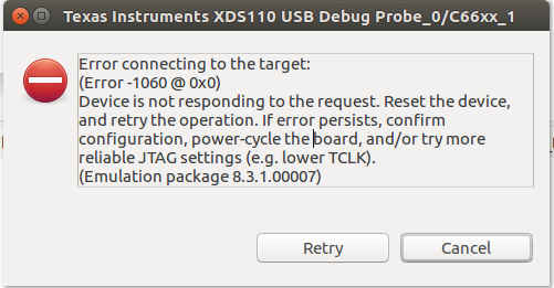

  3. I use SD Boot Mode to boot Linux on A72, then lauch J721E_EVM.ccxml. I can connect C66xx_0, but fail to connect C66xx_1.

    #3 I use SD Boot Mode to boot Linux on A72, then lauch J721E_EVM.ccxml. I can connect C66xx_0, but fail to connect C66xx_1.
    You should be able to connect both C66x. Can you connect C66x_1 in no-boot mode after running the lunch.js ccs script from sciclient?

    #3 I can connect both C66x_0 and C66x_1 in no-boot mode. But I can not connect C66x_1 in SD Boot Mode.

    Is this custom bootloader you wrote or you are using stock bootloader from release ?  do you have /lib/firmware/j7-c66_1-fw in root filesystem?
  • #3
    yes, I have /lib/firmware/j7-c66_1-fw in root filesystem. When I try to connect C66xx_1, CCS says:
    I can run vision_app_tidl_avp2, so I think both C66xx are alive.
  • Lance,
    Can you interrupt the boot sequence, and at boot prompt print the environment variable.
    Can you check if you have something like this?
    rproc_fw_binaries=3 /lib/firmware/j7-main-r5f0_1-fw 4 /lib/firmware/j7-main-r5f1_0-fw 6 /lib/firmware/j7-c66_0-fw 7 /lib/firmware/j7-c66_1-fw 8 /lib/firmware/j7-c71_0-fw
    Also, can you check the boot log if it is booting ok all cores?
