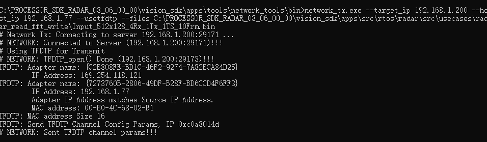

I just complete build and run the radar_read_fft_write demo.And  using network transmit data Input_512x128_4Rx_1Tx_1TS_10Frm.bin.Some print logs are as follows,

[IPU1-1] 317.263557 s: NETWORK: TFDTP Tx HOST IP Address = 0xc0a8014d
[IPU1-1] 317.264320 s: NETWORK: TFDTP Tx channel opened !!!
[IPU1-1] 317.264442 s: NETWORK: TFDTP started !!!
[IPU1-1] 317.264503 s: NETWORK_TX: NETWORK_TX: Connected to client (port=29172) !!!
[IPU1-1] 439.909199 s: NETWORK: TFDTP Transmit Ack Read Failed !!!
[IPU1-1] 439.926340 s: NETWORK: TFDTP Transmit Ack Read Failed !!!
[IPU1-1] 439.943146 s: NETWORK: TFDTP Transmit Ack Read Failed !!!
[IPU1-1] 439.943268 s: NETWORK_TX: Network_tfdtpWrite() Failed for BUF0 !!
[IPU1-1] 439.943512 s: NETWORK_TX: NETWORK_TX: Disconnected from client while writing header (port=29172)!!!
[IPU1-1] 439.943695 s: NETWORK: TFDTP Stack Closed!!!
[IPU1-1] 445.533977 s: NETWORK_RX: NETWORK_RX: Disconnected from client while writing header (port=29171)!!!
[IPU1-1] 445.535319 s: NETWORK: TFDTP Stack Closed!!!
I think the network is connected successfully.And sending data using the network tool.
Send and receive separately but data is not sent successfully.What causes this situation?
