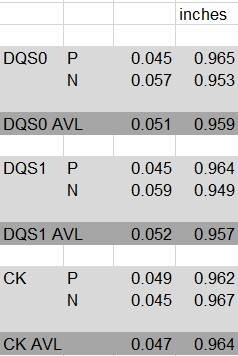

    This could be a timing issue or it could be a signal integrity issue.  Can you reconfigure the DDR interface to operate at a slower speed to see if it operates correctly without the resistor?  Did you check the length matching of all the address/command and data signal trace lengths to be sure it meets the recommendation provided by TI?

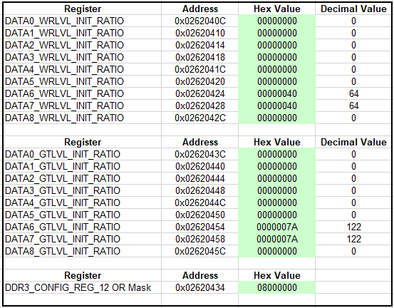

            We have check the DQS & CK PCB trace length,the difference is very small, so we doublt that  the write leveling maybe mismatch, then we reconfig register
    0x02620414 & 0x02620418 from 0 to 64(Decimal), the issue is resovled.

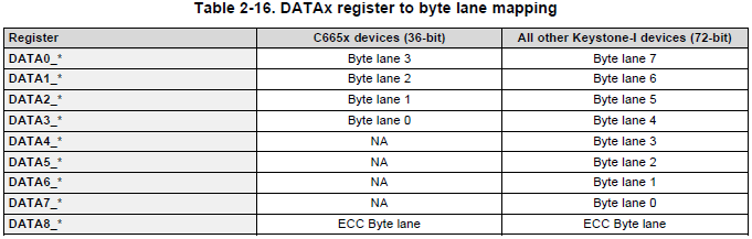

  • We have found the mistake of configuration for WL_INIT and GT_INIT.
    we use Byte0 and Byte1 of C6657, and should configure the WL_INIT and GT_INIT in the REG DATA3_* and DATA2_*, but we configured in DATA7_* and DATA6_* according "PHY calculation spreadsheet" because of misunderstanding.
    According to the spreadsheet, we re-configured the WL_INIT and GT_INIT, and it seems the board work properly.

  • Hi Elan,
    I am a little confused by your posts.  You stated that you found an error in your initialization and the fixing the error allowed the board to operate correctly.  Are you asking why the incorrect initialization did not work?
    You also posted some length matching data for the DQSp/n and the clock signals.  The DDR3 implementation guide does not include a routing requirement that these signals be length matched.   The clock needs to be length matched to the address and command signal to both DDR3 devices.  The DQS0p/n needs to be length matched to the lowest data byte lane (DQ0-7) and the DSQ1p/n needs to be length matched to the next byte lane (DQ8-15).  Are you sure you have length matched the DDR traces correctly?
    Regards, Bill

  • Hi Tom,
           The spreadsheets is attached below, and my questions are listed above.
    DDR3 PHY Calc v10-20191224.xlsx
    I think the issue is that the improper configuration result in the failure of training, so I want to know how to verify the result of training.
