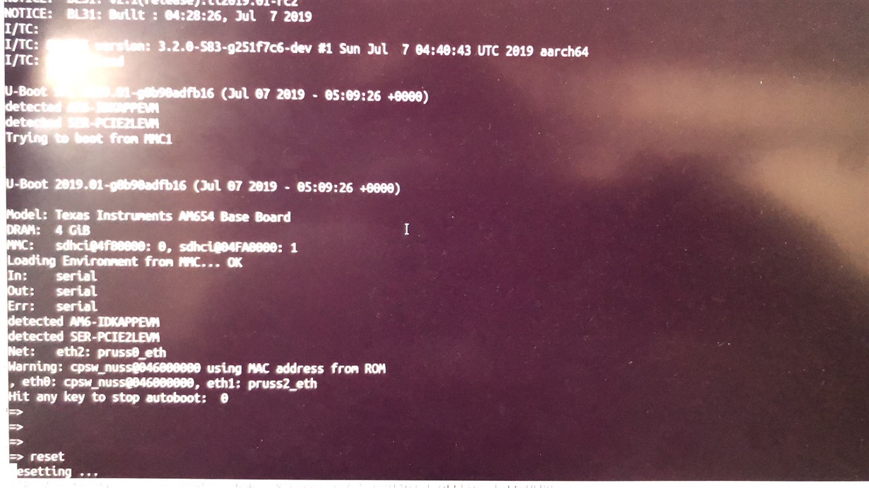

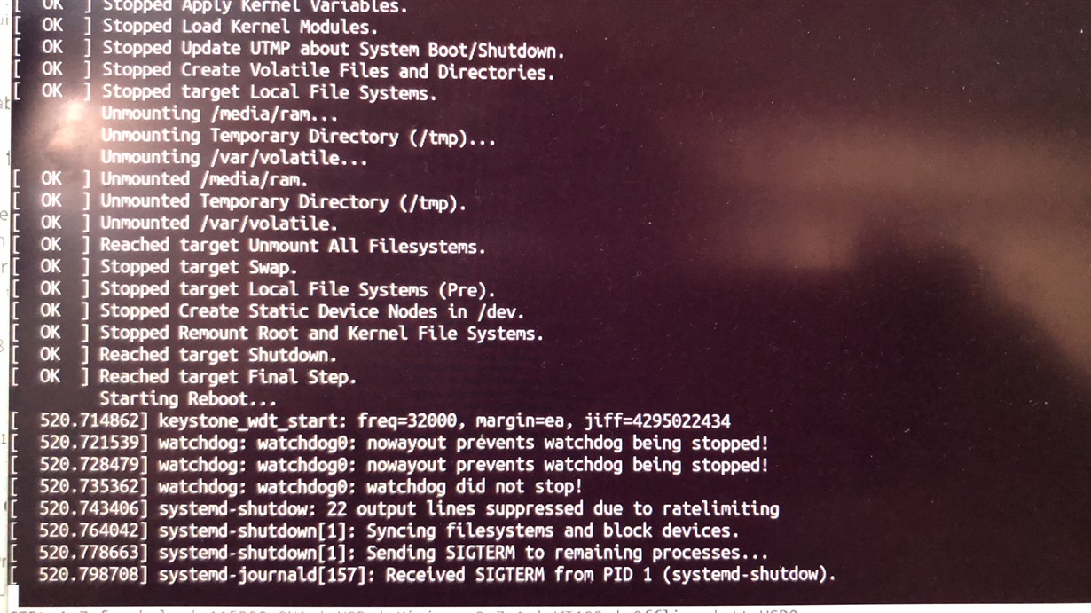

Working on EVM:
#1. Boot from eMMC, execute reset from U-boot, or restart from Linux, hangs as below snapshot:
#2. boot from MMC, it is OK.
#3. Push reset button to reboot is OK.

  • Tony,
    from the screenshots I can see that you are using an older SDK, and I know there have been issues with software-initiated device resets on AM654x on earlier builds of the SDK that have since gotten resolved. Can you please re-try using the latest processor SDK and see if this fixes your issues:
    http://software-dl.ti.com/processor-sdk-linux/esd/AM65X/latest/index_FDS.html
    Regards, Andreas

  • E3 EVM. reset from UBOOT log as below:
    It is same on customer's board, and it is same when using watchdog reset(enable watchdog in Linux, doesn't feed watchdog to reset the device)
  • Hi Tony,
    I can re-create this issue on our Rev E3 EVM with the current SDK performing eMMC raw boot. I can also re-create it with the latest-latest ti-u-boot-2019.01 development branch. Going through my archives it seems like that U-Boot leaves the eMMC in a state that prevents ROM code from booting. Will follow-up internally to see if this is something we can fix easily in (U-Boot) software.
    One workaround however I just found and successfully tested is booting from eMMC UDA. Basically, treat the eMMC UDA area just like an SD card, have a FAT32 boot partition there, and a partition for Linux, etc. In this case you can reboot without any issue as in this case the ROM has less dependencies on the state the eMMC was left in it seems.
