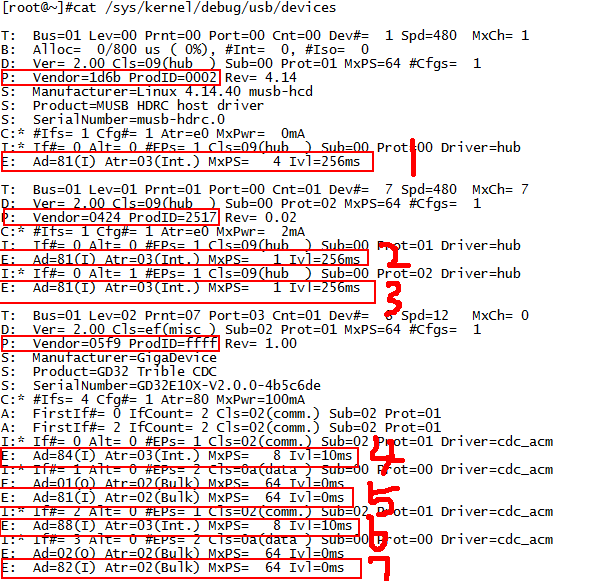

  • Hi Qiang,
    Yes, the MUSB controller hardware can support up to 15 TX interrupt endpoints, but to cover most of USB use cases, the MUSB driver configures some endpoint FIFO in shared FIFO mode, which might affect the up limit of the interrupt use cases. The endpoint FIFO configuration is in struct mode_4_cfg[] in musb_core.c. You can try to modify hw_ep_num 13, 14, 15 to have the same .style as hw_ep_num 1, and modify .maxpacket to 512 for ALL endpoints, to see if you can get the 4th module enumerated.
    Yes, a USB hub will occupy one interrupt endpoint.
    To check the endpoint numbers and types needed for a USB device, you can read the output of command 'lsusb -v -d <vid:pid>
  • Hi Bin:
    mode_4 in musb_core.c means that  the MUSB controller has 16K fifo. Do two MUSB controllers share 32K fifo?As shown below,it is the output of conmmand ' cat /sys/kernel/debug/usb/devices '. We usbed bus01 to connect usb2517 hub,and usb2517 hub connect some usb devices. I think that the root hub occupys one tx as intterupt endpoint, usb2517 hub occupys two tx as intterupt endpoint and GD32 Trible CDC occupys four tx as intterupt endpoint or input endpoint.So,The Total of occupyed tx is seven.  I don't know I calculated it correctly ?
  • Hi Qiang,
    Each MUSB controller has its own 16KB fifo, both don't share with each other.
    In the case you show which has one hub and one CDC device connected, I think total 5 tx endpoints are allocated from the MUSB controller.
    - The root hub (1d6b:0002) has a logical endpoint, but it don't require a hw endpoint, so this one doesn't count;
    - The #2 and #3 you highlighted are on two different Alt, only one is used, so only count for 1 endpoint.
    - The 4 tx endpoints you highlighted for the CDC device are correct.
    You can also verify the endpoint allocation by add some debug message in musb_schedule() in musb_host.c.

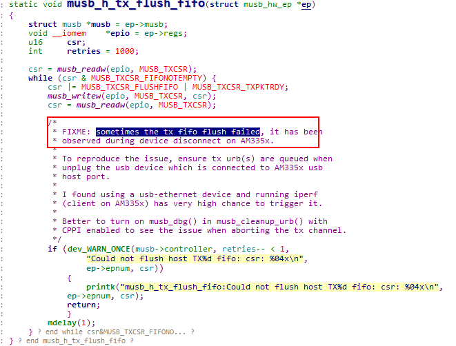

  • Hi Bin
    There is another problem. This is power on/off modules several times. while the module disconnect kernel,it seems that fifo scrubbed falied. Do you  resolve the similar situation? thanks
    [ 455.680616] usb 1-1.1: USB disconnect, device number 20
    [ 456.682886] ------------[ cut here ]------------
    [ 456.687580] WARNING: CPU: 0 PID: 2544 at drivers/usb/musb/musb_host.c:140 musb_h_tx_flush_fifo+0x144/0x148
    [ 456.697282] musb-hdrc musb-hdrc.0: Could not flush host TX10 fifo: csr: 2003
    [ 456.704362] Modules linked in: wfos_state_detect wfos_irda wfos_pwm pwm_omap_dmtimer wfos_temperature wfos_pm wfos_adc wfos_version wfos_esam wfos_led wfos_kbd wfos_lcd wfos_product_info wfos_watchdog wfos_devices
    [ 456.723472] CPU: 0 PID: 2544 Comm: kworker/0:0 Not tainted 4.14.40 #200
    This TX fifo flushing issue should be harmless, we haven't seen it cause any USB functional problem.
    Anyway, please apply the kernel patch attached below to see if it solves the enumeration issue.

    The MUSB driver doesn't handle clearing USB hub TT buffer to recover hub TT failures. The patch I provided was submitted to the Linux kernel community by somebody else some time ago, but got community feedback that the patch is not complete and misses some corner case handlings. But the patch author didn't update the patch so it never got merged into the kernel.
    PIO mode is the non-DMA mode.
