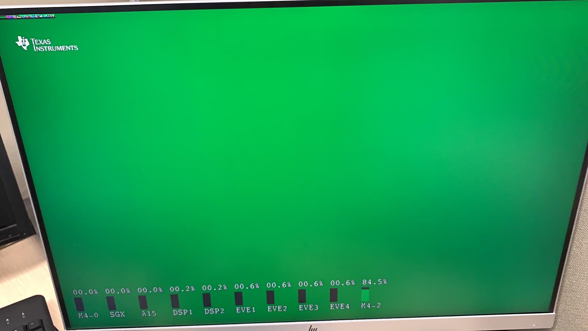

I am trying to porting VSDK_03_07 to my new TDA2x board with four LVDS cameras (Serailizer and Deserializer) input to VIPs. A15 runs Linux and all peripherals connected to I2C bus are configured in Linux, the video signals now can be captured by oscilloscope at the VIP input pins which means input video signals are ready for VIP. I would like to run the VSDK built-in sample codes (usecases), would you please tell me where I should do modifications on current VSDK?

  • Hello Brijesh,
    thanks for your response.
    I am using different camera(ON AP0101+AR0143 YUV422 8bit output) and trying to run TI VSDK 0307 usecases (hlos --> adas --> chains_main_linux_single_cam --> chains_vipSingleCam_SgxDisplay).
    The deserializer and the camera side have already been configured correctly in Linux and  I am pretty sure the video signal from camera is correct.
    now the output on HDMI display screen is shown below, but without camera image.
    but I noticed that on the top left corner, it seems the camera signals shown there, because when I disconnect my camera, the top left corner image stopped.
    would you please suggest what be the next step I should check to get my camera image shown on the screen?

    Can you press 'p' on the console and see if capture is working fine first?

  • Hello Brijesh,
    please check attached for printed performance statistics information.
    thanks.
    Jeffrey Yu

     [HOST] [IPU2  ]    103.557158 s:  CAPTURE: VIP1 Slice0 PortA FRAME MODE
     [HOST] [IPU2  ]    103.557250 s:
     [HOST] [IPU2  ]    103.557311 s:  [ CAPTURE ] Link Statistics,
     [HOST] [IPU2  ]    103.557372 s:  ******************************
     [HOST] [IPU2  ]    103.557433 s:
     [HOST] [IPU2  ]    103.557463 s:  Elapsed time       = 30694 msec
     [HOST] [IPU2  ]    103.557555 s:
     [HOST] [IPU2  ]    103.557585 s:  New data Recv      = 10467.44 fps
     [HOST] [IPU2  ]    103.557677 s:  Get Full Buf Cb    =  13.71 fps
     [HOST] [IPU2  ]    103.557738 s:  Put Empty Buf Cb   =  13.71 fps
     [HOST] [IPU2  ]    103.557860 s:  Driver/Notify Cb   = 10467.44 fps
     [HOST] [IPU2  ]    103.557951 s:
     [HOST] [IPU2  ]    103.557982 s:  Input Statistics,
     [HOST] [IPU2  ]    103.558043 s:
     [HOST] [IPU2  ]    103.558073 s:  CH | In Recv | In Drop | In User Drop | In Process
     [HOST] [IPU2  ]    103.558165 s:     | FPS     | FPS     | FPS          | FPS
     [HOST] [IPU2  ]    103.558256 s:  --------------------------------------------------
     [HOST] [IPU2  ]    103.558317 s:   0 |  41.18      0. 0      0. 0          41.18
     [HOST] [IPU2  ]    103.558470 s:
     [HOST] [IPU2  ]    103.558500 s:  Output Statistics,
     [HOST] [IPU2  ]    103.558561 s:
     [HOST] [IPU2  ]    103.558592 s:  CH | Out | Out     | Out Drop | Out User Drop
     [HOST] [IPU2  ]    103.558683 s:     | ID  | FPS     | FPS      | FPS
     [HOST] [IPU2  ]    103.558775 s:  ---------------------------------------------
     [HOST] [IPU2  ]    103.558866 s:   0 |  0     41.18     0. 0      0. 0
     [HOST] [IPU2  ]    103.559019 s:
     [HOST] [IPU2  ]    103.559080 s:  [VIP1 Slice0 PortA] Statistics
     [HOST] [IPU2  ]    103.559141 s:  ==============================
     [HOST] [IPU2  ]    103.559202 s:  Number of request queued  : 2075
     [HOST] [IPU2  ]    103.559263 s:  Number of request dequeued: 619
     [HOST] [IPU2  ]    103.559354 s:  Overflow Count            : 0
     [HOST] [IPU2  ]    103.559415 s:
     [HOST] [IPU2  ]    103.559446 s:     CH    |     Q      DQ     Total   Top     Bot    Total  Top    Bot   Min/Max     Min/Max   Dropped  Repeat   Fid   Desc
     [HOST] [IPU2  ]    103.559598 s:  (I/S/CH) |   Count   Count  Fields  Fields  Fields   FPS   FPS    FPS    Width       Height   Frames   Frames  Repeat Error
     [HOST] [IPU2  ]    103.559751 s:  ---------------------------------------------------------------------------------------------------------------------------
     [HOST] [IPU2  ]    103.560086 s:   00.0.00 |    2080    2080  524386  524386       0  10425 10425     0     1/124       1/18     522306       0       0     0

  • Hi, Brijesh,
    I have another more questions about VIP.
    In VSDK_03_07,  the VIP in/output default configuration in the function ChainsCommon_SingleCam_SetCapturePrms() in file chains_common.c
       pInprms->dataFormat =   SYSTEM_DF_YUV422P;
       pOutprms->dataFormat    =   SYSTEM_DF_YUV420SP_UV;
    my question:
    1. do I need to configure elsewhere to implement this VIP CSC feature?
    2. why OV10635 camera signals is configured as YUV422P, not YUV422I_UYVY?
    3. If my camera is YUV422I_UYVY, can the VIP be configured as below?
    pInprms->dataFormat =   SYSTEM_DF_YUV422I_UYVY;
  • Hello TI guys,
    any feedback?
    Jeffrey Yu
  • Hi Jeffrey,
    As can be seen from the performance stats. lot of frames are dropped and lot of errornous frames, the frame size is varying from 1 to 128..
    This essentially means, your input signal is not correct. Please correct the input, VIP will be able to capture.
    Rgds,
    Brijesh
  • Hello Brijesh,
    thanks for your support.
    it's solved and working correctly.
    thanks.
    Jeffrey Yu
