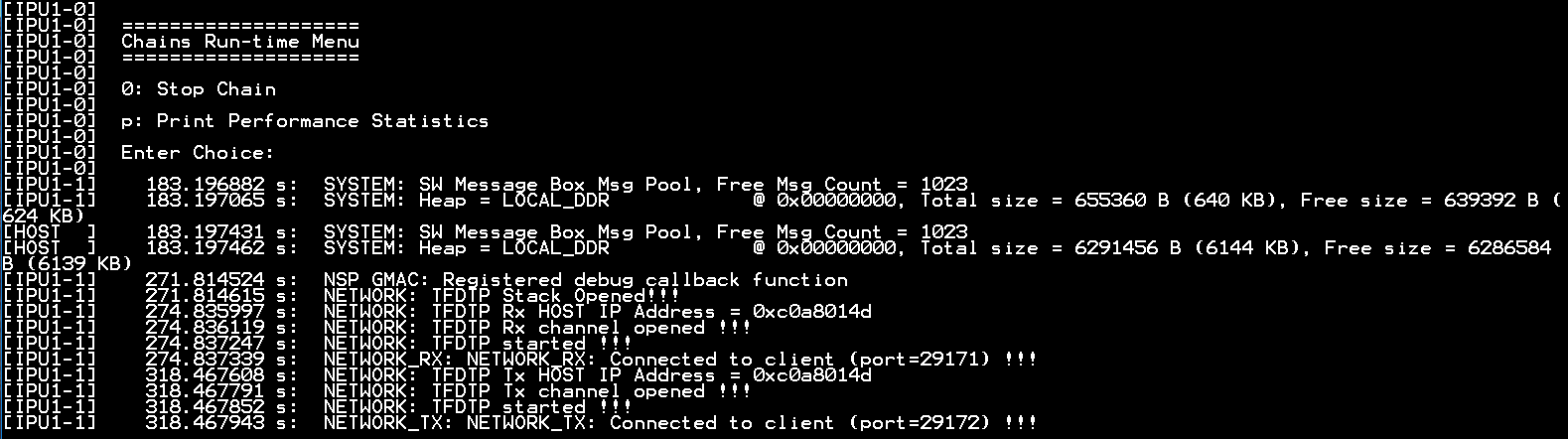

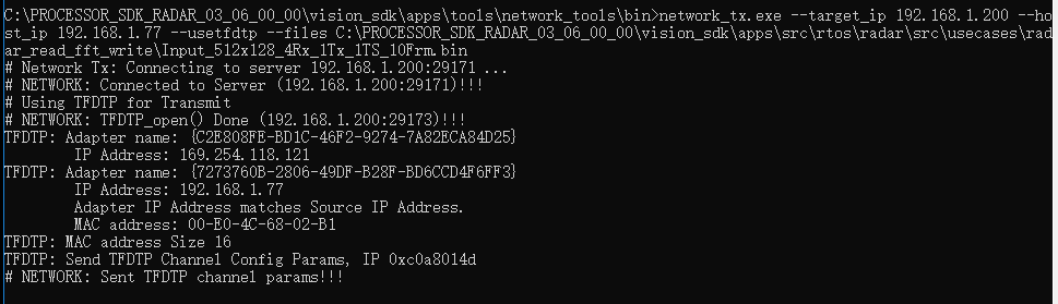

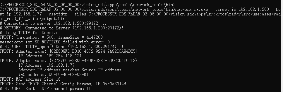

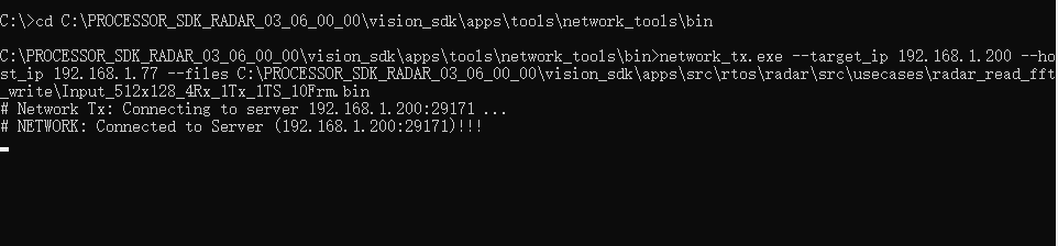

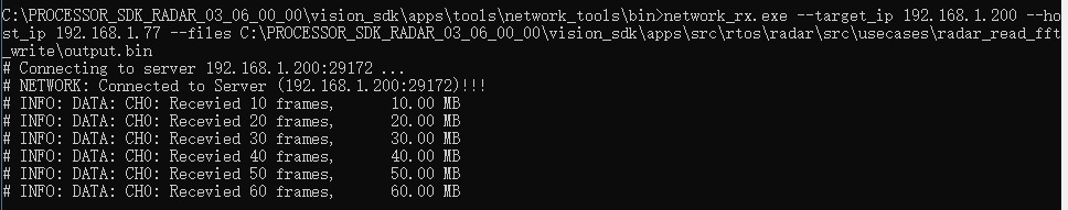

This is using TFDTP to transfer data,
In the tera term displays as follows,
I think it has successfully connected but still cannot transfer data.This is the printed information,
[IPU1-0]    409.634447 s:  ### CPU [IPU1-1], LinkID [ 66],
[IPU1-0]    409.634539 s:
[IPU1-0]    409.634569 s:  [ NETWORK_RX ] Link Statistics,
[IPU1-0]    409.634661 s:  ******************************
[IPU1-0]    409.634722 s:
[IPU1-0]    409.634752 s:  Elapsed time       = 226322 msec
[IPU1-0]    409.634844 s:
[IPU1-0]    409.634905 s:  New data Recv      =   9.87 fps
[IPU1-0]    409.634996 s:  Get Full Buf Cb    =   5.96 fps
[IPU1-0]    409.635088 s:  Put Empty Buf Cb   =   5.96 fps
[IPU1-0]    409.635210 s:  Driver/Notify Cb   =   9.99 fps
[IPU1-0]    409.635271 s:
[IPU1-0]    409.635332 s:  Input Statistics,
[IPU1-0]    409.635362 s:
[IPU1-0]    409.635423 s:  CH | In Recv | In Drop | In User Drop | In Process
[IPU1-0]    409.635515 s:     | FPS     | FPS     | FPS          | FPS
[IPU1-0]    409.635606 s:  --------------------------------------------------
[IPU1-0]    409.635667 s:   0 |   9.87      0. 0      0. 0           5.96
[IPU1-0]    409.635820 s:
[IPU1-0]    409.635850 s:  Output Statistics,
[IPU1-0]    409.635911 s:
[IPU1-0]    409.635942 s:  CH | Out | Out     | Out Drop | Out User Drop
[IPU1-0]    409.636033 s:     | ID  | FPS     | FPS      | FPS
[IPU1-0]    409.636216 s:  ---------------------------------------------
[IPU1-0]    409.636308 s:   0 |  0      5.96     3.91      0. 0
