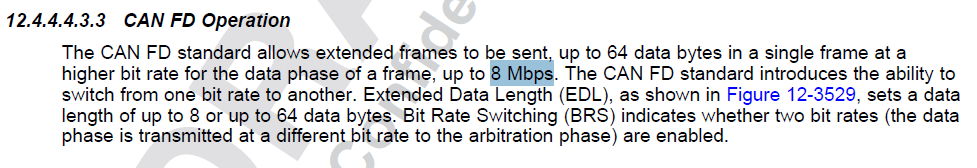

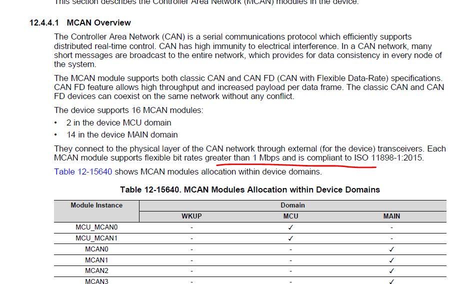

Customer need we provide the CAN interface speed. From TRM just know that MCAN support higher than 1Mbps speed.
TDA2P CAN interface support max 5Mbits/s. (DM 5.9.6.17.2).
Can you tell us TDA4x MCAN support max speed? it is 5Mbps/8Mbps or 10Mbps?
