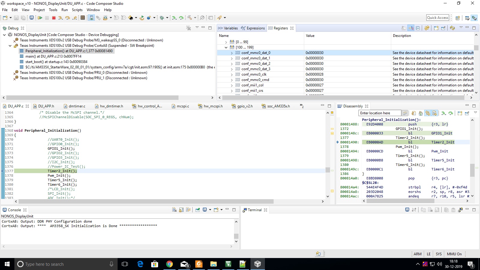

I am doing pinmuxing for F18 (Timer6) and F17 (Timer 5) by control module registers Conf_MMC_DATA2 and Conf_MMC_DATA3 respectively. I am using offset address 0x8f4 and 0x8f0 for these registers but it is writing in Conf_MMC_DATA1 and Conf_MMC_DATA0 respectively. I think offset address are interchanged. Can you check and confirm?

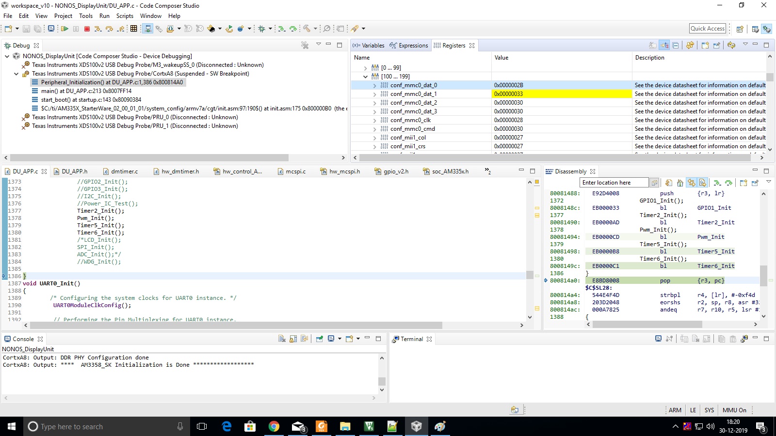

    I checked in debug mode in registers section.
    Gaurav
  • Gaurav,
    Can you provide me a screen shot (print screen) of the registers you are observing?
    Pavel
  • Pavel,
    Please find screenshot.
  • Gaurav,
    Seems that we have error in CCStudio xml file:
    ccs910/ccs/ccs_base/common/targetdb/Modules/am335x/control_module.xml
    <register acronym="conf_mmc0_dat_2" description="See the device datasheet for information on default pin mux configurations. Note that the device ROM may change the default pin mux for certain pins based on the SYSBOOT mode settings." id="conf_mmc0_dat_2" offset="0x8F8" width="32">
    The correct offset for conf_mmc0_dat_2 should be 0x8F4. Check below e2e thread which discuss the same issue:
    https://e2e.ti.com/support/processors/f/791/t/762998
    I will notify the CCS team for this error to be fixed.
