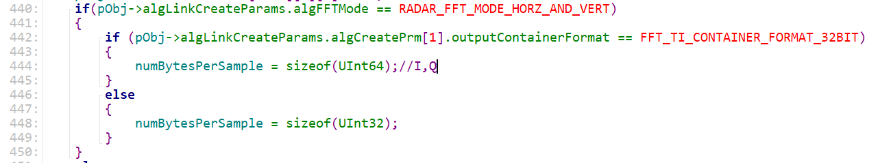

1.Is numBytesPerSample = sizeof UInt64 because it has I and Q two parts?

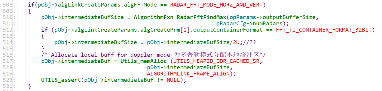

2.Why is pObj-> intermediateBufSize divided by 2?

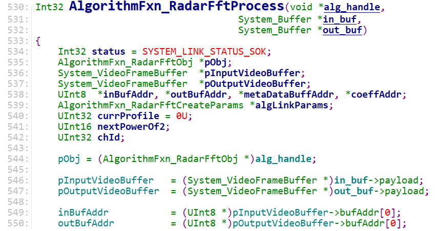

pObj = (AlgorithmFxn_RadarFftObj *) alg_handle;
pInputVideoBuffer = (System_VideoFrameBuffer *) in_buf-> payload;
inBufAddr = (UInt8 *) pInputVideoBuffer-> bufAddr [0];
outBufAddr = (UInt8 *) pOutputVideoBuffer-> bufAddr [0];
Is this a type cast?

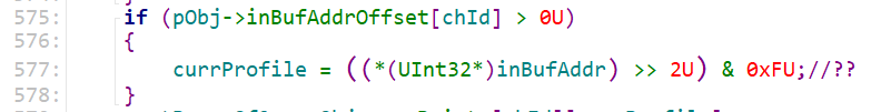

4.How to explain this operation?

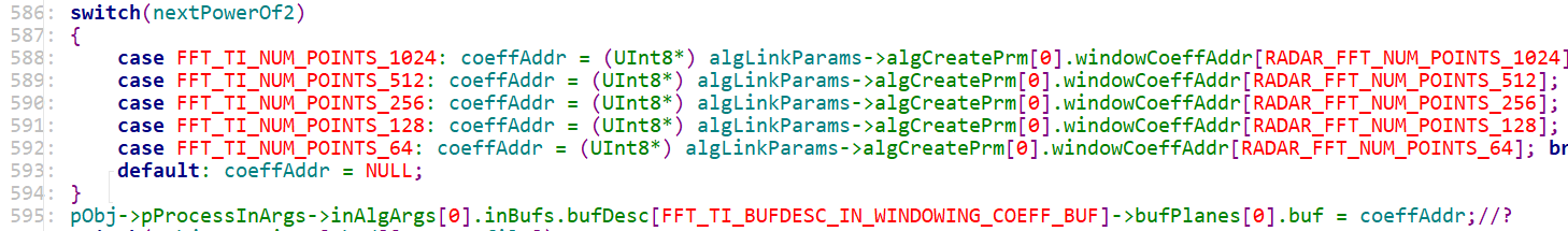

5. FFT_points is selected by nextpowerof2, why does buf point to coeffaddr?
But where is the specific FFT operation performed? This is just select the number of FFT points
    Yes
    3 Is this a type cast?
    yes

  • 2.Why is pObj-> intermediateBufSize divided by 2?
    This is only when the output container format is 32 bits. This is because the intermediate buffer 1D FFT output is 16 bit container (hence factor of 2 (16 bit versus 32 bit). The intermediate buffer size is calculated as per the final output buffer size.
    4. This comes from Chirp Profile format. We put a constraint to find the right profile in advanced frame configuration one must enable the CP data in the AWR12xx for the profile information to be captured.
    Refer: 8 Chirp Parameters (CP) and Chirp Quality (CQ) data in mmwave_dfp_01_02_00_00\docs\AWR1xxx_Radar_Interface_Control.pdf
    5. This Buf is just the windowing coefficients. The actual FFT happens in AlgorithmFxn_RadarFftDoWorkProcess on the EVE.
