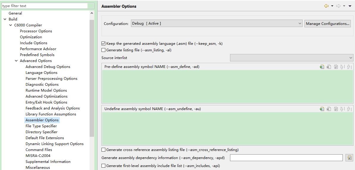

    3.I use the default options for Assebler:(No options added)

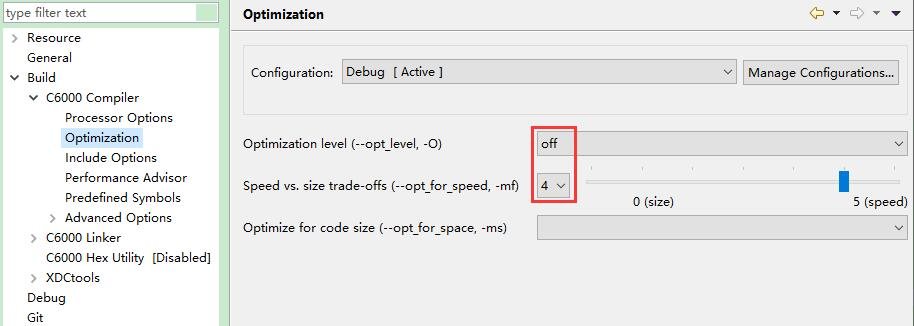

    Optimization Options as below:

  • Why do you have compiler optimization (--opt_level) set to "off"?  I suggest setting to to -o2.
    In my opinion/experience, the "linear assembly" code is not the best way to improve your code.  My recommendation is:
    1. Start by simply using -o2 to see if the performance is sufficient.
    2. If performance is still not good enough, you can use "restrict" keyword as appropriate as well as pragmas like MUST_ITERATE to give the compiler additional info to help it better optimize the code.
    3. Finally if specific instructions are needed (this is especially the case for "packed math" SIMD operations) then you can use compiler intrinsics to directly utilize a specific instruction from C.
    I set compiler optimization to -O2.And the function  iir_2nd_filter() speed increased by more than 60%,so dose the iir_2nd_Assembly().The performance is sufficient.
    Maybe I should give up linear assembly.
