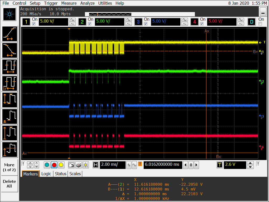

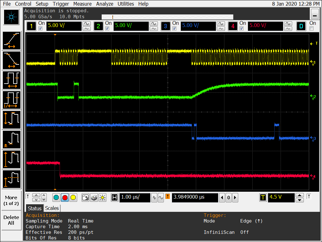

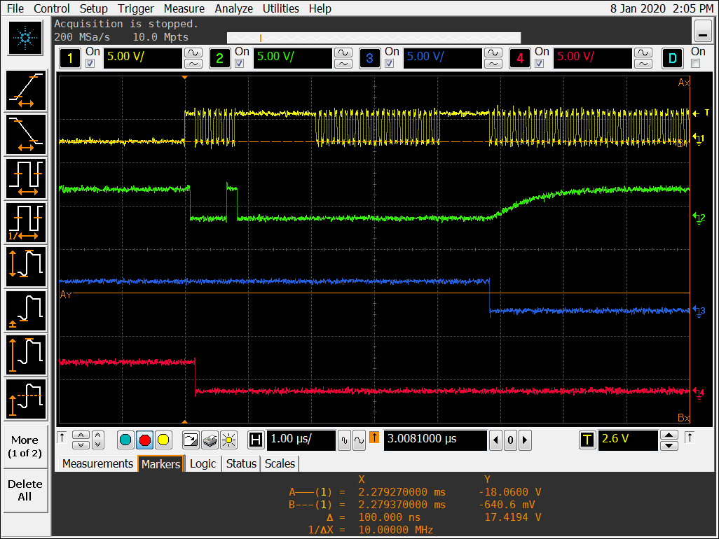

My customer is having some problem with QSPI_1 boot.
For normal boot, which can successfully boot to APP image, the waveform looks like below:
(the YELLOW line shows when their IPL starts to run -- toggle a GPIO first, the MOSI-label is actually the MISO)

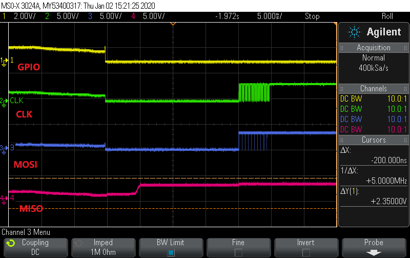

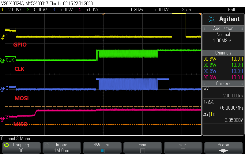

When QSPI_1 boot fails, the waveform looks like below:
Please kindly share some comments:
1. does the successfully-boot waveform look normal?
Why are there two duration of clocks? The first is with higher amplitude (low DC offset), the second is with lower amplitude (higher offset).
2. does the failure-boot waveform look normal?
It looks like there is a retry mechanism.
any questions or comments are welcome!
