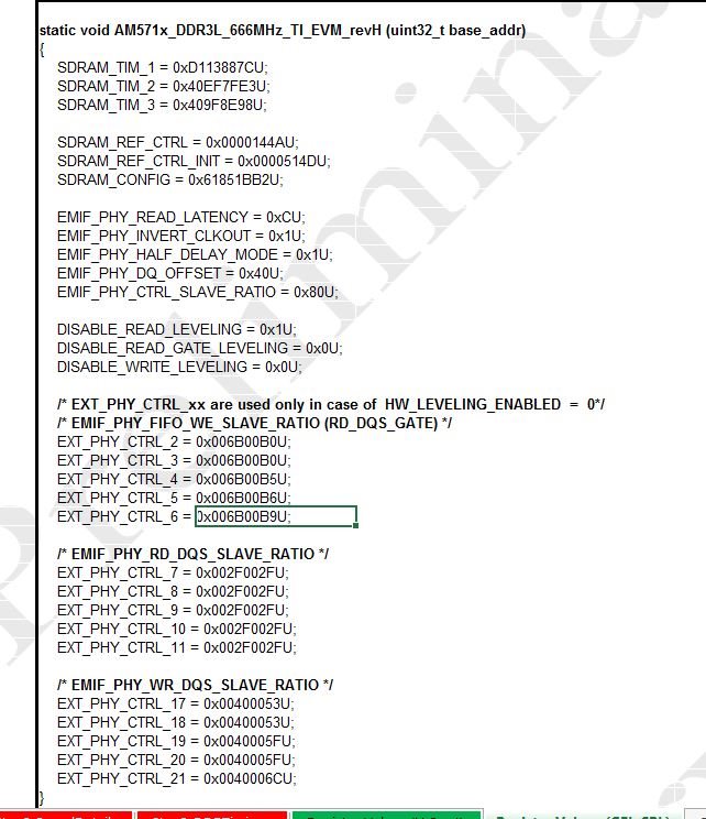

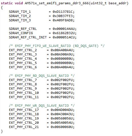

But the register values generated by the tool is different from what is there in GEL file .
1. Why this difference??
Screen shot of register values in GEL file
Screen shot of register values generated by EMIF tool

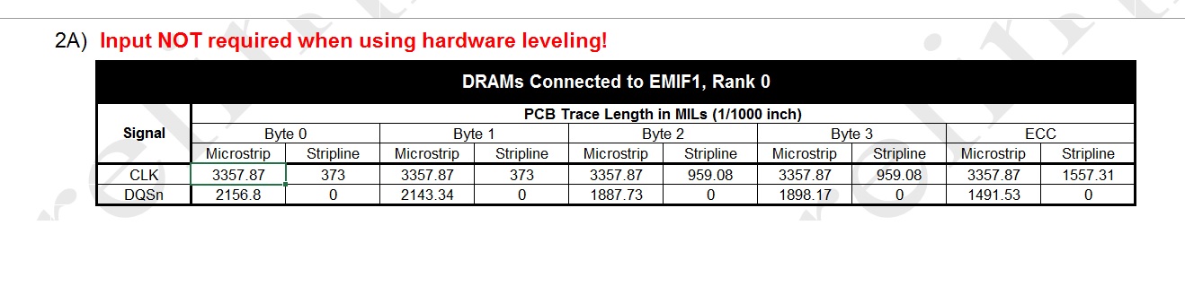

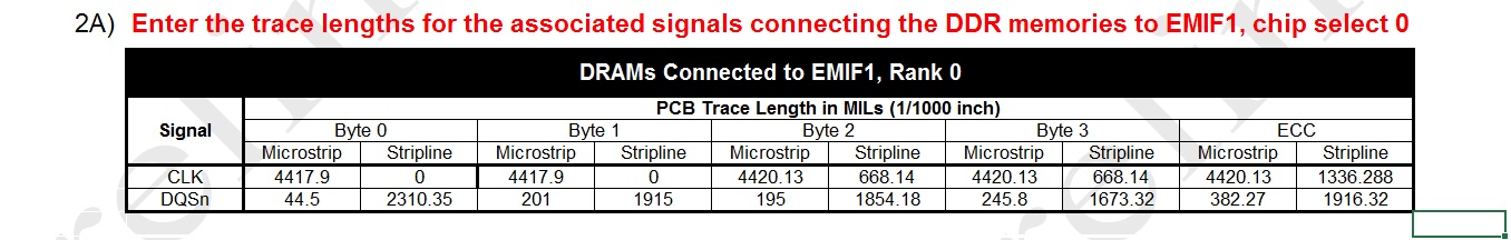

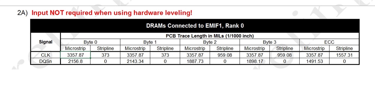

Screen shot of trace details auto filled by tool
2. Is this correct with respect to AM5718 EVM?? i will also cross check with *.brd file.

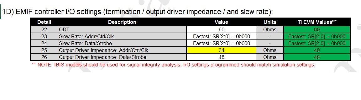

3. Also output impedance while loading AM571x config was shown as 34Ohms. Do I need to change it??
