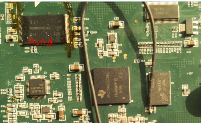

Hi,Engineers:
    This is not my first time using AM3354, so this error is not so common。My hardware is AM3354+TPS65910A1A3+MT41K256M16TW-107(DDR3)+ MT29F8G08ABACAWP(nand flash)。 Power is up. If no any system in SD(mmc1) or nand flash (mmc2), uaually AM3354 uart will keep printing “c” . However, my AM3354 stopped printing 'c' after 15 'c' were printed. That's the problem I cann't resolve.
    I emphasize there is no system in SD or nand flash, because system and the PCB will work well if system exists .No matter system starts working from SD(mmc1) or nand (mmc2).After all, Usually after printing 5 "c", the system is started.
    There is another phenomenon. I know finding system starting position and printing "c" in the uart are the Inherent function of AM3354. But when I removed the nand from the PCB,the "c" could be keeping print as normal.Just like the problem is disappered. The nand I removed is empty .No any data is in it.
    But my products can not work well without nand flash.Haha.
