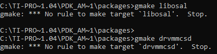

I want to build diag examples in pdk. But it prompts that there are some libs cannot be found.
arm-none-eabi-gcc.exe: error: /TI-PRO~1.04/PDK_AM~1/packages/ti/board/lib/skAM335x/a8/release/ti.board.aa8fg: No such file or directory
arm-none-eabi-gcc.exe: error: /TI-PRO~1.04/PDK_AM~1/packages/ti/osal/lib/nonos/am335x/a8/release/ti.osal.aa8fg: No such file or directory
arm-none-eabi-gcc.exe: error: /TI-PRO~1.04/PDK_AM~1/packages/ti/drv/mmcsd/lib/a8/release/ti.drv.mmcsd.aa8fg: No such file or directory
arm-none-eabi-gcc.exe: error: /TI-PRO~1.04/PDK_AM~1/packages/ti/fs/fatfs/lib/a8/release/ti.fs.fatfs.aa8fg: No such file or directory
arm-none-eabi-gcc.exe: error: /TI-PRO~1.04/PDK_AM~1/packages/ti/drv/uart/lib/am335x/a8/release/ti.drv.uart.aa8fg: No such file or directory
arm-none-eabi-gcc.exe: error: /TI-PRO~1.04/PDK_AM~1/packages/ti/drv/i2c/lib/am335x/a8/release/ti.drv.i2c.aa8fg: No such file or directory
arm-none-eabi-gcc.exe: error: /TI-PRO~1.04/PDK_AM~1/packages/ti/csl/lib/am335x/a8/release/ti.csl.aa8fg: No such file or directory
I execute gmake board_lib and i can build ti.board.aa8fg successfully. What about the other libs?
