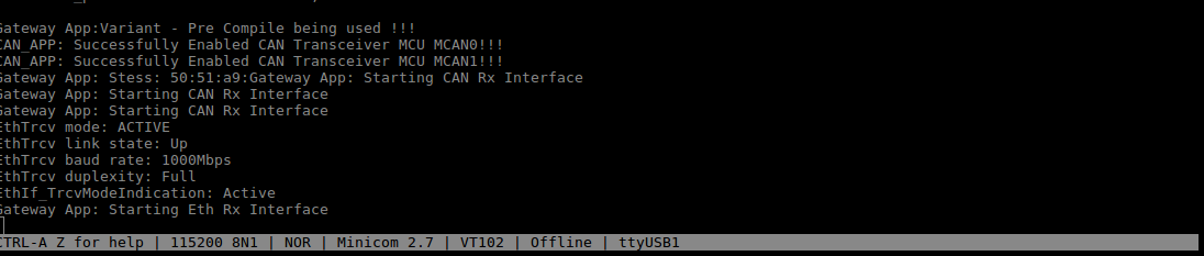

I am trying to launch "Gateway Demos" and the MCU logs only show
Gateway App:Variant - Pre Compile being used !!!
Gateway App: CanApp_Startup
CAN_APP: Successfully Enabled CAN Transceiver MCU MCAN0!!!
CAN_APP: Successfully Enabled CAN Transceiver MCU MCAN1!!!
GatePort 1 Address: 50:51:a9:Gateway App: Starting CAN Rx Interface
I don not see any of the EthTrcv messages and the test result of CAN to ethernet is failed.
In the documents of "4.1.2 CAN to ethernet Gateway demo",
I should see the logs as below:
Is there any suggestion to check the problem?

    If I using CCS to launch "Gateway Demos", the function will work great.
    However the MCU will active ethernet failed while booting up from SD card.
