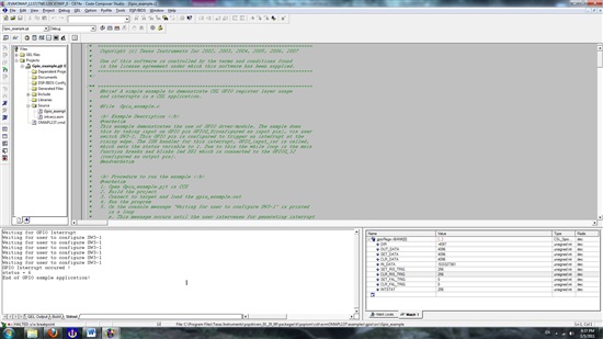

I have a couple of questions about L137 GPIO interrupt. I'm using L137 example cSLR\GPIO code, installed at default directory.
C:\Program Files\Texas Instruments\pspdrivers_01_20_00\packages\ti\pspiom\cslr\evmOMAPL137\examples\gpio
My questions are:
1.  I cannot write a value to GPIO registers, such as gpioRegs->BANK[0].CLR_FAL_TRIG, in either the program or watch window.
2.  Why SET_RIS_TRIG and CLR_RIS_TRIG have the same value?  Should they cancel each other settings (i.e. no interrupt can be acknowledged)?  But in fact, the interrupt was acknowledged.
3.  Why "status" value becomes 6, instead of 1, when the ISR was executed?  I toggled the SW3 position-1 switch only once.  Status should increment by only 1 if the ISR is executed only once.
4.  I cannot clear INTSTAT register in the watch window.  I tried 3 approaches:  1) reload the .out file; 2)Debug->CPU reset; 3)Write 0 to INTSTAT.  None of them works.
Thank you for your suggestions in advance !
Below are my "Gpio_example.c" code and an output snapshot:

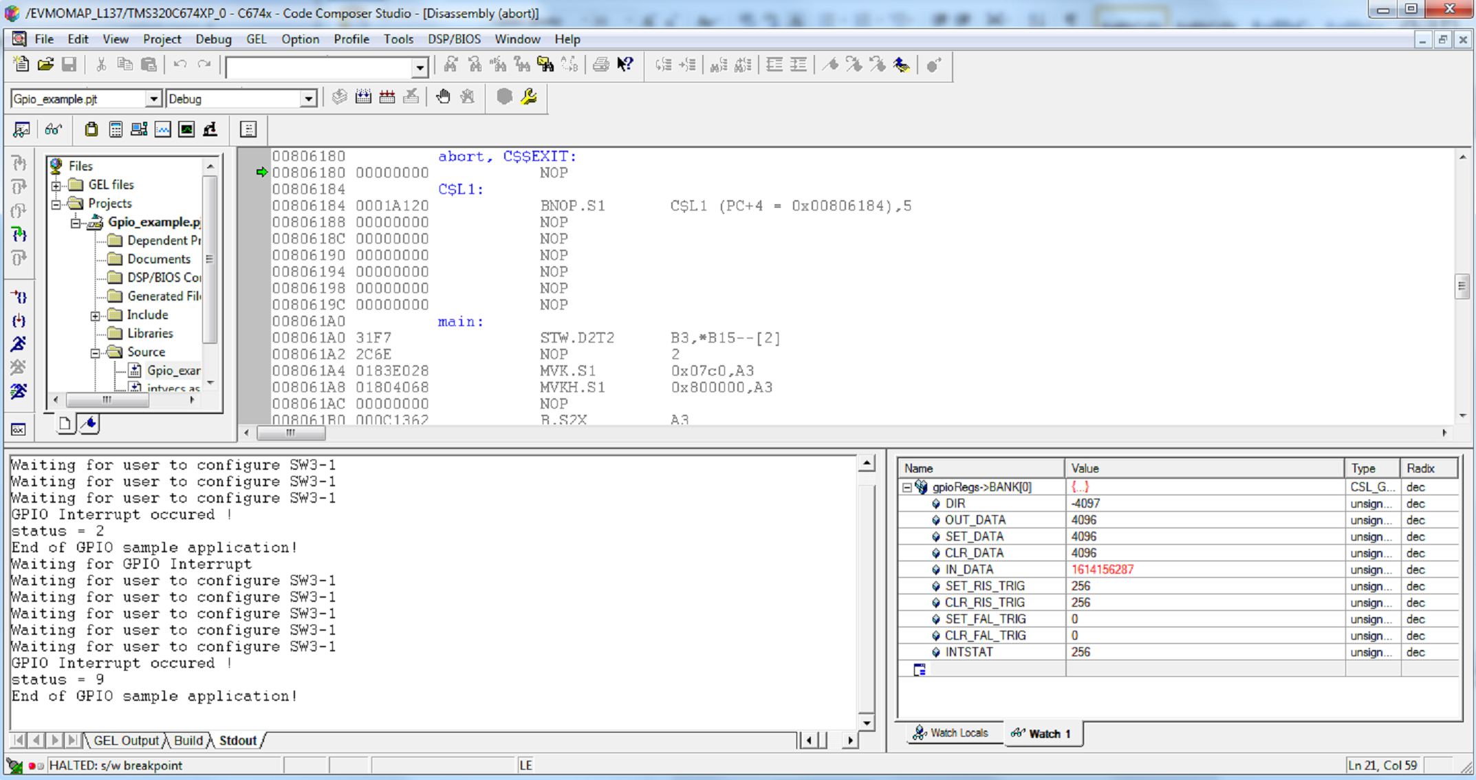

    Please see Table 13 and Table 10 of GPIO user guide (http://focus.ti.com/lit/ug/sprufl8b/sprufl8b.pdf) for the description on these registers and the behaviour that you are seeing.
    Can you please provide a bigger snaopshot of the output window (which prints the messages). That will help understand the flow.
    Please see Table 14 of GPIO user guide. INTSTAT are R/W1C. Write 1 to clear the status bit, a write 0 has no effect.
    Gaurav
  • Normal 0 false false false EN-US ZH-CN X-NONE
    Gaurav, thank you for your response. With Table 10, I now understand why SET_RIS_TRIG and CLR_RIS_TRIG read the same values.  However, I still have issues with the rest questions:
    1.       I still cannot access CLR_FAL_TRIG or SET_FAL_TRIG registers.  Please see below attached code where I try to set SET_FAL_TRIG register.  However, from the snapshot you can see both CLR_FAL_TRIG and SET_FAL_TRIG read zeros.
    2.       In my last post, the code was trying to set CLR_FAL_TRIG.  But either yesterday and today’s codes can always acknowledge interrupts at both rising and falling edges (i.e., I get an interrupt when I toggle the position-1 SW3 to either directions, either 1 -> 8 or 8 -> 1).  Could you please run my code on your PC with the L137 EVM board to see if you may get the same problem?
    3.       Regarding INTSTAT register, sorry I didn’t explain clearly in my last post. I noticed it’s a W1C register.  I did write 1 to it in Watch Window but it didn’t change its value.
    4.       I post a bigger snapshot here hopefully to better show the running results of the variable "Status".
    Thank you for the help !

    void gpioExample(void)
        Uint32  ledBlinkCount = 0;
        volatile Uint32 temp = 0;
        volatile Uint32 pscTimeoutCount = 10240u;
        /* Key to be written to enable the pin mux registers for write            */
        sysRegs->KICK0R = 0x83e70b13;
        sysRegs->KICK1R = 0x95A4F1E0;
        /* mux between EMA_D8 and GPIO0_8 : enable GPIO0_8 (User Switch - "SW3-1")*/
        sysRegs->PINMUX14 = ( (CSL_SYSCFG_PINMUX14_PINMUX14_27_24_GPIO0_8) << \
                            (CSL_SYSCFG_PINMUX14_PINMUX14_27_24_SHIFT) );
        /* mux between EMA_D12 and GPIO0_12 : enable GPIO0_12 (User Led - "DS1")  */
        sysRegs->PINMUX15 = ( (CSL_SYSCFG_PINMUX15_PINMUX15_11_8_GPIO0_12) << \
                            (CSL_SYSCFG_PINMUX15_PINMUX15_11_8_SHIFT)  );
        /* lock the pinmux registers                                              */
        sysRegs->KICK0R = 0x00000000;
        sysRegs->KICK1R = 0x00000000;
      /* Bring the GPIO module out of sleep state                                 */
      /* Configure the GPIO Module to Enable state */
      psc1Regs->MDCTL[CSL_PSC_GPIO] =
                                  ( (psc1Regs->MDCTL[CSL_PSC_GPIO] & 0xFFFFFFE0) | \
                                     CSL_PSC_MDSTAT_STATE_ENABLE );
      /* Kick start the Enable Command */
      temp = psc1Regs->PTCMD;
      temp = ( (temp & CSL_PSC_PTCMD_GO0_MASK) |
               (CSL_PSC_PTCMD_GO0_SET << CSL_PSC_PTCMD_GO0_SHIFT) );
      psc1Regs->PTCMD |= temp;
      /*Wait for the power state transition to occur */
      while ( ((psc1Regs->PTSTAT & (CSL_PSC_PTSTAT_GOSTAT0_IN_TRANSITION)) != 0)
                         && (pscTimeoutCount>0) )
          pscTimeoutCount--;
      /* Check if PSC state transition timed out */
      if(pscTimeoutCount == 0)
          printf("GPIO PSC transition to ON state timed out\n");
          return;
      /* Wait for MODSTAT = ENABLE/DISABLE from LPSC */
      while( ((psc1Regs->MDSTAT[CSL_PSC_GPIO] & (CSL_PSC_MDSTAT_STATE_MASK))
                    != CSL_PSC_MDSTAT_STATE_ENABLE) && (pscTimeoutCount>0))
          pscTimeoutCount--;
      /* If timeout, the resource may not be functioning */
      if (0 == pscTimeoutCount)
         printf("GPIO Module Enable timed out\n");
         return;
      /* Configure GPIO0_12 (GPIO0_12_PIN) as an output */
      gpioRegs->BANK[0].DIR &= ~(CSL_GPIO_DIR_DIR_IN << CSL_GPIO_DIR_DIR12_SHIFT);
      /* Configure GPIO0_8 (GPIO0_8_PIN) as an input */
      temp = gpioRegs->BANK[0].DIR;
      temp = ( (temp & CSL_GPIO_DIR_DIR8_MASK) |
                          (CSL_GPIO_DIR_DIR_IN << CSL_GPIO_DIR_DIR8_SHIFT) );
      gpioRegs->BANK[0].DIR |= temp;
      /* Set Data high in SET_DATA register for GPIO(GPIO0_12_PIN).                *
       * This turns the LED off -see schematic                                    */
      temp = gpioRegs->BANK[0].SET_DATA;
      temp = ( (temp & CSL_GPIO_SET_DATA_SET12_MASK) |
                (CSL_GPIO_SET_DATA_SET_SET << CSL_GPIO_SET_DATA_SET12_SHIFT));
      gpioRegs->BANK[0].SET_DATA |= temp;
      /* Enable GPIO Bank interrupt for bank 0                                    */
      temp = gpioRegs->BINTEN;
      temp = ( (temp & CSL_GPIO_BINTEN_EN0_MASK) |
                        (CSL_GPIO_BINTEN_EN0_ENABLE << CSL_GPIO_BINTEN_EN0_SHIFT) );
      gpioRegs->BINTEN |= temp;
      /* Configure GPIO(GPIO0_8_PIN) to generate interrupt on rising edge         */
      temp = gpioRegs->BANK[0].SET_RIS_TRIG;
      temp = ( (temp & CSL_GPIO_SET_RIS_TRIG_SETRIS8_MASK) |
                (CSL_GPIO_SET_RIS_TRIG_SETRIS_ENABLE << CSL_GPIO_SET_RIS_TRIG_SETRIS8_SHIFT) );
      gpioRegs->BANK[0].SET_RIS_TRIG |= temp;
        temp = gpioRegs->BANK[0].SET_FAL_TRIG;
          temp = ( (temp & CSL_GPIO_SET_FAL_TRIG_SETFAL8_MASK) |
                (CSL_GPIO_SET_FAL_TRIG_SETFAL_ENABLE << CSL_GPIO_SET_FAL_TRIG_SETFAL8_SHIFT) );
          gpioRegs->BANK[0].CLR_FAL_TRIG |= temp;
        /* map GPIO bank 0 event to cpu int4                                      */
        CSL_FINS(intcRegs->INTMUX1, INTC_INTMUX1_INTSEL4,GPIO0_EVENT);
        /* set ISTP to point to the vector table address                          */
        ISTP = (unsigned int)intcVectorTable;
        /* clear all interrupts, bits 4 thru 15                                   */
        ICR = 0xFFF0;
        /* enable the bits for non maskable interrupt and CPUINT4                 */
        IER = 0x12;
        /* enable interrupts, set GIE bit                                         */
        _enable_interrupts();
        printf("Waiting for GPIO Interrupt\n");
        status = 0;
        while(status == 0)
            printf("Waiting for user to configure SW3-1\n");
            delay(5000);
        printf("GPIO Interrupt occured !\n");
        printf("status = %ld\n", status);
        _disable_interrupts();
        while (ledBlinkCount++ < MAX_BLINK)
            /* Make the GPIO pin (GPIO0_12_PIN) conected to the LED to low. *
             * This turns on the LED - see schematic         */
            temp = gpioRegs->BANK[0].CLR_DATA;
            temp = ( (temp & CSL_GPIO_CLR_DATA_CLR12_MASK) |
                 (CSL_GPIO_CLR_DATA_CLR_CLR << CSL_GPIO_CLR_DATA_CLR12_SHIFT) );
            gpioRegs->BANK[0].CLR_DATA |= temp;
            delay(2000);
            /* Make the GPIO pin (GPIO0_12_PIN) conected to the LED to high *
             * This turns the off the LED - see schematic    */
                 (CSL_GPIO_SET_DATA_SET_SET << CSL_GPIO_SET_DATA_SET12_SHIFT) );
            delay(2000);
        printf("End of GPIO sample application!\n");
