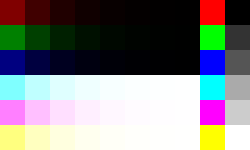

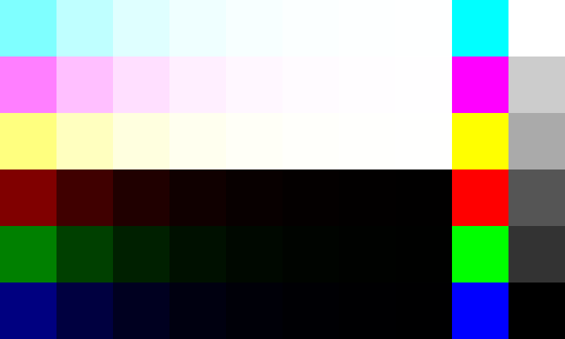

  • By colour inversion, i meant pixel bits are getting inverted
    eg. If red colour is 11111100, it is getting inverted to 00000011
    Kindly let us know how we can solve this issue.
  • Hi Sanil,
    To see the bit inversion, is a frame being read from memory/file?
    If so is the frame being read on the J6 side before being posted to display, or is being read on the display side?
    Or is the inversion being inferred from what is seen on the display?
    kb
  • Yes, the inversion is inferred from what is see on display.
    I have these 2 image files -- mfg-patternpng and mfg-pattern-inv
    When we run display_img application --> display_img -file=/usr/images/mfg-patternpng -display=1 we get on display the mfg-pattern-inv image( i.e. inverted mfg-patternpng image ) and vise versa
  • Hi Sanil,
    It could be that the pixel clock settings between the display and J6 are not matching.
    On the J6 side, the DSS module has a DISPC_POL_REQx register in which the IPC bitfield can be set to configure rising edge versus falling edge.  This setting can be compared against the display specifications.  Please see TRM for further details.
    The QNX screen APIs likely have an option for this field, or the bitfield can be modified on a direct register access.   As per TRM description the CTRL_CORE_SMA_SW_1[19]DSS_CH0_IPC must be set to match.
