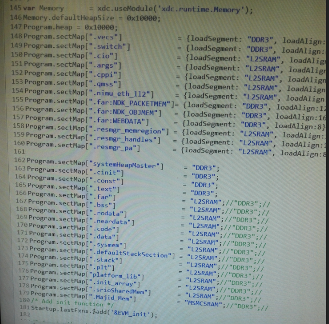

    My problem solved by decelerating new memory sections and segments:
    I allocate the memory segments as below:
    My memory map is as below:
    Now I have a strange problem, In my board FPGA communicate with DSP by SRIO, I implemented my architecture as below:
    1)I dedicate "MSMCSRAM_Reserve" section for writing FPGA via SRIO.

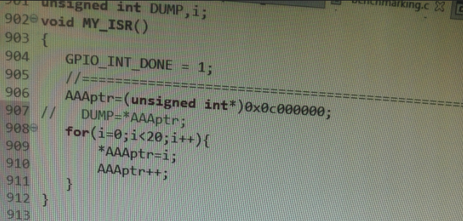

    When I write in the "MSMCSRAM_Reserve" in my ISR as below:
    SRIO works correctly, I check the :0x0C000000" in the memory browser, I see that the memory update correctly.

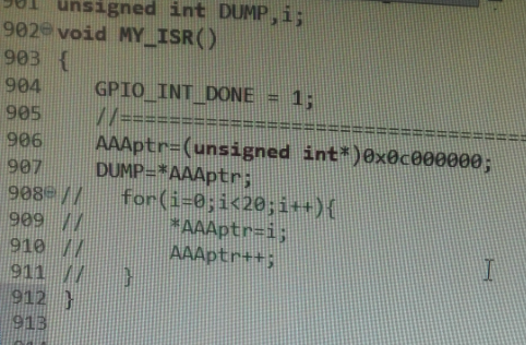

    But when I read from "MSMCSRAM_Reserve" in my ISR even one word as below:
    I see that SRIO stopped(I check the :0x0C000000" in the memory browser and the memory didn't update).
    I checked the signals of SRIO IP CORE in FPGA side and it seems correct, so I think there is some problem in DSP side.

    You declared a region in MSMC and this MSMC is cached into L1D. Now the FPGA writes the data into MSMC via SRIO, and you read it by CPU. The memory is not synced. The SRIO writes into the MSMC physical memory but CPU reads from the cache. You need do a cache invalidate before CPU read, inside your ISR,

    I am not sure about the HPI interface on C64x+, is it a master? In c6678, SRIO is a master. You can look at the memory region 0x0c00_0000 at CCS memory window with physical view or L1D, L2 cache checked/unchecked to determine what inside MSMC and what inside the cache, to see if this is the problem.
    If it is determined cache issue, you need to invalidate the length of the data.
    Some code example: you can refer to C6678 PDK package \ti\drv\pcie\example\sample\src\pcie_sample.c: cache_invalidate().
