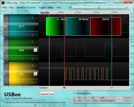

  • After adjusting my logic analyzer sweep time, I discovered that there actually *is* data & clock on the lines. However, the screenshot below is triggered by the initilization of ICMDR during this step in the code
    MikeH said:
    // configure i2c for master transmit mode and release from reset.
    i2c->ICMDR = STT | MST | ICMDR_FREE | TRX | IRS;
    Here is the logic analyzer capture during the above step.
    After this step both SDA and SCL stay low for the duration of my capture buffer. The clock cycles are intermittently either 250ns or 500ns, not anywhere near 400khz.
    Any thoughts?
    Thx
    MikeH

  • The issue may be that the I2C module clock is running too fast. Did you enable the PLL before running the test, or are you running in bypass mode? If you are in bypass mode, I2C1 is running off Ref_CLK/4. Check the I2C1 Prescaler Register (ICPSC) and make sure the divider programmed will get you 400KHz.
    The reason you see the clock frequency changing is probably due to the sample rate of your scope not being fast enough.
    Jeff

  • That code assumes you are in PLL bypass mode with a 24MHz crystal:
    I2C1 is on SYSCLK4, so 24MHz/4 = 6MHz
    IPSC is 2, so 6MHz/3 = 2MHz
    ICCLKL and ICCLKH are 5, so 2MHz/5 = 400KHz
    If you have a GEL file loaded, it may be turning on the device PLL which means that SYSCLK4 will be much higher than 6MHz. Check the PLL0 configuration registers in to make sure it is in bypass mode for this test.
    Jeff

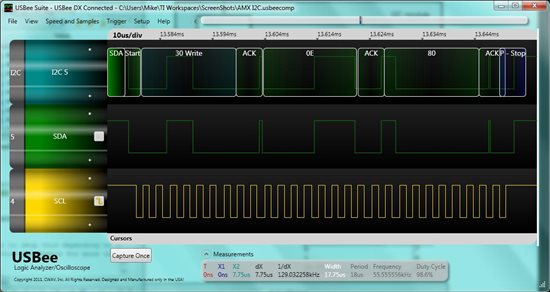

  • BINGO Dude!! Check it out!
    Brilliant deduction. Thanks for your help!
    MikeH
