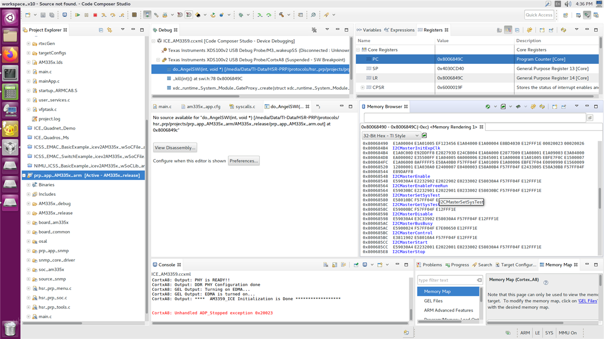

I am trying to run default prp app with to rtos, whenever i tried to execute tx/rx, rx is hang below erro msg
"CortxA8: Unhandled ADP_Stopped exception 0x20023"
and No source available for "do_AngelSWI(int, void *) [/media/Data/TI-Data/HSR-PRP/protocols/hsr_prp/projects/prp_app_AM335x_arm/AM335x_release/prp_app_AM335x_arm.out] at 0x8006849c"
and Can't find a source file at "/home/xlibrary/trees/gnu/gnu-e02/src/linaro/gcc-arm-none-eabi-6-2017-q1-update/src/newlib/libgloss/arm/swi.h"  Locate the file or edit the source lookup path to include its location.
and No source available for "xdc_runtime_System_Module_GateProxy_create(struct xdc_runtime_System_Module_GateProxy_Params *, struct xdc_runtime_Error_Block *) [/media/Data/TI-Data/HSR-PRP/protocols/hsr_prp/projects/prp_app_AM335x_arm/AM335x_release/prp_app_AM335x_arm.out] at 0x0"
Please let me know what is the issue.

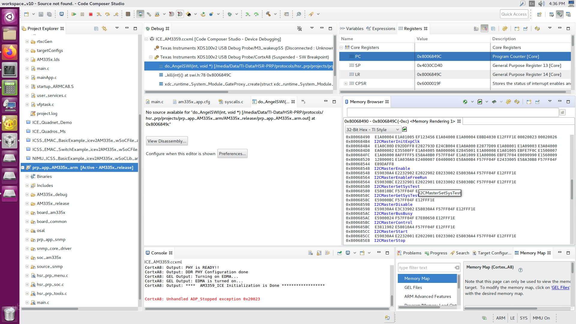

  • Hi Garrett,
    I have attached ccs screenshot of error msg when i tried to rx in prp app.
    Pankaj

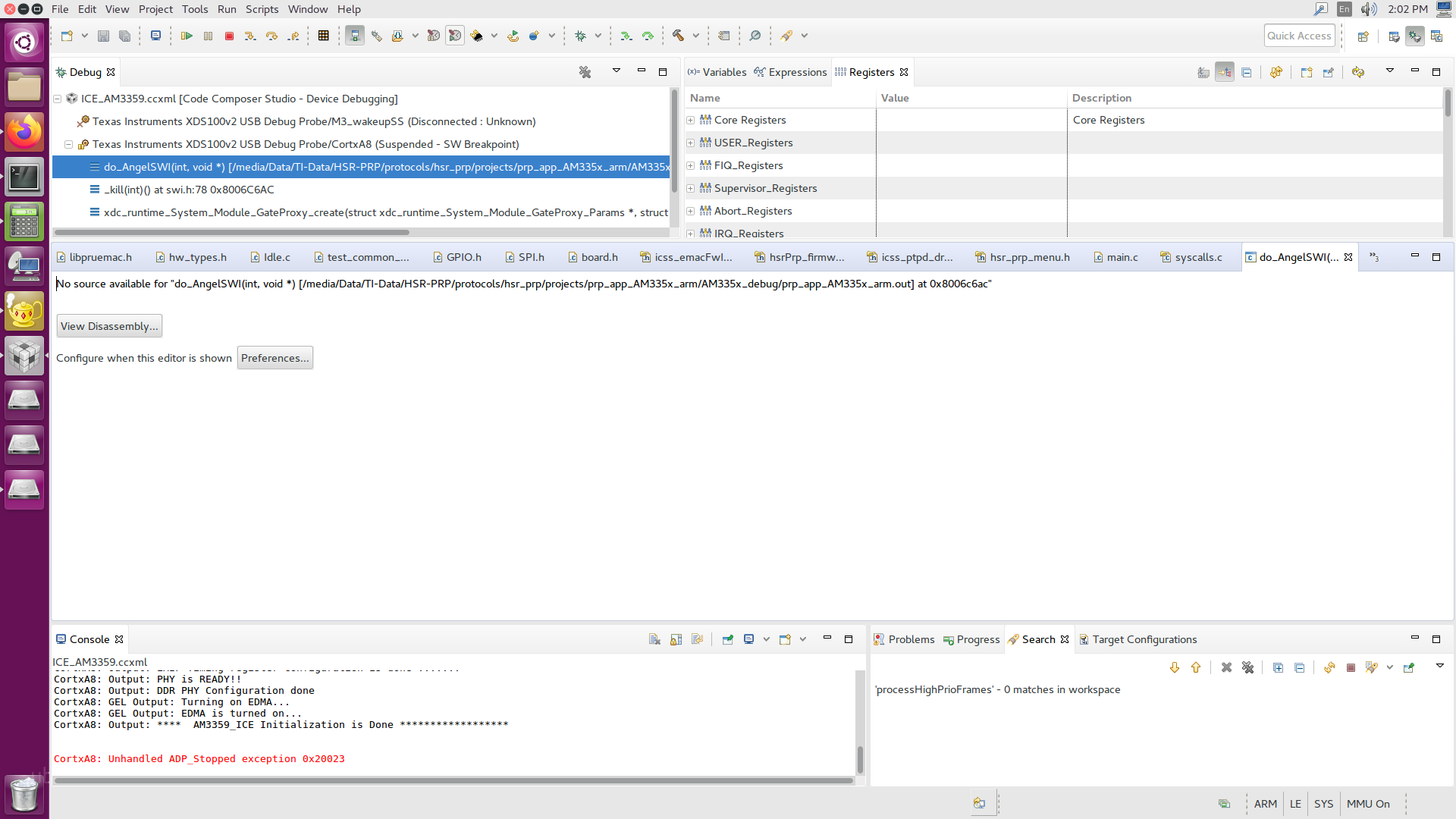

  • Please find attached screenshot of function call stack , when exception happen. (I am using ccs 9.1)
  • I am out of office today, but don't recall any crash issue with the application. Can you try the pre-built binaries to see if it works?

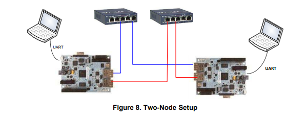

  • Pankaj,
    Can you draw a diagram to show how the ports of ICEs connects to switches?
    Garrett
  • Garrett,
    Below is the diagram.
    Note :- Switches are not connected to any network.One board is used for TX and another one is used for RX.

  • Pankaj,
    Did you update the IP address for the devices? e.g. assign IDK #1 IP address”: 192.168.1.10, IDK #2 IP address:192.168.1.11.
    Press key “R” to run Tx/Rx test, then configure an IDKs as receiver by entering “r” and another IDK as transmit by entering “t”...
    Garrett
  • HI Garrett,
    Yes I have updated IP address of both the port, I am doing rx and tx. but when I tx , rx got the error, as mention in screenshot.
