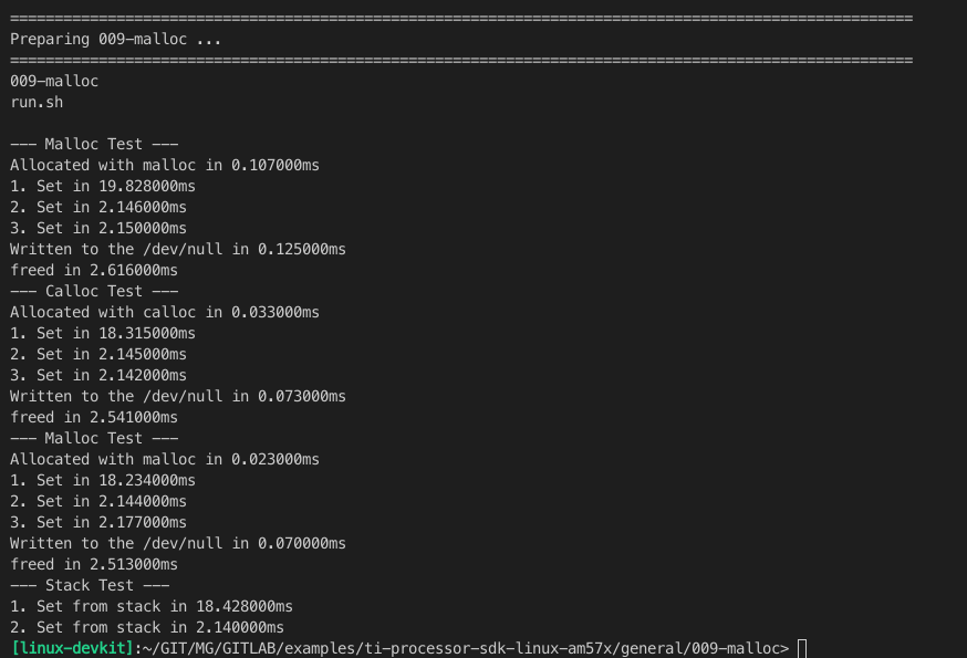

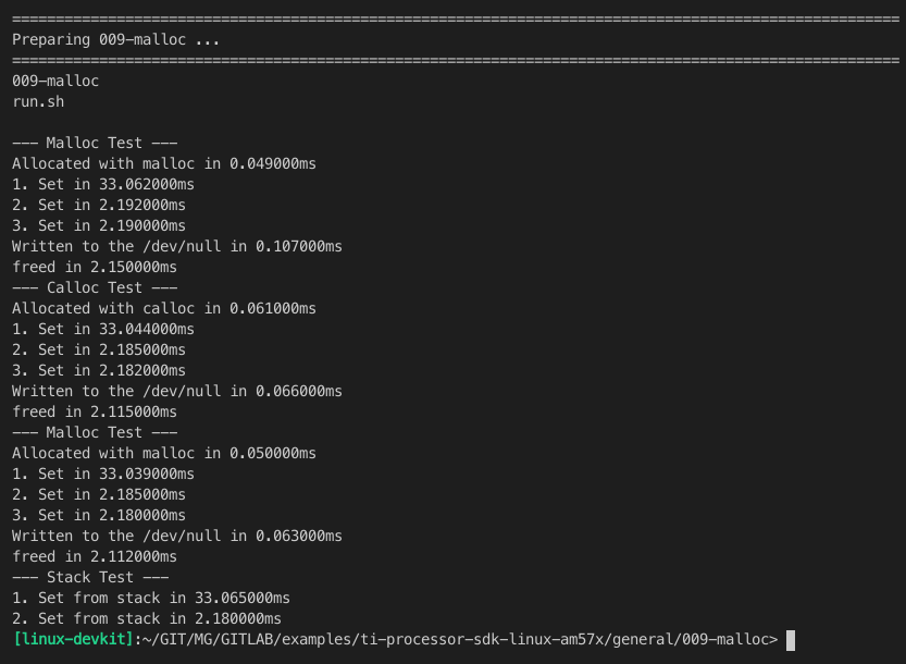

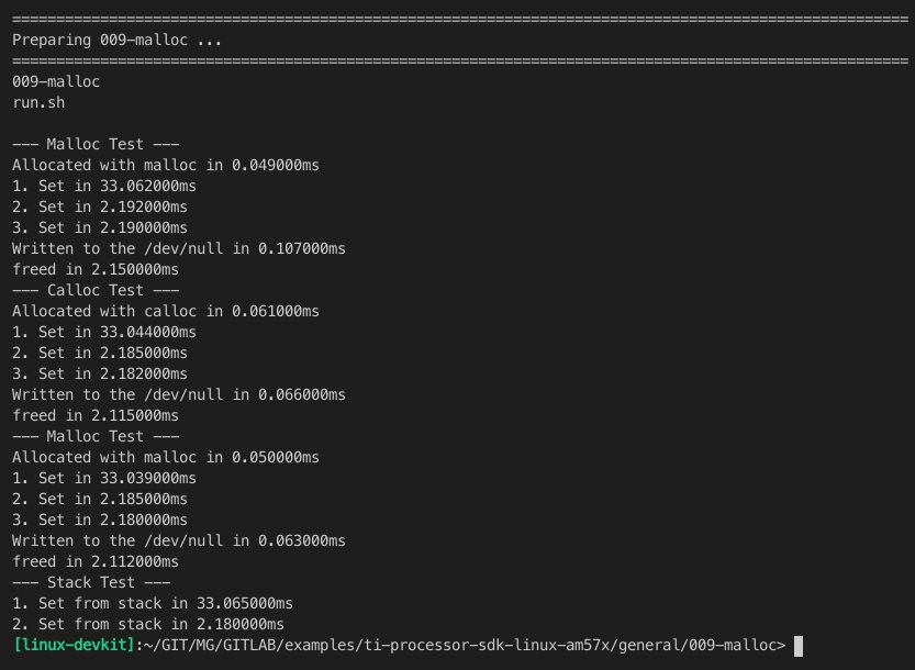

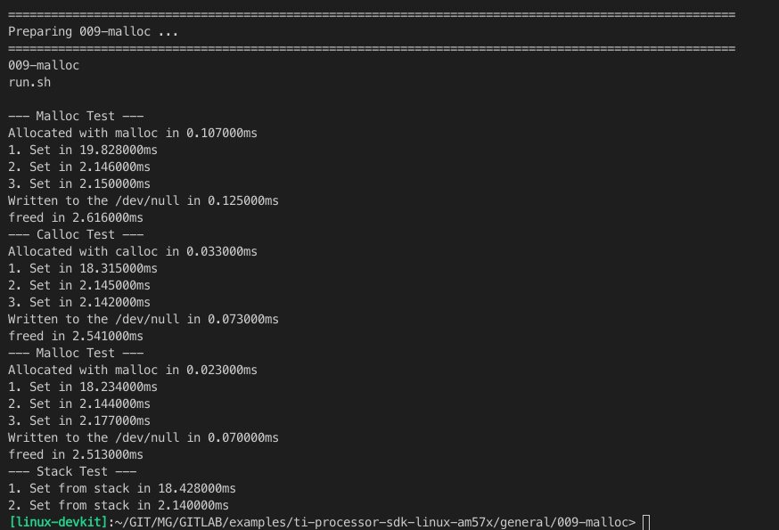

The results with SDK3:
The results with SDK6:
I appreciate it if we could solve this performance issue.

  • Hello and thanks for your post.
    Could you please share more details on what you are seeing that caused you to believe there is a performance difference between the two?
    Also, have you tried your test with multiple iterations, say 100, to make sure the differences are just caused by random events in the system?
    Thank you.
  • Hi Ron,
    We were previously using SDK3 in our application. The performance metrics are well measured within the tests. And we would like to migrate to the SDK6. After migration. We have run the same tests and the results are much much worse. We have investigated the issue for a long time and we have achieved to create a test case for you. And tested on BB-X15 seperately. You can see the test code below. I am pretty sure the performance decrease is not caused by random events. There is also a performance decrease in the system calls. We see the main reason of the performance decrease is the kernel. Definitely Linux kernel.

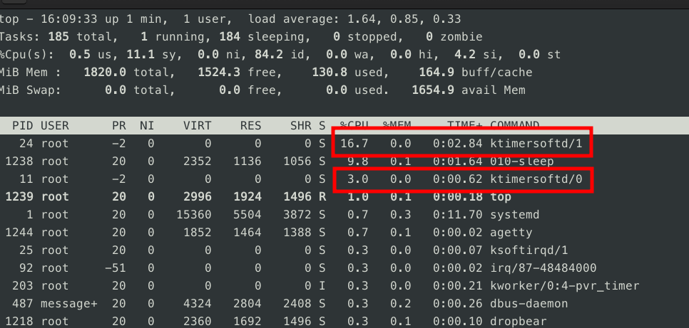

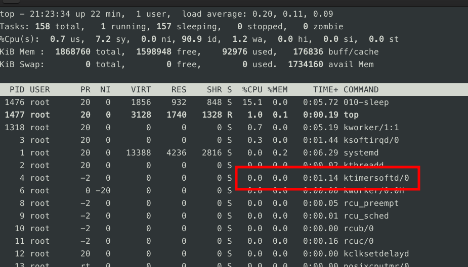

    I have found another performance problem regarding SDK6. (I am still using BeagleBoard-X15.) Assume that we have an application or script having the same effect:
    #include <stdio.h>
    int main()
      for (int i = 0; i < 60000000; ++i) {
        usleep(1);
      return 0;
    Unfortunately, this application has a different performance between SDK3 and SDK6.
    SDK3:
    SDK6:
    The application utilizes CPU for kernel threads in a different way in different SDKs. If we have a separate application besides this application, there will be a performance decrease.
    I appreciate it if you could help me regarding the issue.
