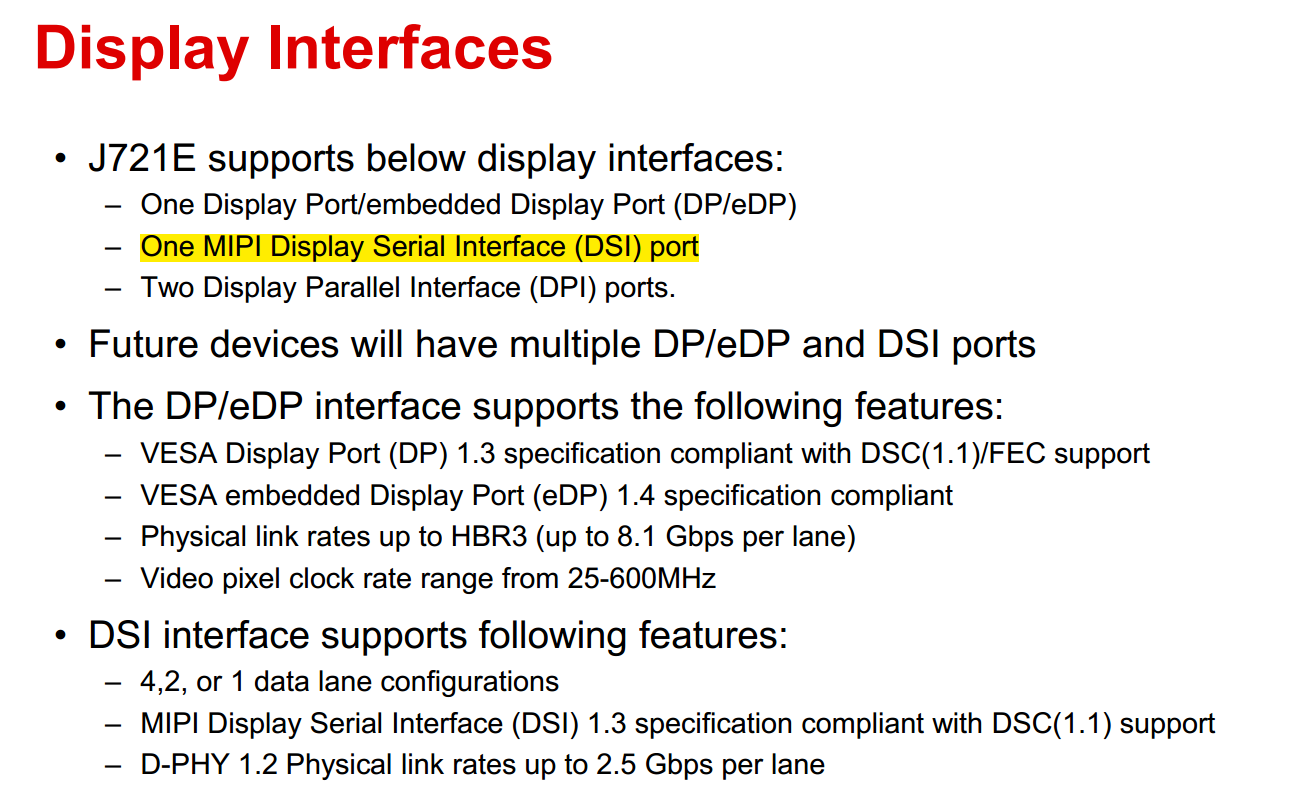

now i want output an image to PFD display by DSI interface. The video Path as following:
VID1 -> OVLAY3 -> VP3 -> DSI -> PFD Display
so i modify the cockpit_demos code:

then use dma API to graphy an image to VID1 like graphy telltale.
but nothing show on the FPD screen.
i have check the ds90ub941 and ds90ub924 can work in color bar mode.
could anyone help me figure out the problem?
