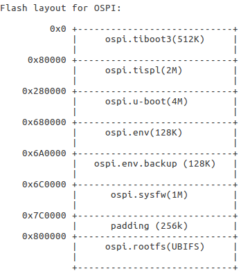

I am trying to change the offset address of the OSPI flash and i am not sure how to achieve. I tried few things and didn't get any expected results.
Things I have tried :- (In u-boot level)
The snapshot below is the default partition for the OSPI.
1. I tried to change the CONFIG_MTDPARTS_DEFAULT variable in u-boot and it didn't make any change.

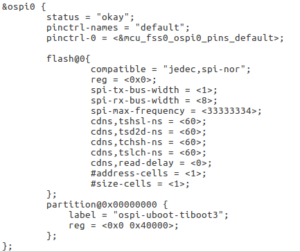

2. I tried to change the dtsi files present in the u-boot by adding the partition related information and still i did not find any difference.

Can you suggest , what is the right approach to solve this ?
  • What exactly are you trying to relocate and where?
    As for the U-Boot and related boot artifacts their location is dictated by ROM (in case of tiboot3.bin). Others (tispl.bin, u-boot.img, sysfw.itb) are hard-coded using CONFIG variables in U-Boot and/or U-Boot header files.
    Regards, Andreas
  • As you can see for the tiboot3.bin, the memory allocated is 512Kb but the actual size is around 120Kb-130Kb.
    So i am trying to optimize the flash memory by placing all the binaries in different location.
    There is one place where these configurations present ( include/environment/ti/am65x_dfu.h ).
    Is it the only change that required or any other places i need to configure ?
    Can you help me where i can find these config files ?
  • Hi Venkatesh,
    the offsets for A53 U-Boot SPL and A53 U-Boot proper are defined in the below files as follows:
    include/configs/am65x_evm.h:#define CONFIG_SYS_SPI_U_BOOT_OFFS 0x280000
    include/configs/am65x_evm.h:#define CONFIG_SYS_SPI_U_BOOT_OFFS 0x80000
    The offset for system firmware is actually a Kconfig option that you can configure via 'make menuconfig'. It is defined here (including its default):
    arch/arm/mach-k3/Kconfig:config K3_SYSFW_IMAGE_SPI_OFFS
    Regards, Andreas
