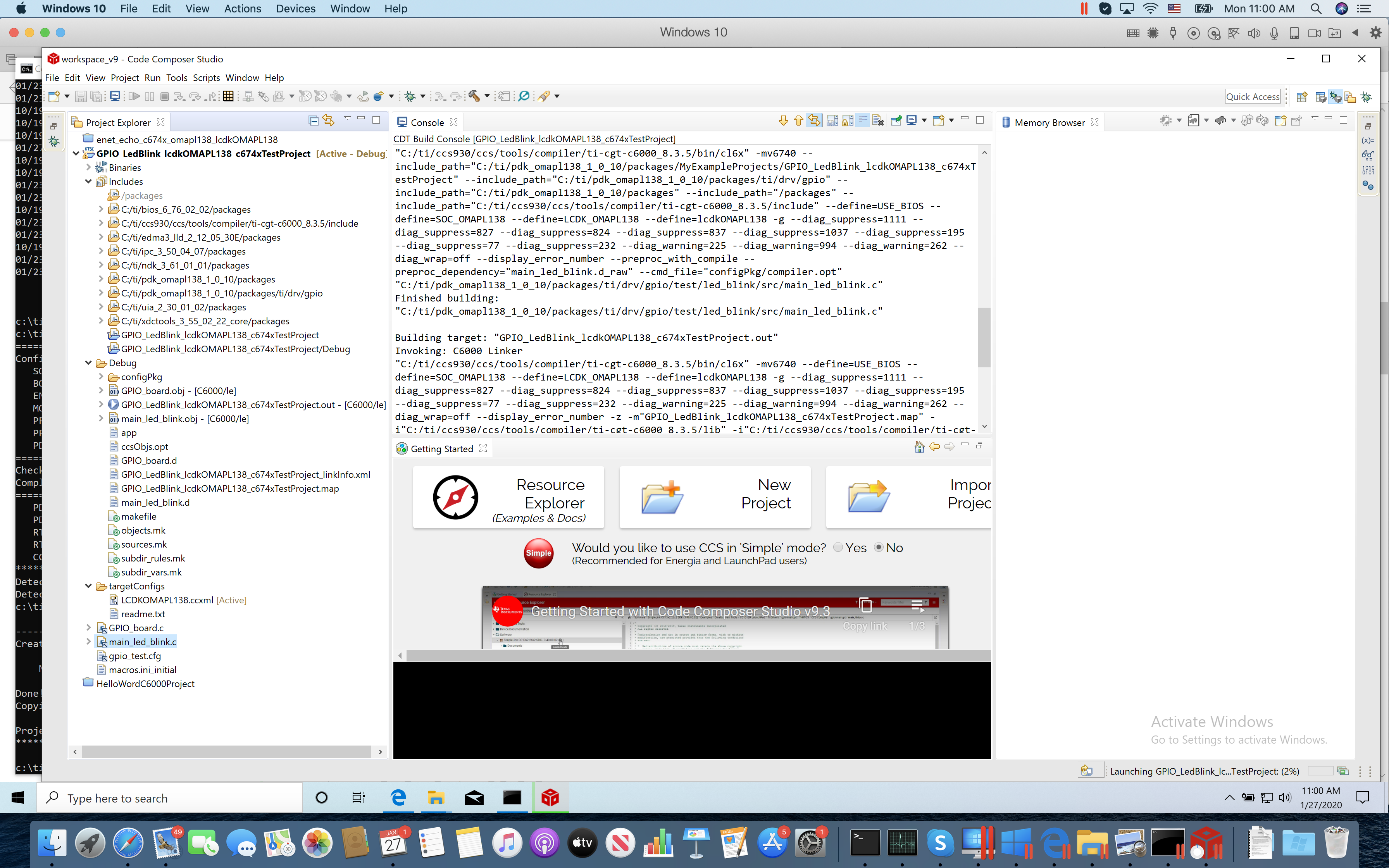

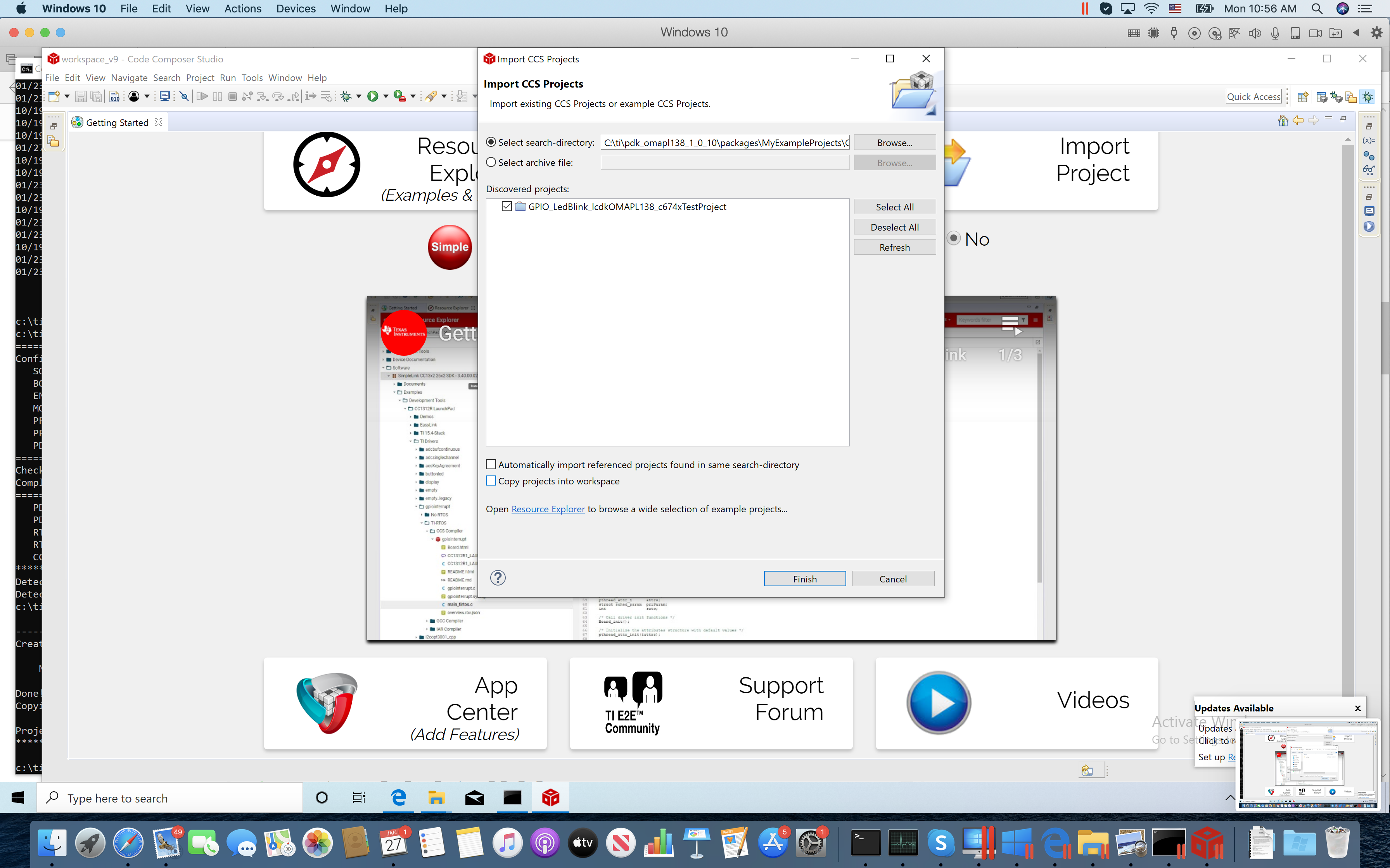

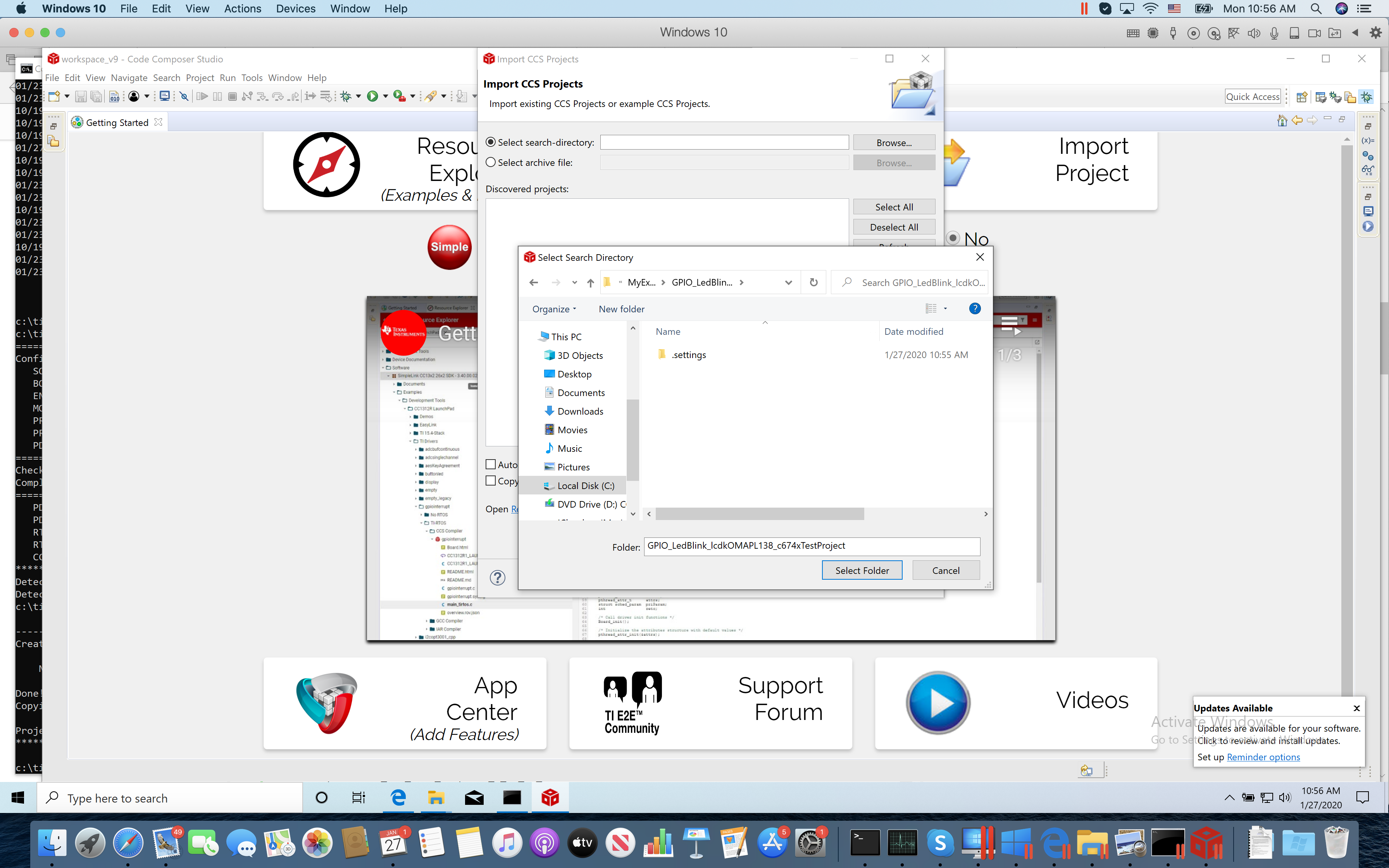

  • Hi Sahin, I have started trying to build the GPIO project on CCS.9.3.0.
    I am attaching screenshots of my steps.
    Import the project

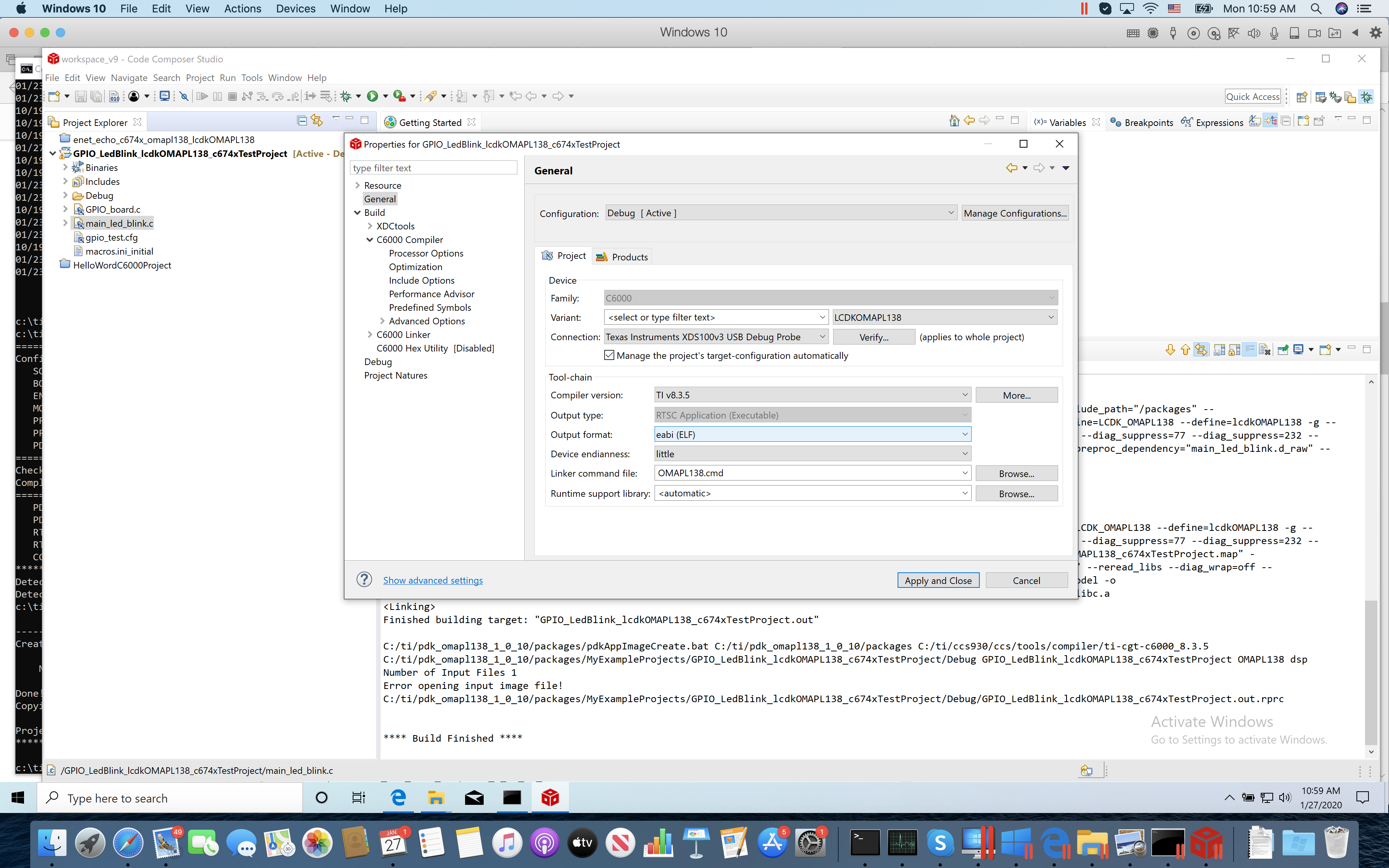

    I built the project without editing the Properties of the project.
    I got the following error as the target was not selected.

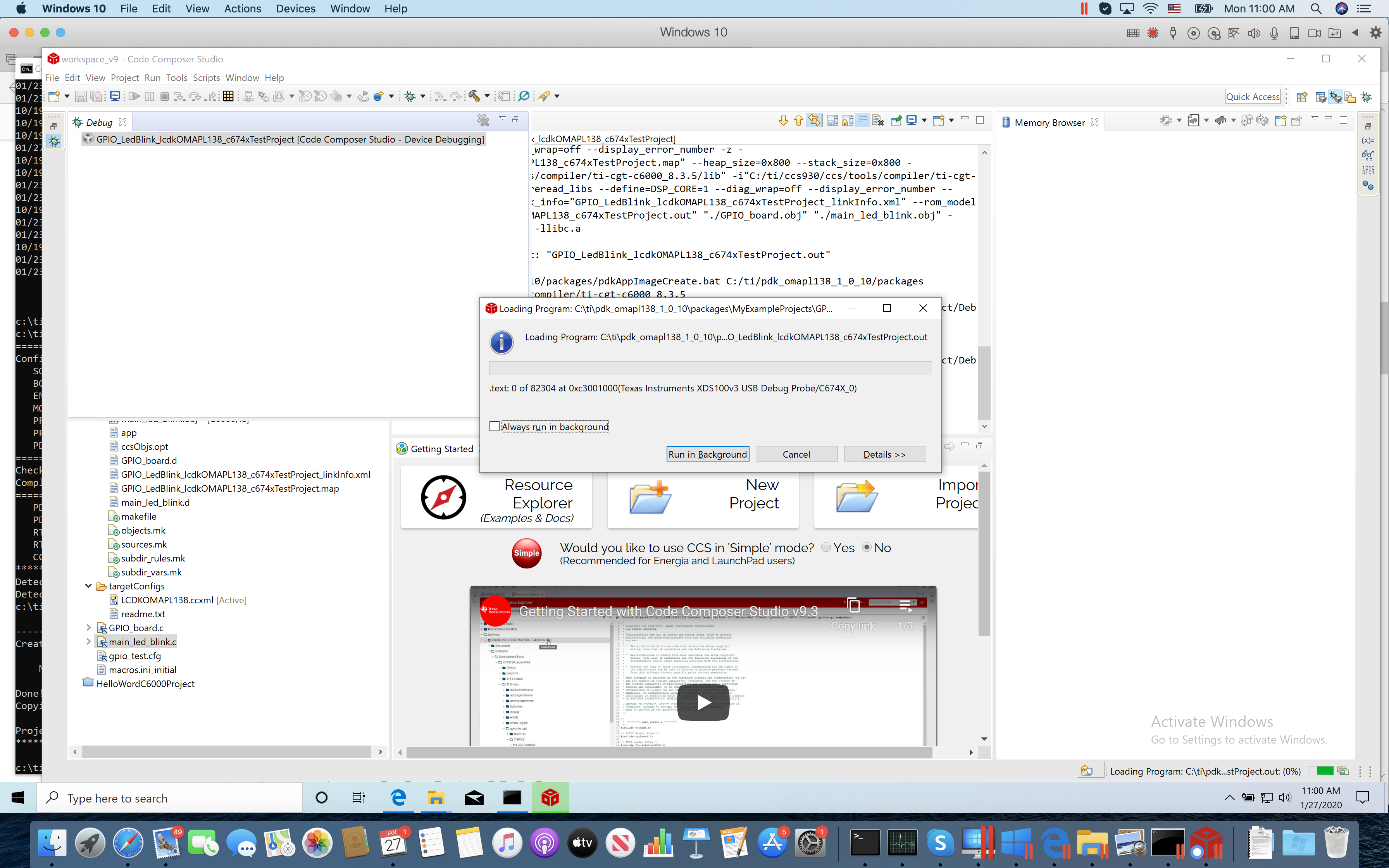

    So, I edited the properties of the project to point to the target. But I left out the linker command file
    I verified that the target was connected to the project.
    I rebuilt the project and selected debug to run the project on the target.
    However, I got the following error:
    Then, I tried after adding the OMAPL138.cmd to the project, but there was a clash between the existing linker.cmd file in the project and the OMAPL138.cmd file as shown below. I tried #if 0 the definition in OMALL138.cmd and I get the original error (when I did not add the OMAPL138.cmd to the project)
    Can you please help?
    Thanks!
  • Okay, I was able to figure out how to turn off the errors. I went to Debug configurations and unchecked PRU_0, PRU_1, and ARM_9
    Now, I am trying to figure out how to unset the build option --USE-BIOS. I tried editing the make file, but it warned me that it was generated from somewhere else. Where can I unset this option?
    Thanks!
  • Okay, looks it is set in the pdkProjectCreate.bat. So, I think it's okay for me to edit the make file option.
    %CCS_INSTALL_PATH%\%AUTO_CREATE_COMMAND% -data %MY_WORKSPACE% -application com.ti.ccstudio.apps.projectCreate -ccs.name %%~nI -ccs.outputFormat %OUTPUT_FORMAT% -ccs.setCompilerOptions "-DUSE_BIOS" -ccs.device %CCS_DEVICE% -ccs.endianness %ENDIAN% -ccs.kind executable -ccs.cgtVersion %CGT_VERSION% -rtsc.xdcVersion %XDC_VERSION% -rtsc.enableDspBios -rtsc.biosVersion %BIOS_VERSION% -rtsc.buildProfile "debug" -rtsc.products "%RTSC_PRODUCTS%" -rtsc.platform "%RTSC_PLATFORM_NAME%" -rtsc.target %RTSC_TARGET% -ccs.rts libc.a -ccs.args %%~nI%%~xI %SIMULATOR_SUPPORT_DEFINE% -ccs.overwrite full -ccs.setPostBuildStep "${TI_PDK_INSTALL_DIR}/packages/pdkAppImageCreate.bat ${TI_PDK_INSTALL_DIR}/packages ${CG_TOOL_ROOT} ${PROJECT_LOC}/${ConfigName} ${ProjName} %SOC% %PROCESSOR%"
  • I cannot turn the USE_BIOS definition off. Can you please tell me where I can do this.
    I created a new project by editing the pdkProjectCreate.bat file. However, this option keeps showing up as one of the options for the compiler.
    Thanks!

    As you already figured out, you need to create a target configuration to load and run the code as described here: http://software-dl.ti.com/processor-sdk-rtos/esd/docs/latest/rtos/index_how_to_guides.html#connecting-the-lcdk-to-code-composer-studio
    1. The USE_BIOS compiler option can be removed by going to the project's Build Settings > Build > C6000 Compiler > Predefined Symbols and removing it from the list.
    2. The macros.ini file is used to set the paths for various components in the SDK. It is concerning that the script was unable to locate it. Please make sure you have set the SDK install path and setup the environment as described here: http://software-dl.ti.com/processor-sdk-rtos/esd/docs/latest/rtos/index_examples_demos.html#using-ccs-projects
