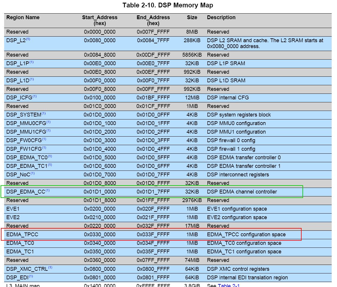

    At the first glance it seems this example is using the DSP_EDMA:
       line 76 main.c:
       #if defined (SOC_AM574x) || defined (SOC_AM572x) || defined (SOC_AM571x)
       #define EDMA_U_BASE CSL_DSP_EDMA_CC_REGS
       #else
    but when you dig deeper, it turns out that CSL_DSP_EDMA_CC_REGS is not the address of the DSP_EDMA (even it sounds like this) but of the system EDMA.
    CSL_DSP_EDMA_CC_REGS is defined at cslr_soc_dsp_baseaddress.h line 297 as
    #define CSL_DSP_EDMA_CC_REGS                                                    (0x3300000U)
    When looking at the TRM of the AM572X it becomes visible this is the system EDMA (red mark), because the DSP_EDMA is mapped at 0x01D10000 (green mark).
    However, as described above when I start the original demo its work when running stand alone.
    But when started via remote_proc with Linux running on the A15 core it does not work.
    The reason is, that Linux itself used the system EDMA too and kills the EDMA configuration done by the DSP (due to EDMA resource conflict).
    I worked actually around this by changing the DSP event queue to 1, because Linux seems actually to use queue 0 only.
    But this is not a real solution and not safe.
    The real solution would be that the DSP uses the DSP_EDMA and Linux the system EDMA as described at my first post.
    But when changing the EDMA instance address from
    #define EDMA_U_BASE CSL_DSP_EDMA_CC_REGS      /* 0x3300000U */
    to
    #define EDMA_U_BASE CSL_DSP_DSP_EDMA_CC_REGS  /* 0x1d10000U */
    things do not work any longer.
    So still I have my question:
    What has to be considered when using DSP1 EDMA instead of system EDMA?
    I read the TRM carefully but find not the reason for this malfunction.
    Regards    Dirk

  • Hello Frank,
    First I run the simple memory-to-memory DMA copy demo on the system EDMA (CSL_DSP_EDMA_CC_REGS = 0x3300000U) and the result was as expected.
    Second I want to use the DSP1_EDMA instead of the system EDMA and changed the EDMA base address to CSL_DSP_DSP_EDMA_CC_REGS = 0x1d10000U.
    Now the program is simply crashing with mmu fault:
    [  229.768029] remoteproc remoteproc3: remote processor 40800000.dsp is now up
    [  229.880772] omap-iommu 40d02000.mmu: iommu fault: da 0x4082a300 flags 0x0
    [  229.887595] remoteproc remoteproc3: crash detected in 40800000.dsp: type mmufault
    [  229.895120] omap-iommu 40d02000.mmu: 40d02000.mmu: errs:0x00000002 da:0x4082a300 pgd:0xedb71020 *pgd:px00000000
    [  229.905294] remoteproc remoteproc3: handling crash #30 in 40800000.dsp
    In consequence to your posts I did more analysis.
    The answer to my question (What has to be considered when using DSP1 EDMA instead of system EDMA?) is at the end simple.
    When changing from system EDMA to DSP1_EDMA you need not only to change the base address of the EDMA controller.
    Furthermore - and that was my missing link I was asking for - you need also to change the the given address of the source and destination buffer, even they are still on the same location and address!
    Lets say it in simple words.
    When you use the system EDMA (even from DSP1) source and destination buffer must be given in "system view" address.
    When you switch over to DSP1_EDMA both buffers must be given in "local view" address.
    So an offset of 0x40000000 makes the difference.
    And it is working...
    Thank you.
    Regards Dirk
