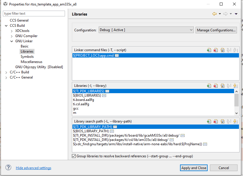

I'm not sure why it is producing this error, because the it should be linked using the base starting address of 0x0801_0010 and any addresses that are relative in the code should be with that as a base.
The demo application I'm trying to compile for XIP is the one found in the {install_path}/processor_sdk_rtos_am335x_6_01_00_08/demos/rtos_template_app which was copied to my workspace.

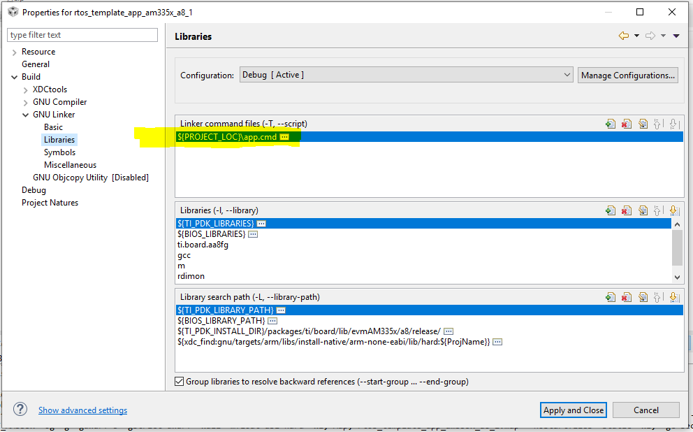

The linker file for the board is {Wspace}/rtos_template_app_am335x_a8/Debug/configPkg/linker.cmd
Depending on the selection of the board, I'll get one of the these two linker files.
If icev2AM335x is selected the attached linker file (linker.cmd) would be used to link the code for the DDR.
If icev2XIPAM335x is seleced the attached linker file (linker-XIP.cmd - renamed for clarity) would be used to link the code for the NOR.
These look correct for each type of application being built.
What is not happening correctly to get the XIP application to link?

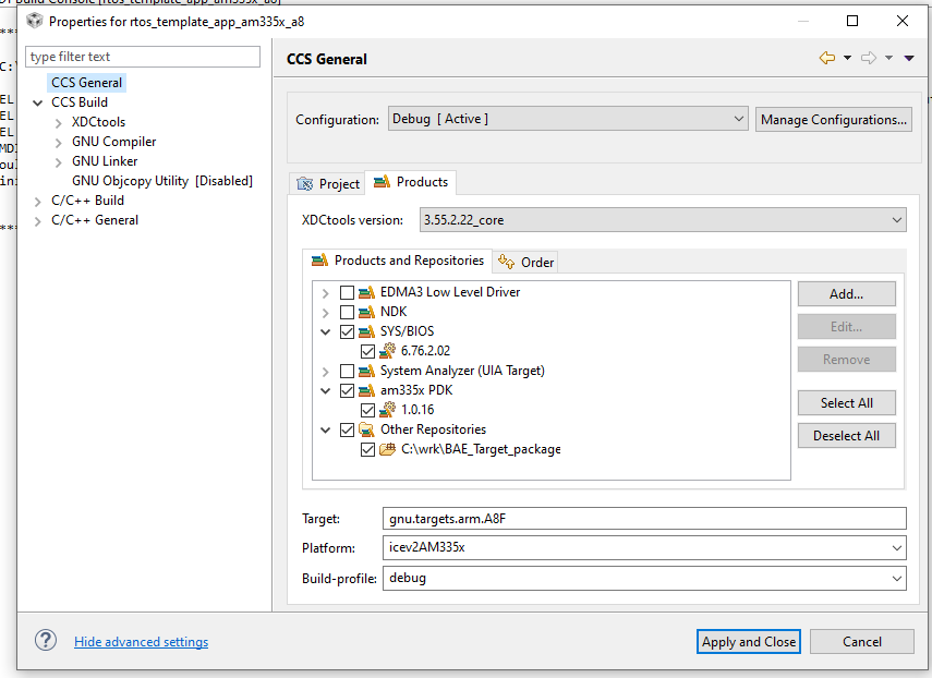

    I surmise you've created the two custom platforms icev2AM335x and icev2XIPAM335x. Although the contents of the files you've shared would be useful in diagnosing the build problem, it would probably be more useful for you to share your custom platform folder / files.
    Why do you need a separate platform definition for the XIP case, and what is the difference between icev2AM335x  & icev2XIPAM335x? Is it the memory map and where certain code/data is linked?

    The reason that I wanted two config files is to be able to compile to put the application into the ram vs putting the application into the NOR Flash.

    I added a user-level linker command file to the CCS project which links .ARM.extab and .ARM.exidx to REGION_TEXT (alias for NOR_FLASH memory region). The code links for the icev2XIPAM335x platform with this change.
    This is the linker command file: https://e2e.ti.com/cfs-file/__key/communityserver-discussions-components-files/791/app.cmd
    I added the linker command file to the CCS project under:
    Build->GNU Linker
    Libraries
    Linker command files (-T, --script)
    Frank
  • Hello Frank,
    Thank you for the response. However, I'm still not quite there. I did manage to finally get it to link (with warnings) - so I'll include what I've done so perhaps you can direct me further.
    I downloaded the file and stuck it in with the other sources. This is how I have the linker configured in the build settings.
    I did a "clean" and then a build. This is the failure I'm now getting.
    Invoking: GNU Linker
    "C:/Tools/ti/ccsv8/tools/compiler/gcc-arm-none-eabi-7-2017-q4-major-win32/bin/arm-none-eabi-gcc.exe" -mtune=cortex-a8 -marm -fno-exceptions -Dam3358 -DgcaAM335x -DSOC_AM335x -Og -g -gdwarf-3 -gstrict-dwarf -Wall -mfloat-abi=hard -Wl,-Map,"rtos_template_app_am335x_a8.map" -nostartfiles -static -Wl,--gc-sections -L"C:/Tools/ti/pdk_am335x_1_0_16/packages/ti/board/lib/gcaAM335x/a8/debug/" -L"C:/Tools/ti/pdk_am335x_1_0_16/packages/ti/csl/lib/am335x/a8/debug/" -L"C:/Tools/ti/bios_6_76_02_02/packages/gnu/targets/arm/libs/install-native/arm-none-eabi/lib/hard" -Wl,--defsym,STACKSIZE=0x1C000 -Wl,--defsym,HEAPSIZE=0x400 --specs=nano.specs -o"rtos_template_app_am335x_a8.out" "./app.o" "./main.o" -Wl,-T"../app.cmd" -Wl,-T"configPkg/linker.cmd" -Wl,--start-group -Wl,-T"C:/wrk/BAE-BL/rtos_template_app_am335x_a8/app.cmd" -l:ti.board.aa8fg -l:ti.csl.aa8fg -lgcc -lm -lrdimon -lc -Wl,--end-group
    makefile:150: recipe for target 'rtos_template_app_am335x_a8.out' failed
    c:/tools/ti/ccsv8/tools/compiler/gcc-arm-none-eabi-7-2017-q4-major-win32/bin/../lib/gcc/arm-none-eabi/7.2.1/../../../../arm-none-eabi/bin/ld.exe:../app.cmd:7: warning: memory region `REGION_TEXT' not declared
    c:/tools/ti/ccsv8/tools/compiler/gcc-arm-none-eabi-7-2017-q4-major-win32/bin/../lib/gcc/arm-none-eabi/7.2.1/../../../../arm-none-eabi/bin/ld.exe:configPkg/linker.cmd:39: error: redefinition of memory region alias `REGION_TEXT'
    collect2.exe: error: ld returned 1 exit status
    gmake[1]: *** [rtos_template_app_am335x_a8.out] Error 1
    gmake: *** [all] Error 2
    makefile:146: recipe for target 'all' failed
    I see that the file is included and it link command has the correct path to the file.
    From the file Debug/linker.cmd file
    REGION_ALIAS("REGION_BSS", DDR);
    REGION_ALIAS("REGION_TEXT", NORFLASH);
    REGION_ALIAS("REGION_DATA", DDR);
    REGION_ALIAS("REGION_STACK", DDR);
    REGION_ALIAS("REGION_HEAP", DDR);
    REGION_ALIAS("REGION_ARM_EXTAB", DDR);
    REGION_ALIAS("REGION_ARM_EXIDX", DDR);
    So I'm puzzled by the error message as we  are not redefining the REGION_TEXT section, just adding to it.
    Do I use this script instead of the one generated (linker.cmd) or in addition to the one generated? It looks like it would be in addition to , based on it's contents.
    I tried just using NORFLASH in app.cmd for the region, with success. - ie. it linked, with the the following warning message.
    c:/tools/ti/ccsv8/tools/compiler/gcc-arm-none-eabi-7-2017-q4-major-win32/bin/../lib/gcc/arm-none-eabi/7.2.1/../../../../arm-none-eabi/bin/ld.exe:../app.cmd:10: warning: memory region `NORFLASH' not declared
    c:/tools/ti/ccsv8/tools/compiler/gcc-arm-none-eabi-7-2017-q4-major-win32/bin/../lib/gcc/arm-none-eabi/7.2.1/../../../../arm-none-eabi/bin/ld.exe:configPkg/linker.cmd:31: warning: redeclaration of memory region `NORFLASH'
    Finished building target: "rtos_template_app_am335x_a8.out"
    I examined the map and it did put main where I directed the generation.
    From .map file
     .text          0x08010540       0xa8 ./main.o
    Not sure why I'm unable to use your script unchanged? Any ideas?
    Thanks! Any further info that would help get rid of the warnings would be most helpful.

  • Hi Alan,
    I don't see any warnings or errors when I build. If app.cmd is included in your project directory, did you exclude it from the build?
    Frank
