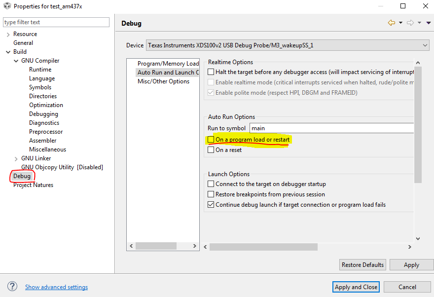

  • Hi Ming,
    Thanks for this information. it works for me in debug window.
    But, I'm curious why it is not worked when I unchecked it in the Project Properties as below.
    Thanks and Best Regards,
    SI.
