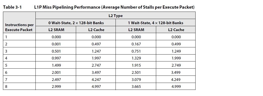

  • Hi, Roman,
    I just want to update you with our investigation. There are 2 tables, 2-13 and 3-17, in C66x CorePac User's Guide are marked as TBD.
    Table 2-13 L1P Miss Pipelining Performance (Average Number of Stalls per Execute Packet) (TBD) - On this table, we don't have that particular "3 wait states, 8x128-bit banks" configuration numbers. However, in the “DSP Cache User Guide http://www.ti.com/lit/ug/sprugy8/sprugy8.pdf “, we have this table:
    We'll update the C66x CorePac Table 2-13 with this table and use these values instead. Also, since C66 has SPLOOPs, so for most loops, the instructions are prefetched into the SPLOOP buffers, hence  the L1P miss should even be more minimized during software pipeline codes.
