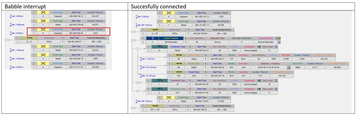

We have a custom board with a AM3352 processor running Linux. The USB1 bus is configured as host and is used to connect to peripheral devices (mainly barcode readers). One barcode reader we use (Datalogic Heron HD3430, USB Full-Speed) somehow seems to have an incompatibility with our board which sometimes causes USB 'babble' interrupts during connection of the reader. The babble interrupt causes the USB bus to reset (including VBUS reset) and re-initialize again.
The babble interrupt seems to be generated only during initialization of the barcode reader: when the barcode reader is successfully connected it remains functioning without generating babble interrupts any more. Furthermore, the babble interrupt does not always happen: sometimes the barcode reader is successfully connected without generating a single babble interrupt.
We have tested our board with several other USB Full-Speed peripherals (barcode readers and other USB devices) and we have not been able to reproduce this babble issue yet on any of them other than the HD3430.

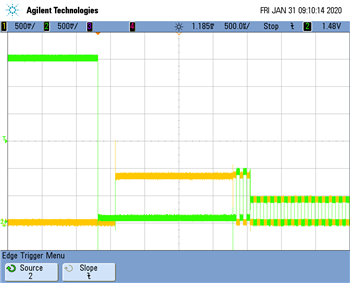

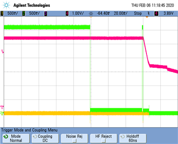

We have connected an Oscilloscope and captured USB1 D+, D- and VBUS during both the 'Babble interrupt' and during 'Successful connection' of the barcode reader (see comments for explanation):
In the 'babble' situation, it is observed that the host (AM3352) waits for ~3ms before sending the first SOF packet after the USB reset condition has been released. After ~4 SOF packets, the babble interrupt is generated (note that VBUS dips as a result of the babble interrupt and does not cause it).
In the 'normal'/'successfully connected' situation, the host starts with sending the first SOF packet within ~1ms. After ~98 SOF packets, an USB 'Get Descriptor' Transfer takes place to initialize the barcode reader. We have reproduced this many times: If the host waits with sending SOF packets after the USB reset condition is released, the babble interrupt will occur.
We also connected an USB protocol analyser in between the host and the barcode reader, which resulted in the same conclusion. When the host waits with sending SOF packets after the USB reset condition is released, the babble interrupt will occur (host sends reset condition):
Concluding, as an upcoming babble interrupt can be recognized by the host waiting with sending the first SOF packet, the root cause of the babble must be triggered before the first SOF is send by the host. Visualised:
Can anybody help me finding the root cause of the babble issue? More specific: how can the barcode reader (HD3430) influence the host (AM3352) in such a way that the host waits with sending SOF packages after the USB reset?

    I just removed the ESD diodes, removed and shorted the series common mode choke, increased the VBUS capacitance from ~100uF to ~150uF. No change in behaviour, the babble still occurs. Additionally, I removed and shorted a bead which is placed in series with VBUS supply and the VBUS connector pin. Again no change in behaviour.
    Jelmer Graat
  • Hi Jelmer,
    Met with a member of the PHY design team and he had a theory on what could cause this. He suggestion was that perhaps there is an impedance discontinuity in the USB path with this specific device that causes a signal reflection to be latched before we can turn off our receiver and complete the transition to output mode at the end of reset. The controller expects the bus to be idle prior to sending the first SOF so any activity (such as the aforementioned reflection) could possibly delay it. This latched reflection would also result in a babble condition.
    It would be interesting to insert a very long and very short USB cable in the path to see if the issue changes.
  • Hi DK,
    Thank you very much for your response, I think we are on the right track. Previous week, I have shared a report with our contact at TI with additional information (SI measurements, observations). In this report it is stated that the cable length indeed has an effect on the babble behaviour. When the cable is extended with a sufficient length, the babble behaviour disappears. I have done some additional tests:
    Cable length (cm) Babble observed?
    200 (original) Yes
    200 + 200 No
    10 Yes
    10 + 200 Yes
    10 + 200 + 80 Yes
    10 + 200 + 180 No
    10 + 200 + 80 + 180 No
    The results are is in line with your proposed theory of the impedance discontinuity in the USB path that causes a signal reflection before the receiver is turned off.
    - Would it be possible to fully verify this theory by somehow 'measuring' the signal reflection/receiver turn-off time margin?
    - Is there a solution available? Is the receiver turn-off time configurable or fixed?
